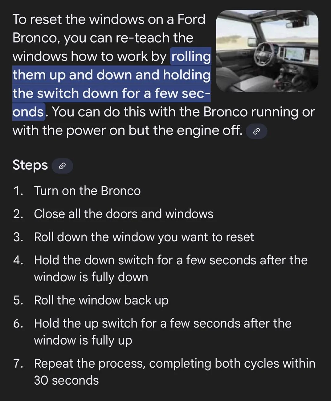

Did you try to do a window reset yourself? I just had the same issue with rear passenger window and the reset fixed it. It took about 6-8 tries but eventually worked.

I have to reset them from time to time. This always works. I’m almost 4 years in on owning mine, and this has happened maybe 3 times.
