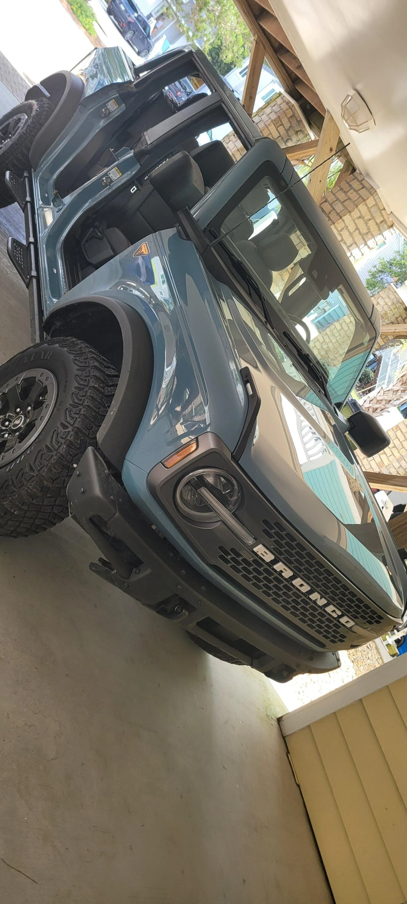

Thanks all for the advice. With the help of a friend I was finally able to get the driver side off. The mount points were rusted. The passenger side came off easily as designed.
