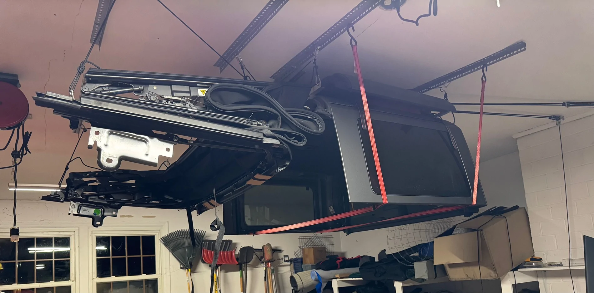

I made the mistake of clicking on an add for a hard top removal set up so now that's all I see on my phone. I was wondering if anyone with a soft top has figured out an easy way to remove and store a soft top?

I do. I got tired of trying to lift it. I have a hoister direct 7803.12 that I mounted in front of my hard top hoist so I can swap tops easily. I used lags into the rafters to mount the angle that it hangs off of.
Then some 1/4” carabiners attached to the rope to clip onto the frame of the top.
Ford Bronco Does anyone use a pulley system to remove their soft top? IMG_1545
Thanks!
