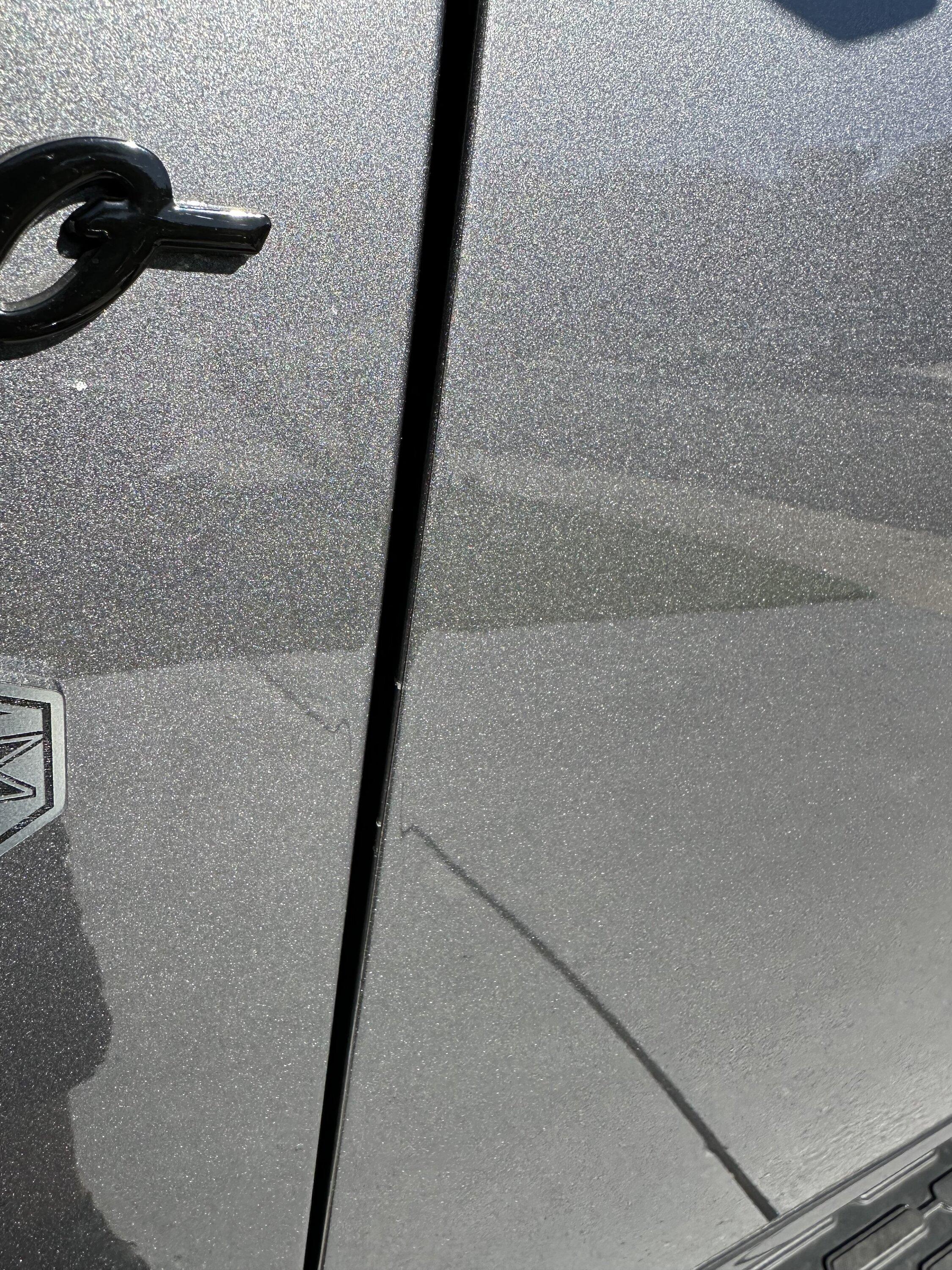

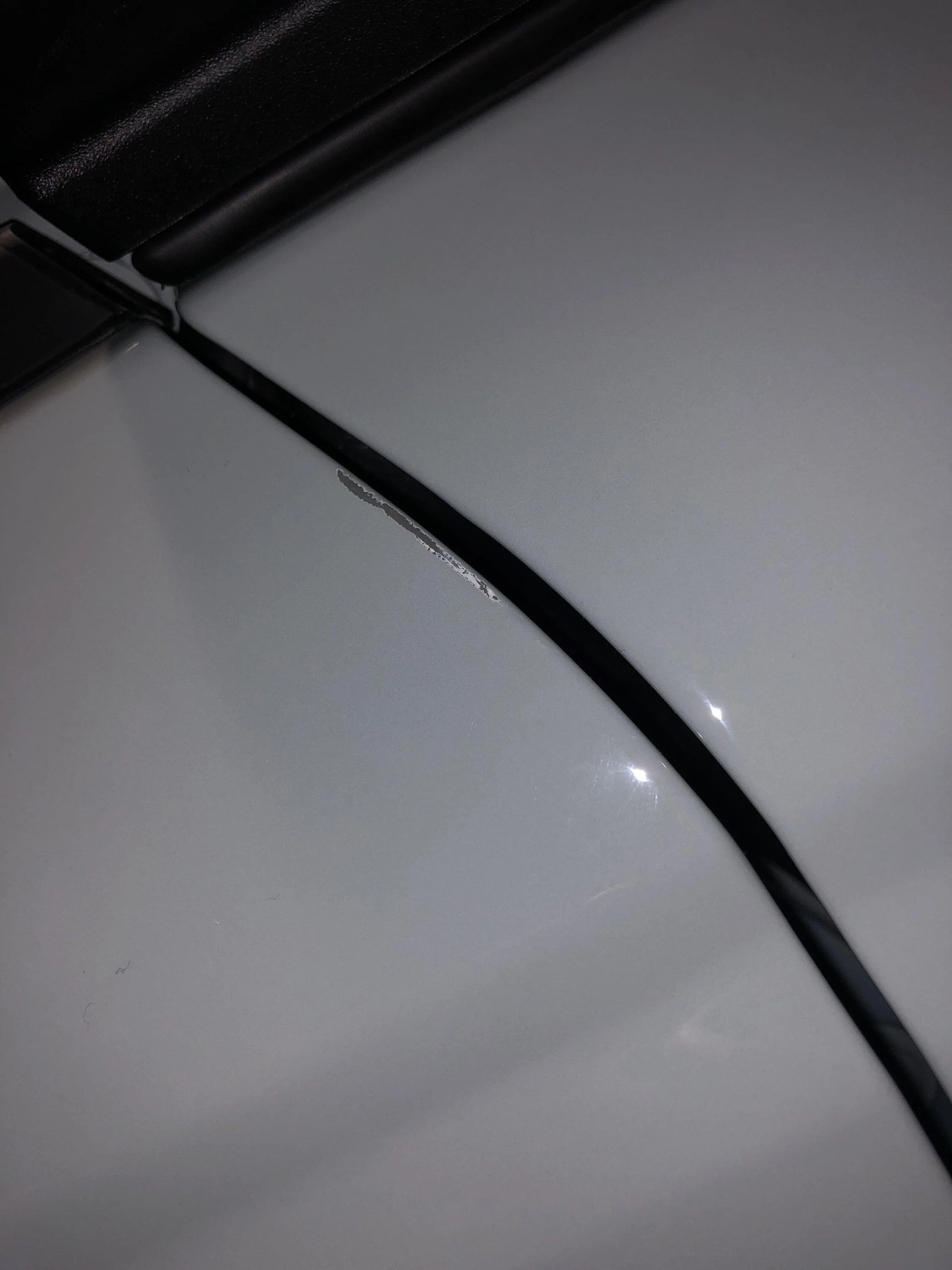

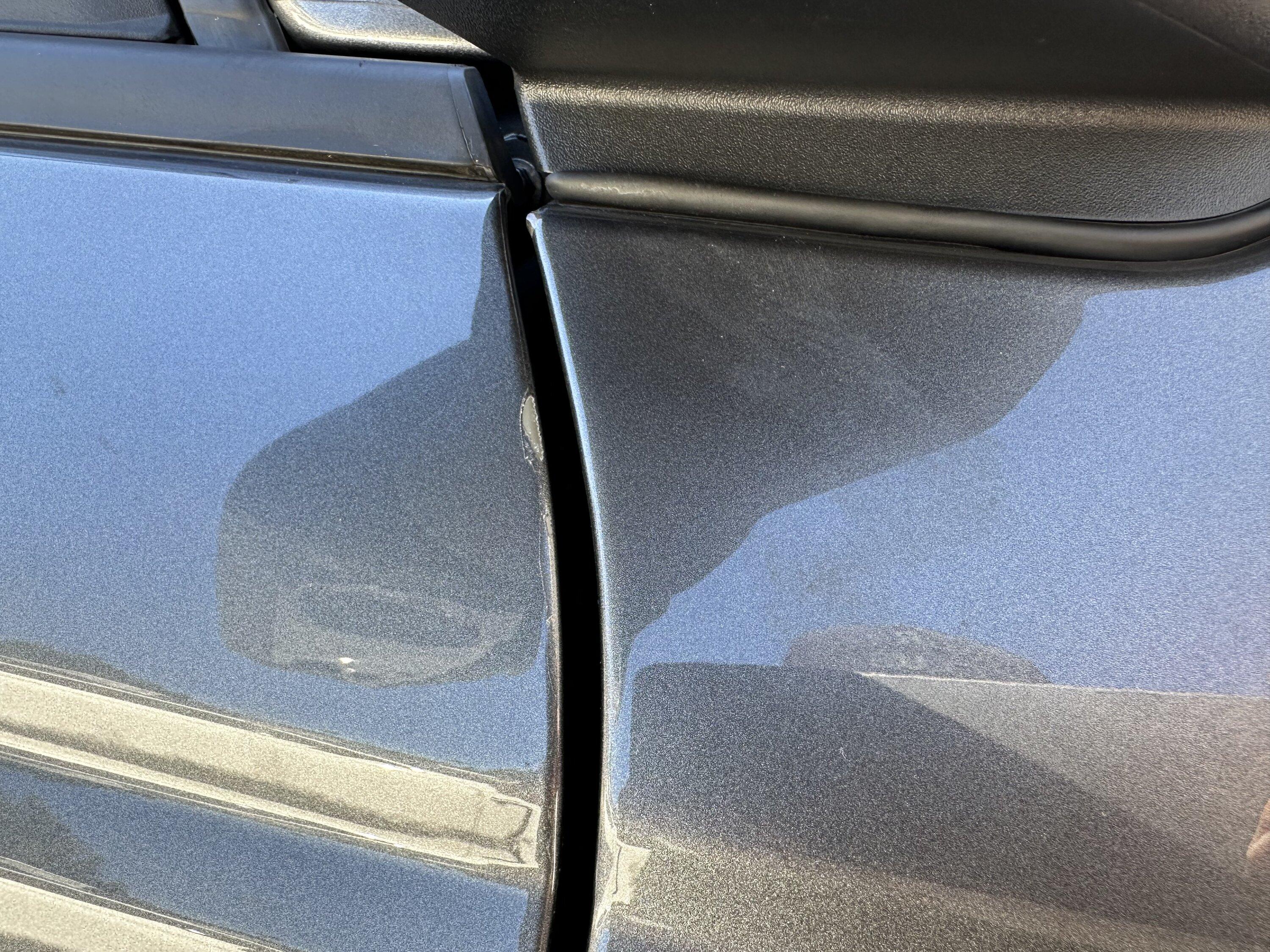

I am in the same boat.. Unfortunelty wasn't carful enough when taking off my doors off last weekend and scuffed both passenger and driver doors. Just picked up touch up paint from my local dealer and waiting for the clear coat to dry. hopefully it isn't that visible afterwards.
The is the same spot on my front passenger door. I also bought touch up paint (primer and clear coat too). Good luck.
