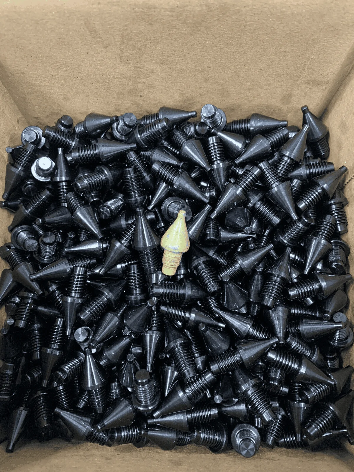

Thats a great idea! I just need 2 tho.. Being thats a more permanent design than the pins I dont see losing them being as common.
Edit: Searched and found them. 49.99 for the 2 vs 69.99 for 4.
Looking forward to read how the door install process is improved by using this product.
Last fall after installing my doors for the winter (and failing multiple times during the install) it dawned on me that the problem is that the guide pin is too short.
Single person install, I come in at a slight angle to get the lower hinge over the guide pin with little problem but then when I lift just a bit to get the upper hinge in place the lower hinge comes off the guide pin. I've read (and seen on most/all the install videos :) ) that others have this same problem.
After this last time installing doors I went out and bought an M8x1.25x45mm bolt (cost $2 for 2 bolts). Cut off the bolt head and was looking forward to testing in the spring. This product beat me to it.
