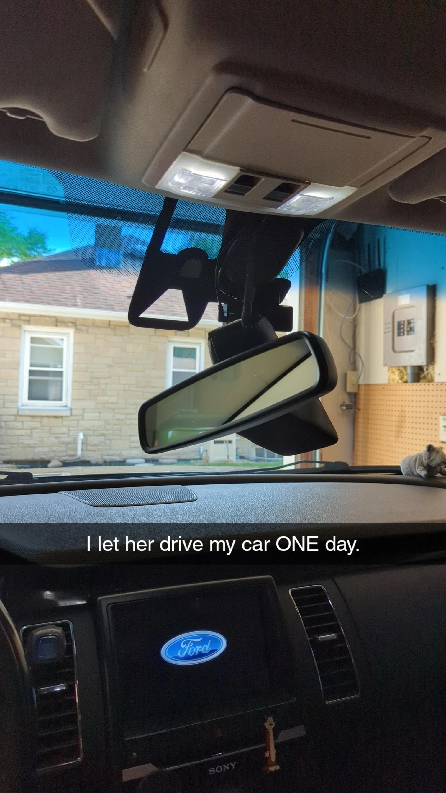

I had a dash cam mounted there for a couple days and it partially blocked the light sensor on the back of the mirror. I think it made the mirror go in and out of night mode along with dimming the displays. It was very distracting so I removed the dash cam.
Ah yeah, I forgot the mirror light sensor is back there. Good catch!
Weird, it shouldn't have affected the instrument cluster / SYNC; those are handled by the dashboard's sunload sensor.

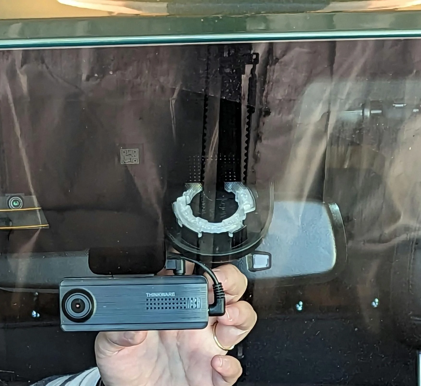

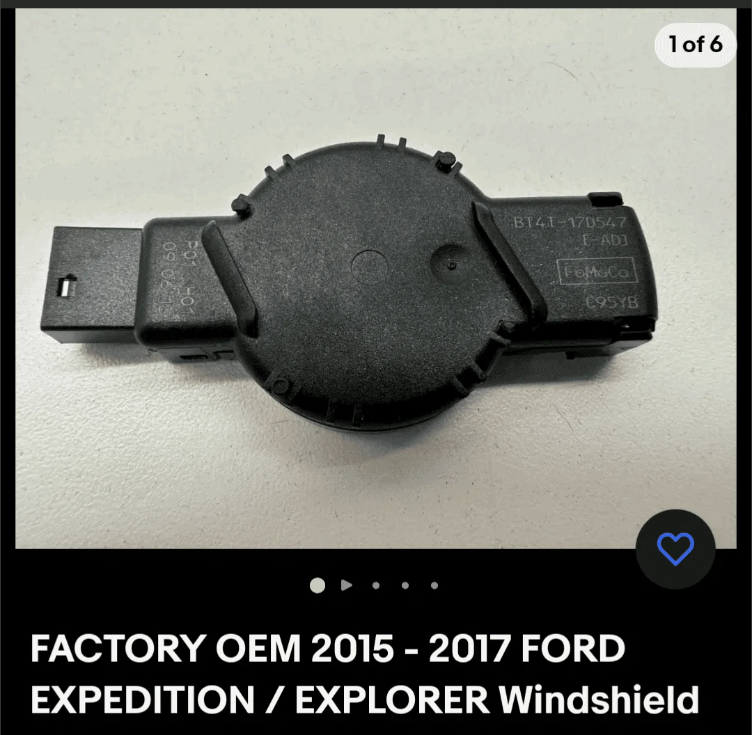

When my wife gets home, I'll check if the rain sensor sticks down too low in that position. Your dashcam may have sat lower or closer to the sensor, blocking more available light. It's a very basic light sensor so it should be pretty tolerant.
(Of course, the rain sensor is really just a light sensor, too -- shines a light and watches for slight changes from rain on the glass, affecting how much reflects back into the sensor)

Good news, I think we'll be ok. The rain sensor should be high enough to not obstruct the mirror
Ford Bronco [Done] Rain-Sensing Wipers Installed PXL_20231117_205140570.MP
I'll design a printable version of the cover, maybe a little smaller if this is sticking below the factory fritting. Some rain sensors had some extra bit that stuck out opposite the connector, both the mount and cover seem to have provisions for that which aren't needed in our application.

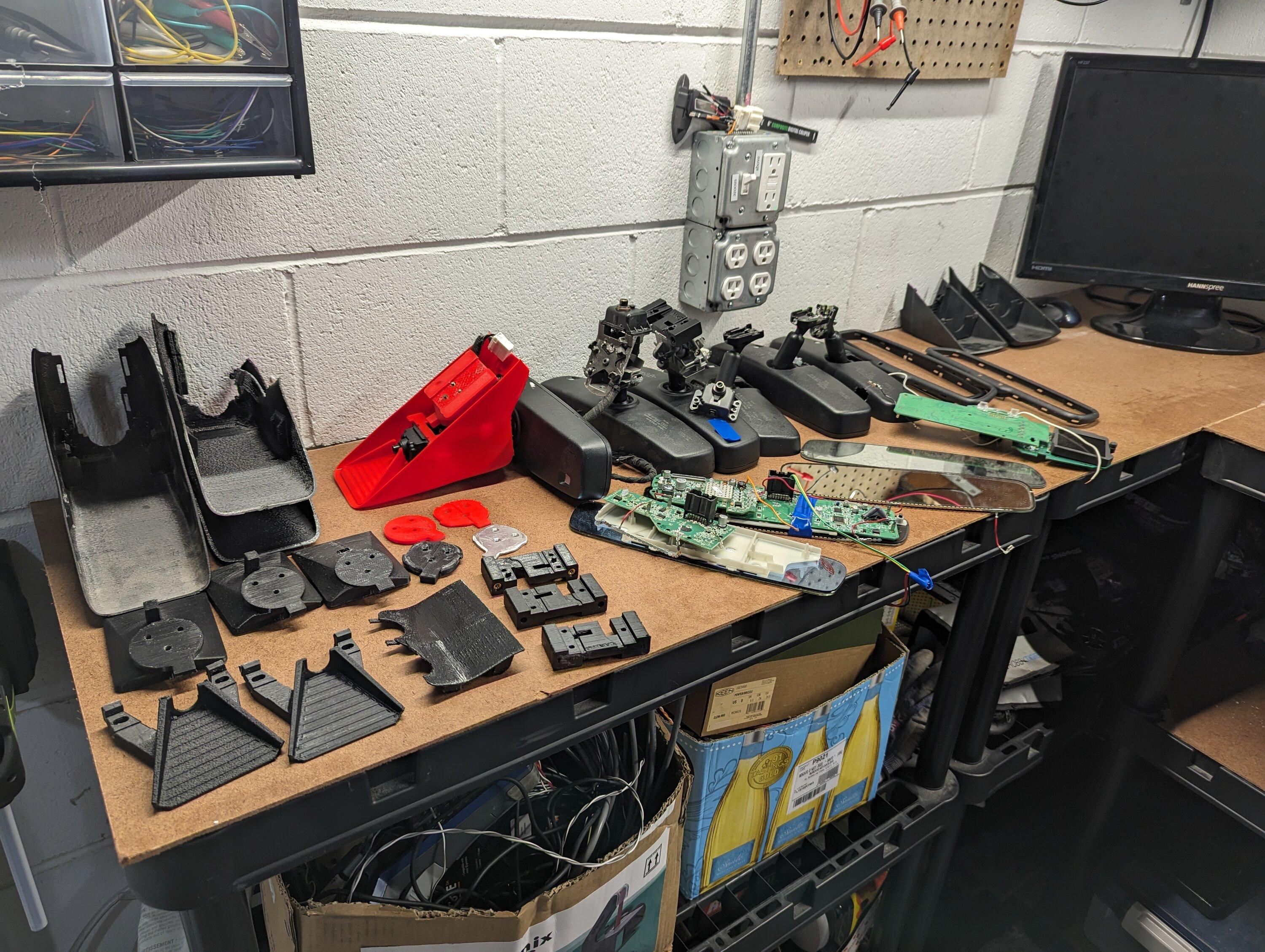

Made some mistakes in my design that didn't affect the end product at all but just bothered me, giving the whole works a test print tonight. New sensor arrived in the mail.
Hopefully printed parts will work, I didn't realize how much tension there is with that retainer trying to fold the mount like a taco. I don't want it to pull the vinyl right off the glass.
