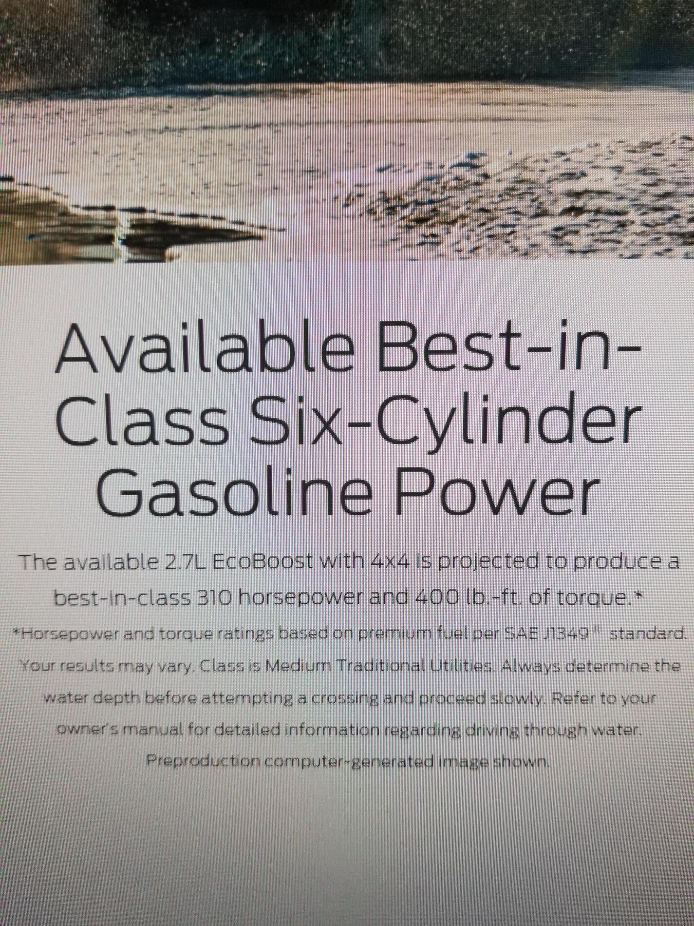

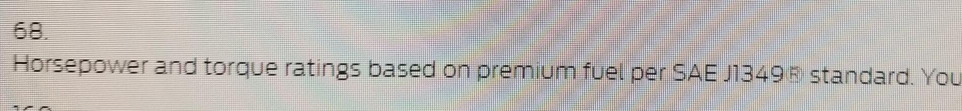

If the horse power and torque ratings do not include the caveat "With 91+ octane" you should be good on 89.
They do. All are rated with the best fuel. It’s even that way on our NA 2.0 in our ecosport which is far from a sports car. There is a general statement that maximum power ratings are based on premium fuel.

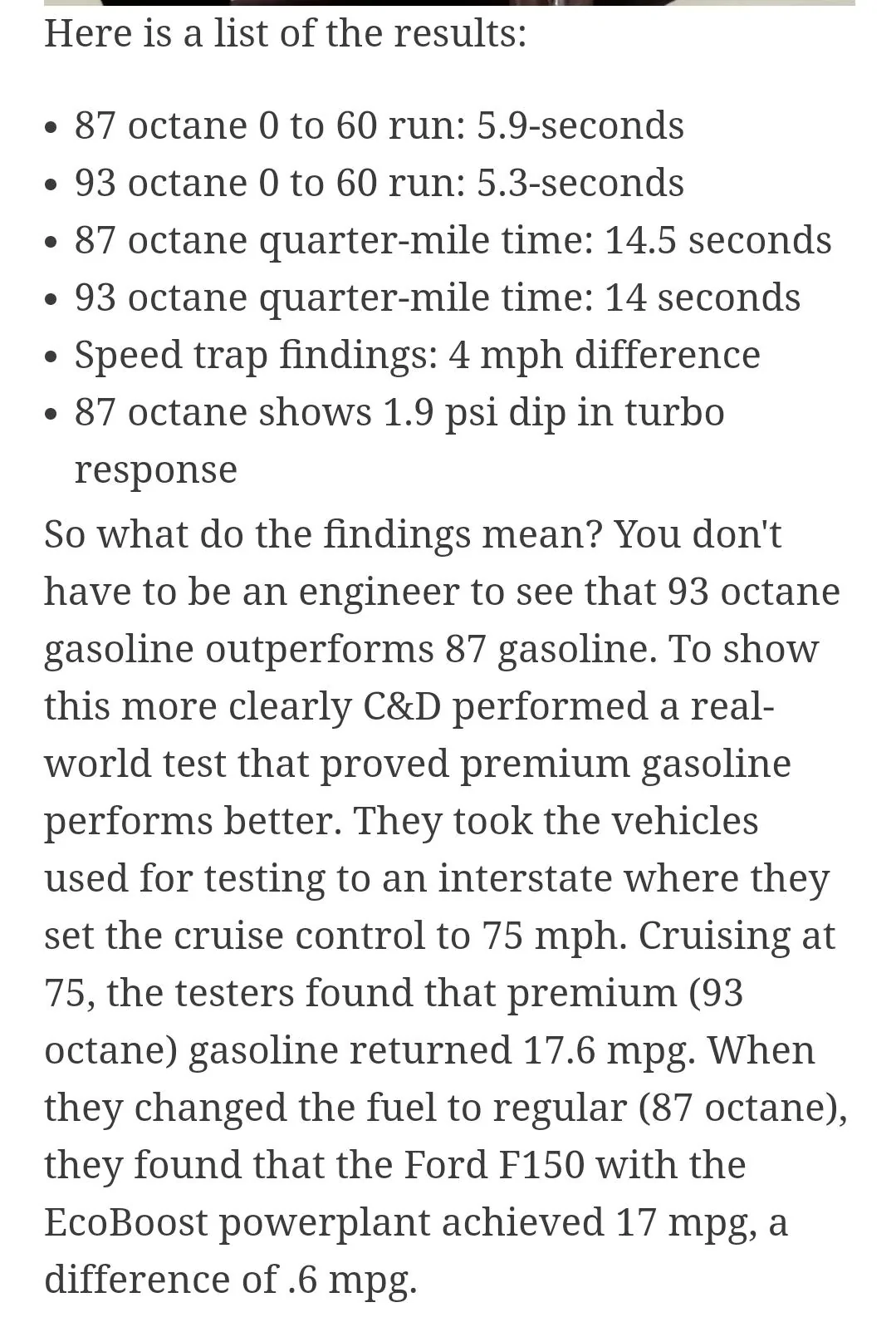

This is from Car and Driver, there seems to be enough evidence to suggest there's a clear difference in performance when going from regular to premium in the EcoBoost platform. All the stated HP and torque #s from Ford are also while using premium fuel. So while it's not required, I'd suggest it for the small price difference. Maybe $300-400 a year at most.
Using the same vehicle, different fuels.
Ford Bronco Does the 2.7L Ecoboost require premium gas? Screenshot_20201210-233839_Chrom

Wonder what the difference would be with real gas, not ethanol...

The thing with the Ecoboost engines is, they're adaptive as to what fuel you use. If you run premium, the engine will tube itself for a little more power....
And guaranteed, the power figures Ford has published for the Bronco were achieved on premium fuel!
With turbo motors, you can make TONS of power on ethanol. E85 if I remember correctly, is like 120 octane...?
A factory Ecoboost motor wouldn't take advantage of that... I'm talking aftermarket tuners.
Dunno if anyone still uses that fuel.its not widely available in Canada.
Problem with ethanol is, you gotta pump a 1/3 more of it thru the motor to make "equivalent" gasoline power... It just doesn't have the energy content that gasoline does.
