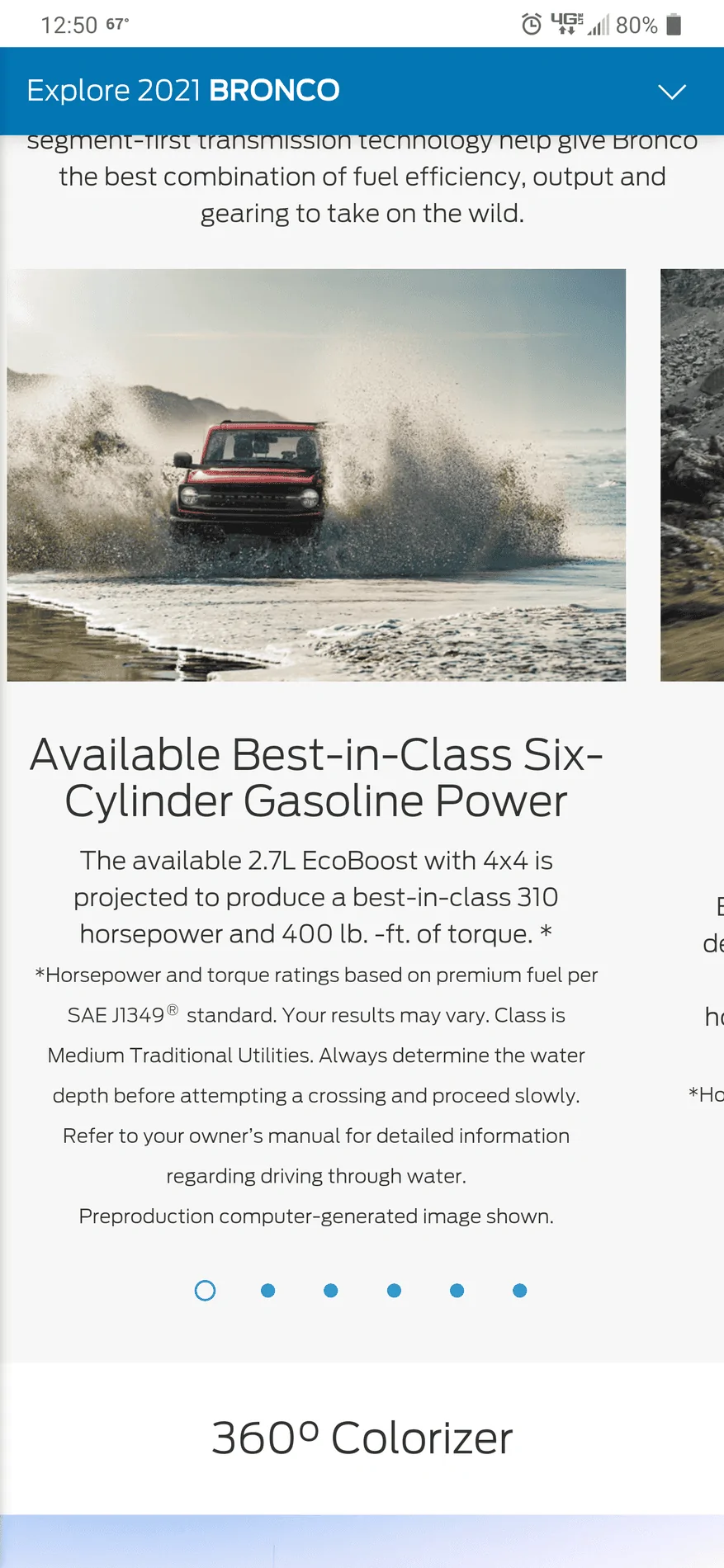

Yes, unquestionably.
https://cdn.dealereprocess.org/cdn/brochures/lincoln/2018-mkx.pdf
Go to the bottom of page 4 and look at that tiny text at the bottom of the page:
Ford's spark management is very sophisticated and constantly monitors for the indicators of knock on a per-cylinder basis, then advances or retards timing on individual cylinders to maximize power production. Running a lower octane fuel results in earlier knock, so power will be pulled. You are 100% fine and 100% safe running 87 octane, but you will not be making as much peak power/torque.
Ford site says the same when they quote HP and torque numbers.
Ford Bronco Does the 2.7L Ecoboost require premium gas? Screenshot_20200922-125003
