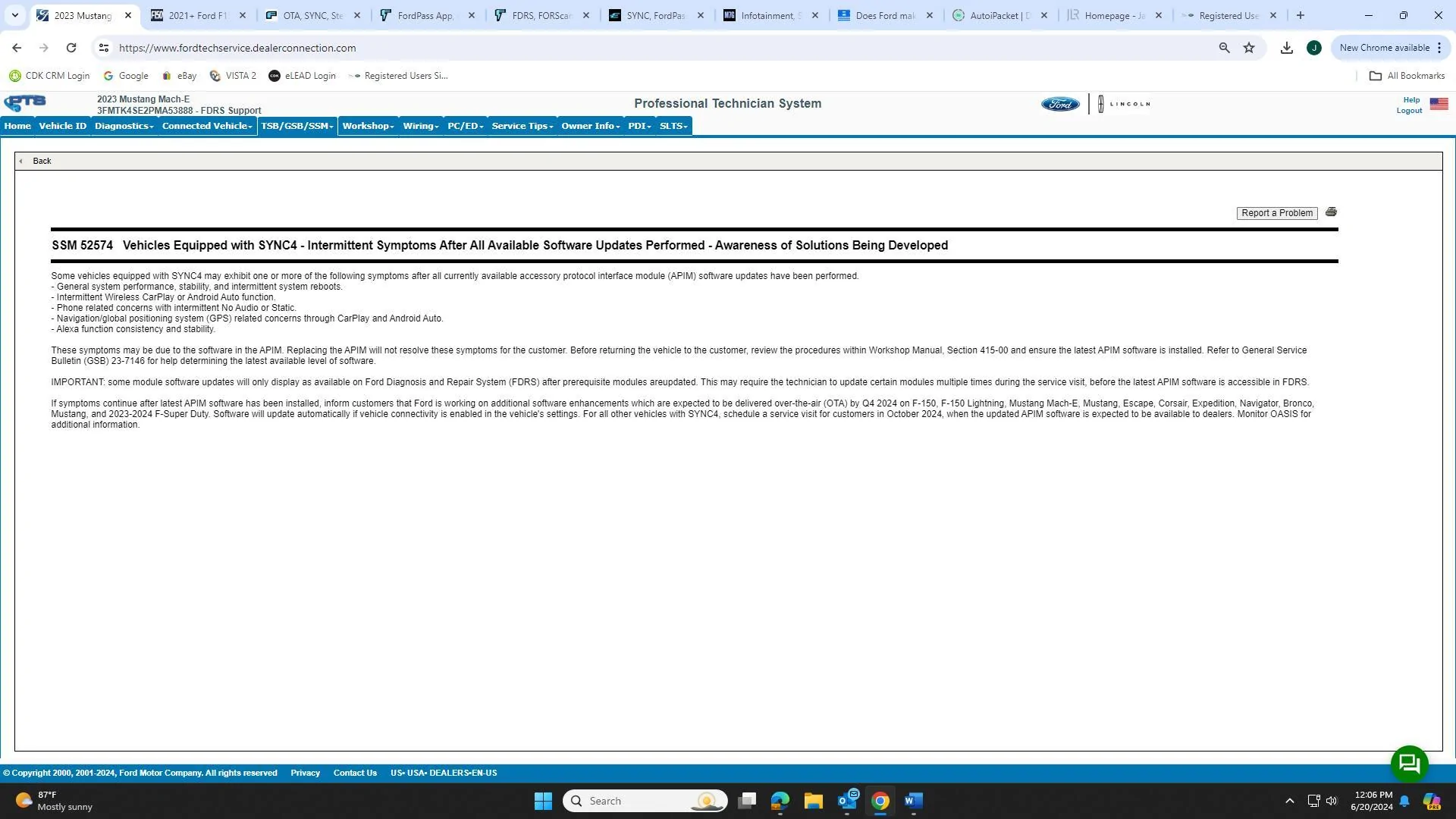

We own a Maverick, Sport and a Bronco. Also had a different Sport and Maverick. Hands free phone is horrible on all currently owned three. Choppy audio. Music is fine before and after the call. Maverick is wired connection only. Wireless on other 2. And we have 3 different phones. Anyone experience this and able to resolve with any non auto update by dealer?
Yes, it's terrible. Ford is aware and they have sent bulletins to all dealers. There is nothing you can do but deal with it until they figure it out.
