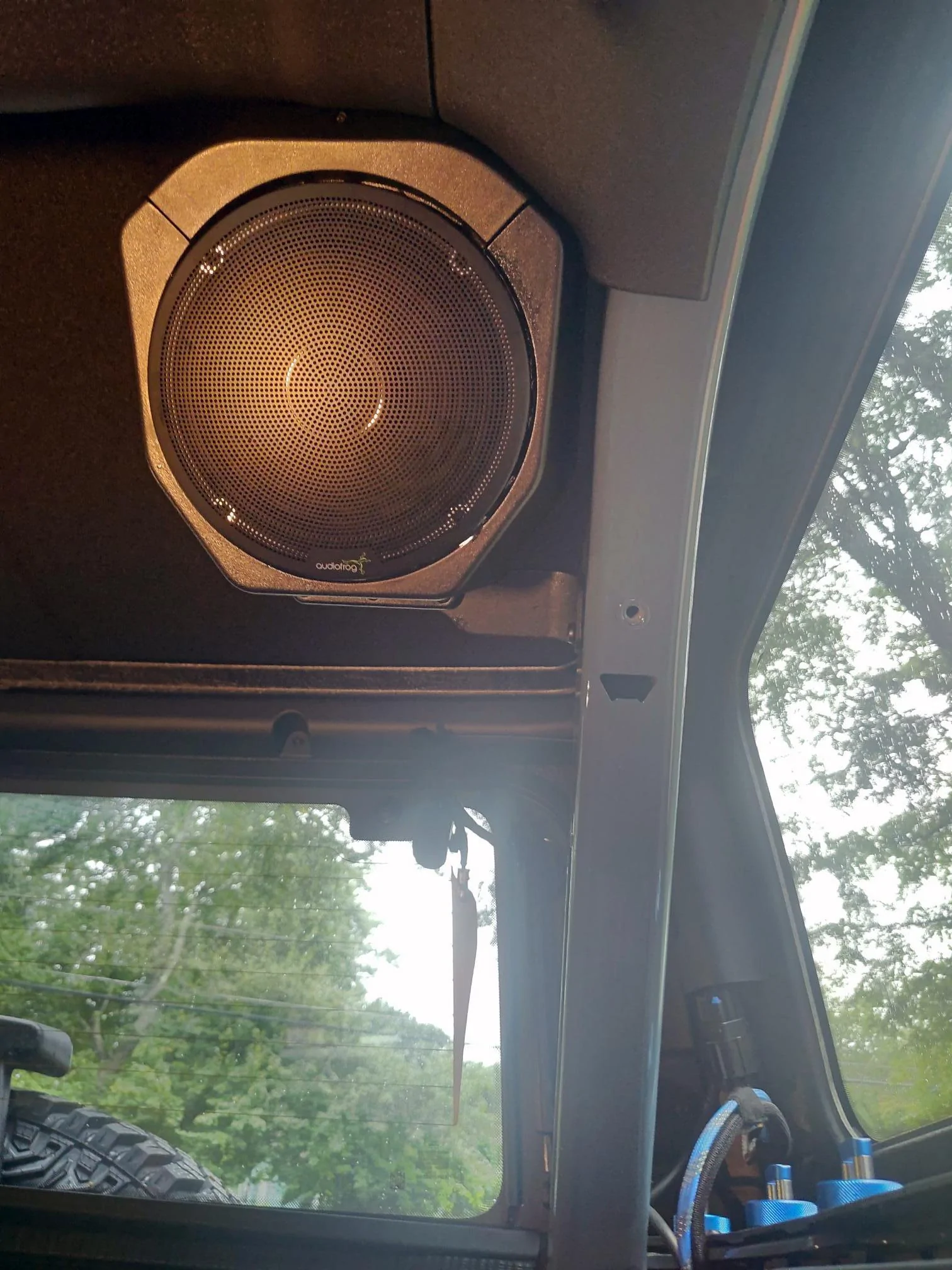

That's what I have. FYI, the grill with the grill ring from Audiofrog will not fit as is on the SSV pods.
I removed the grill from the rings and added small dots of epoxy to secure them in place. Looks fine and is not noticeable ... if you want to use the grills.

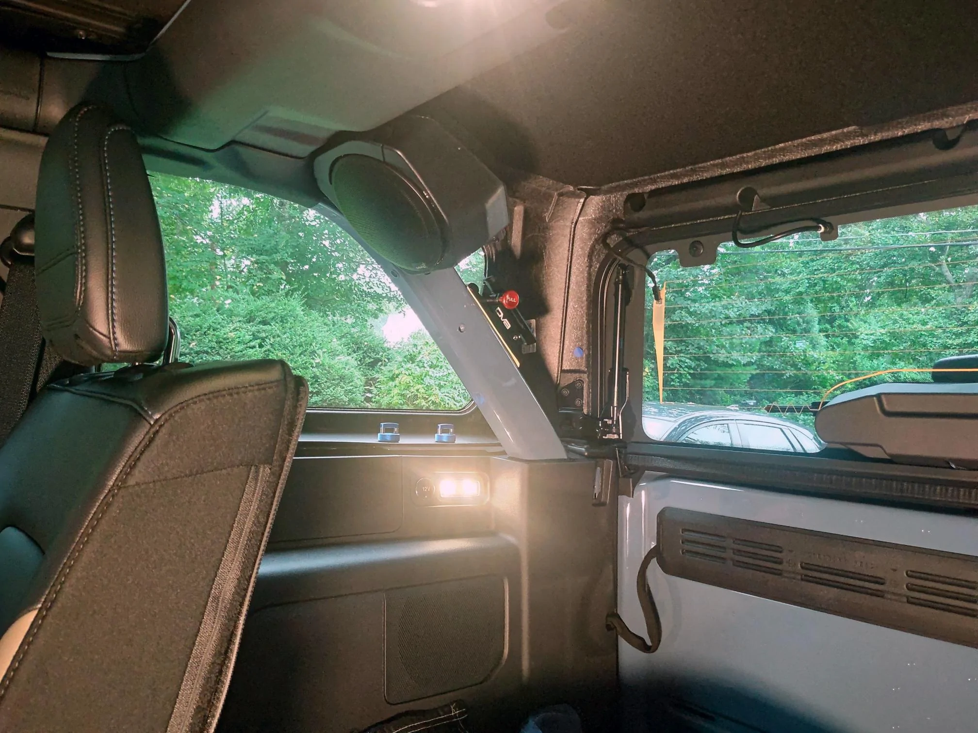

@vicorjh Do you have a picture of what this looks like?
Hi @gringoloco,
Ford Bronco Planning my Audio Upgrade, does it make sense? IMG_20230910_134050
Ford Bronco Planning my Audio Upgrade, does it make sense? IMG_20230910_134155
I did end-up placing a small bead of black colored plastic compatible epoxy around the entire circumference of the grill as opposed to a couple of spots. Prepped and lightly scuffed up the plastic a bit for adhesion. With small dots, there was some resonance experienced at volume in certain frequency bands.
Also, in my case, I added some epoxy to the interior walls to stiffen up the enclosure along with a thin layer of closed cell foam. The plastic is thin particularly on the back side. I feel that helped to damp the enclosure quite a bit.

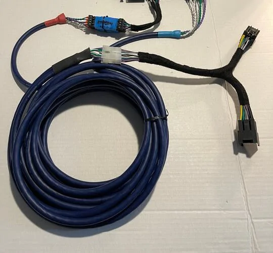

so I’ve gotten my 6 speakers in, and I’m now looking at the ACM amp. The kit I got from PnP came with 17’ of wire and I have no clue what to do with all that lol.

Ah okay so you got the gigantic harness that's (usually) blue.
Ford Bronco Planning my Audio Upgrade, does it make sense? 1723336767913-vn
He gave you enough length on that harness to mount the amplifier in the back of the Bronco if you want, but you obviously don't have to. If you want you can shorten it and add on your own ferrules onto the ends to replace the length of wire you cut off.
