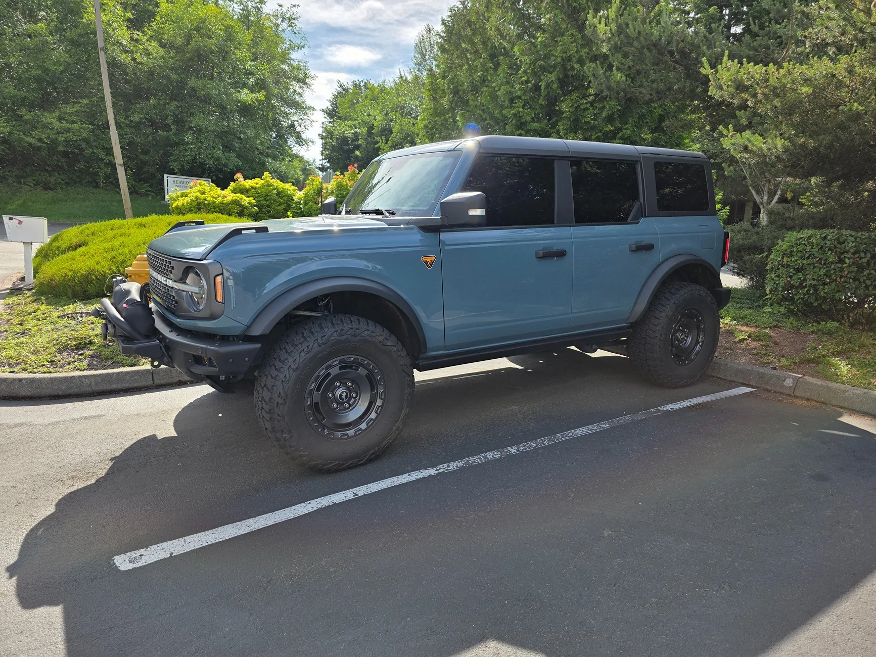

Loving the window tint. Had my wife's Yukon done too (all widows). Possibly my favorite mod! Well, second favorite, 8112s is first, but it's a close second:unsure: Makes a huge difference!

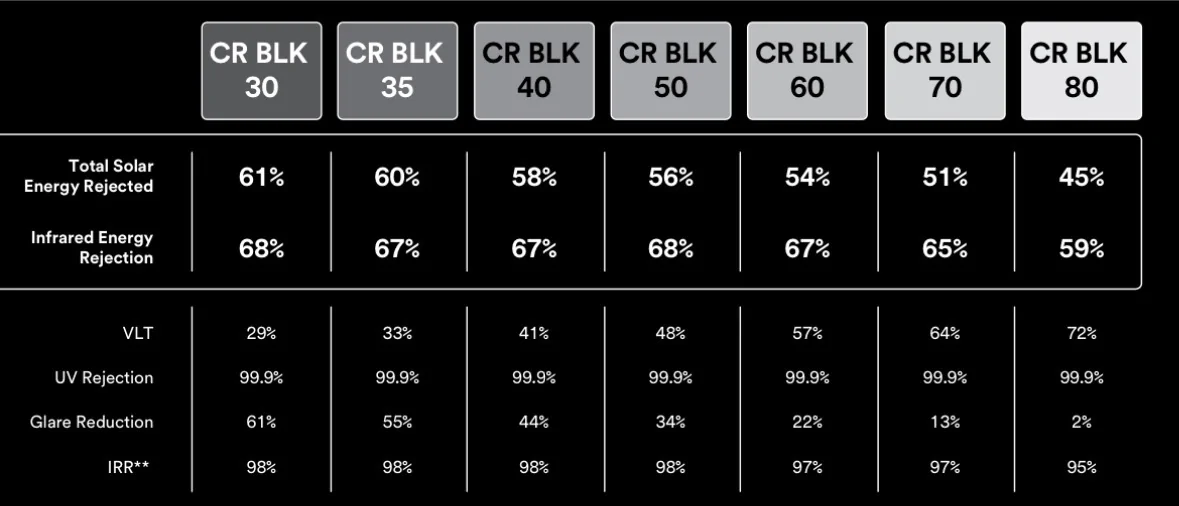

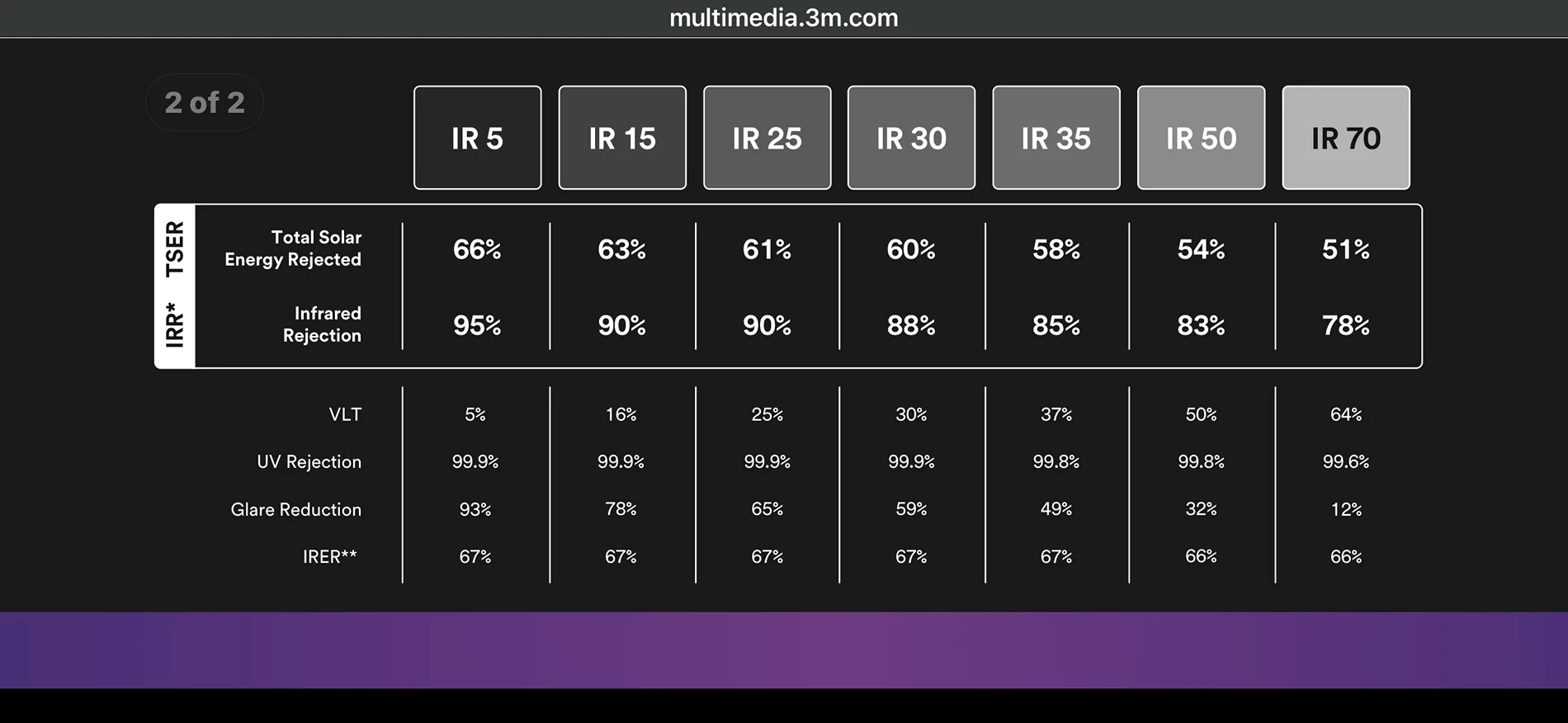

Yes the lightest ceramic tints available still have “total” UV rejection and improved total energy rejection over an un-tinted windshield. As others have said here the difference is noticeable.
Straight off the 3M website.
Ford Bronco Does Ceramic Window Tint really Work? IMG_7979
Ford Bronco Does Ceramic Window Tint really Work? IMG_7980

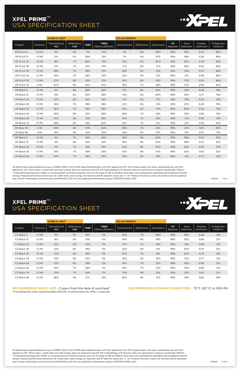

I'm strongly thinking about installing CLEAR CERAMIC TINT (%70 or higher) .....
- But I don't know if its all hype? does it actually work? do you actually feel cooler in the car by 10 or 20 degrees? thoughts?
I live in DFW and find it makes a huge difference in comfort and have Xpel XR Plus in all my vehicles. The cap and windshield got 70 and my front doors got 35 to match up to the cap. I would stick with a high quality ceramic.
