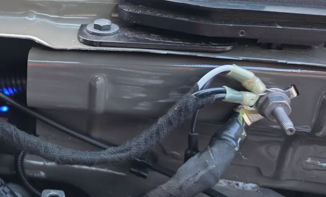

Does anyone know what thread this ground bolt uses?
psdtime
Tom
Mar 23, 2026
214
130
CA
2026 Bronco
I'm trying to figure out what the thread is used on this ground stud? It's threaded on the outside and I would like to use that for any future additions since I have added so many below it. I know it looks like a nut on threaded stud, but it's actually a bolt with threads extending off of the head. This is the one closest to the battery where the battery's ground lead is attached. Thanks

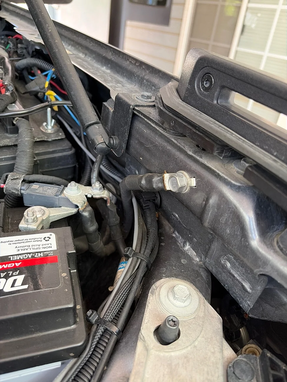

Went to check for you, but apparently newer models are different. I don't have that stud.

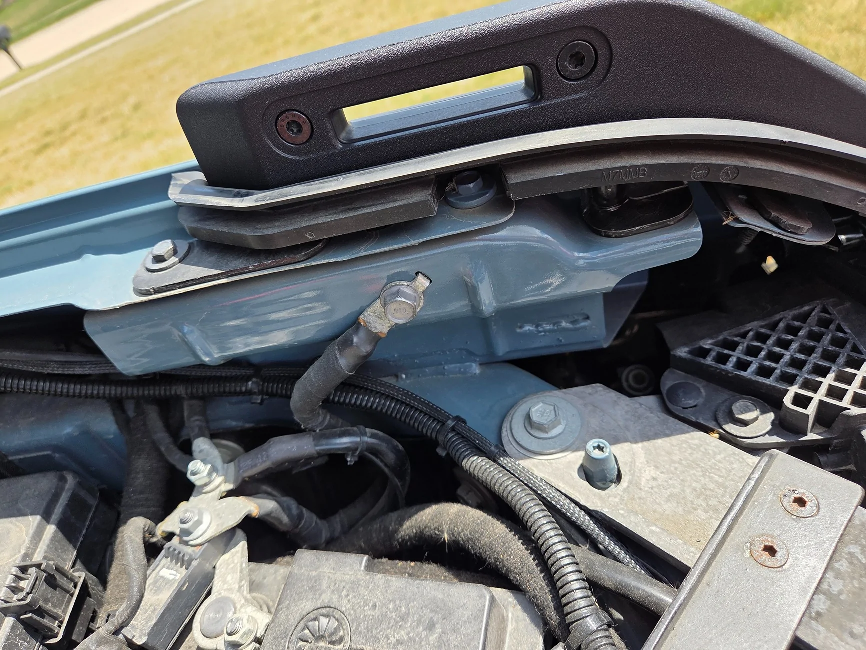

Probably m6 just eyeballing it. Mine doesn’t have that stud at all though

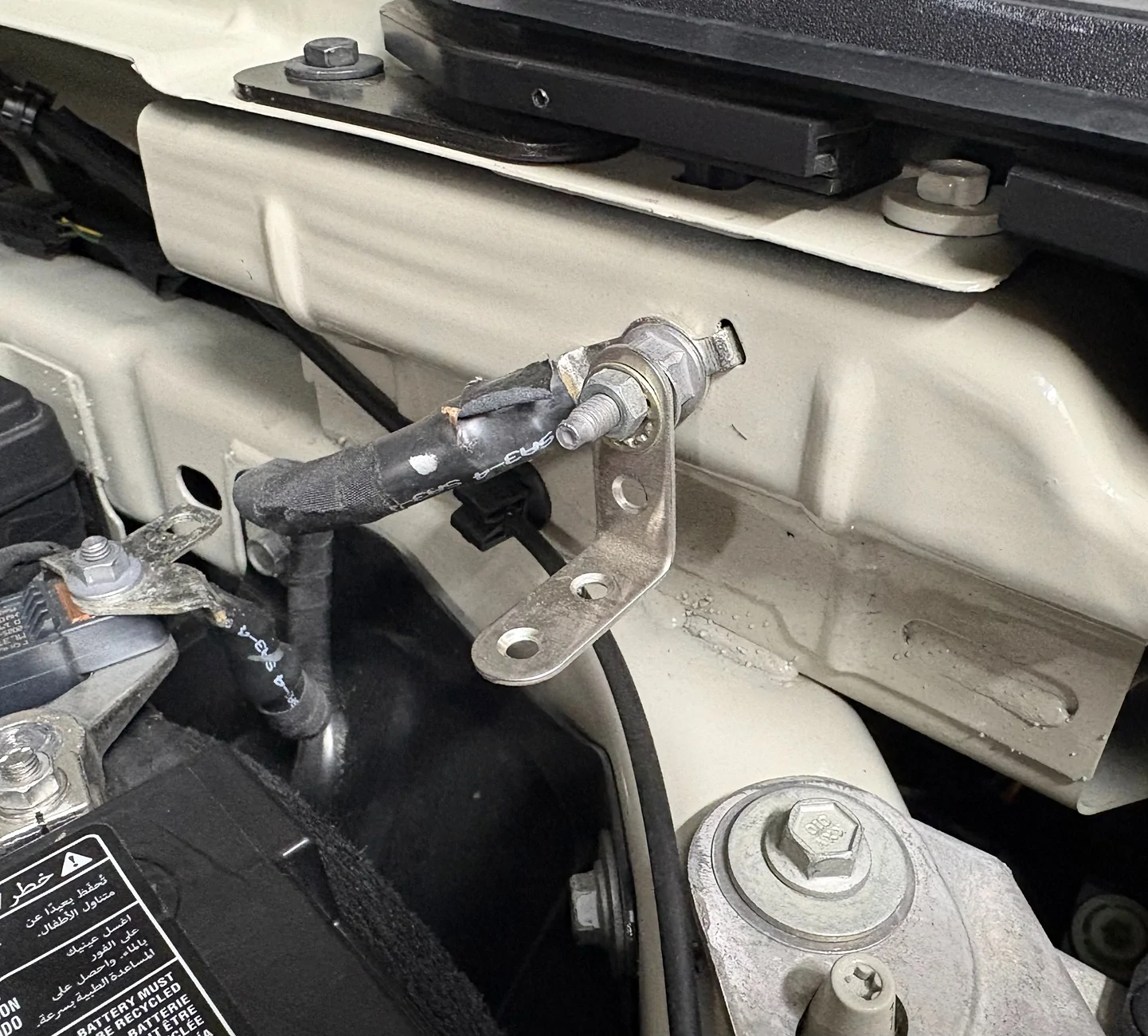

'got the same thing.
I had a spare nut that happened to fit when I installed this bracket, and just measured it to be M6 x1.0 per Mitutoyo (caliper) -- if this helps anyone.

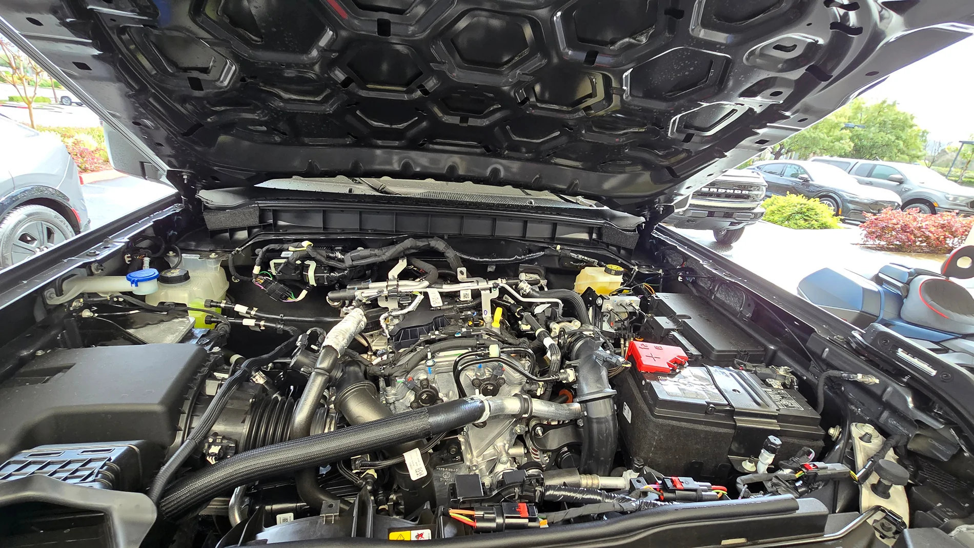

Might be too late, but here is a picture of my 2026 4-dr Badlands with the 2.3L engine compartment. Note that it does have a ground stud vs bolt. Maybe stud vs bolt is model or year dependent. Google AI seems think the thread size is M6x1.0.
