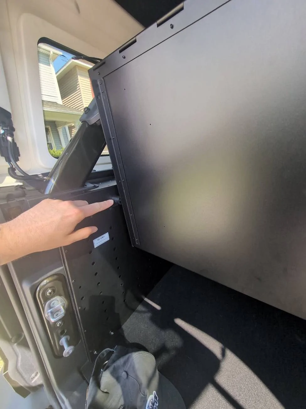

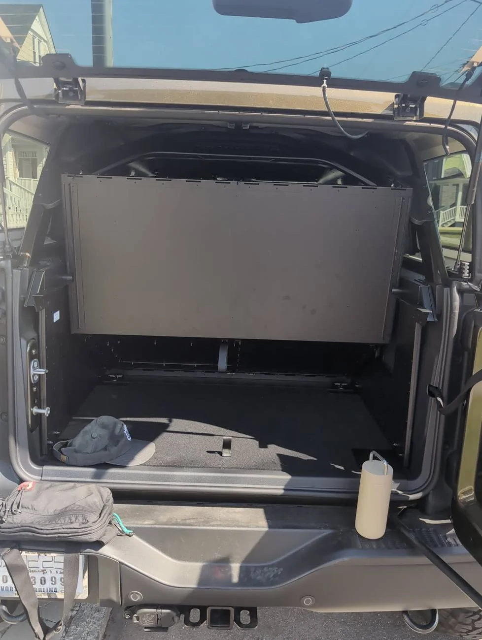

Update on my EZ4X4 security enclosure...
Received mine yesterday and immediately started to install it. Got halfway thru and realized that it didn't have clearance to fold to collapse as it was constrained by the Bronco Raptor d-pillar cross brace. I sent a note to @EZ4x4 and the owner, Brian, personally called me back. We ended up making a couple mods to the enclosure unit and got it working. I had to remove 2 bushings and used my angle grinder to trim 1/4" off the end of the shelf ledge on each side. After the prototyping proved successful, Brian said he will incorporate the modifications into his product and send me freshly manufactured parts to replace the parts I modified. What can I say...a great quality product and amazing customer service. (As an aside, I also bought the EZ4X4 4 door rolling cart, which is also quality and highly functional. Keeps my doors securely stored.). An extra bonus, while installing the enclosure, it occurred to me that it may interfere with the Additive Desert Design molle panel I had just installed on the tailgate, but they both fit together perfectly. See pics and video of the process and finished product.
Ford Bronco Do you have a security enclosure for your cargo area? IMG_7680
Ford Bronco Do you have a security enclosure for your cargo area? IMG_7688
Ford Bronco Do you have a security enclosure for your cargo area? IMG_7701
Next I need to decide if it is worth it to trim the cargo rubber mat (the enclosure slightly narrows the cargo area) or find something that fits.

Okay I'm so glad they found a solution. Was in the same boat with my Raptor and the install. Waiting for a call back from the owner. I was thinking of removing those rubber/plastic cylinder spacers, is the angle grinder the only way it fully works?
Angle grinder (well the cutting wheel) took a minute per side. Then rounded off the sharp corner with the grinding disc. Gets you a quick solution. Or reach out to EZ4X4...

Did your fix, thank you so much, works so well now!
