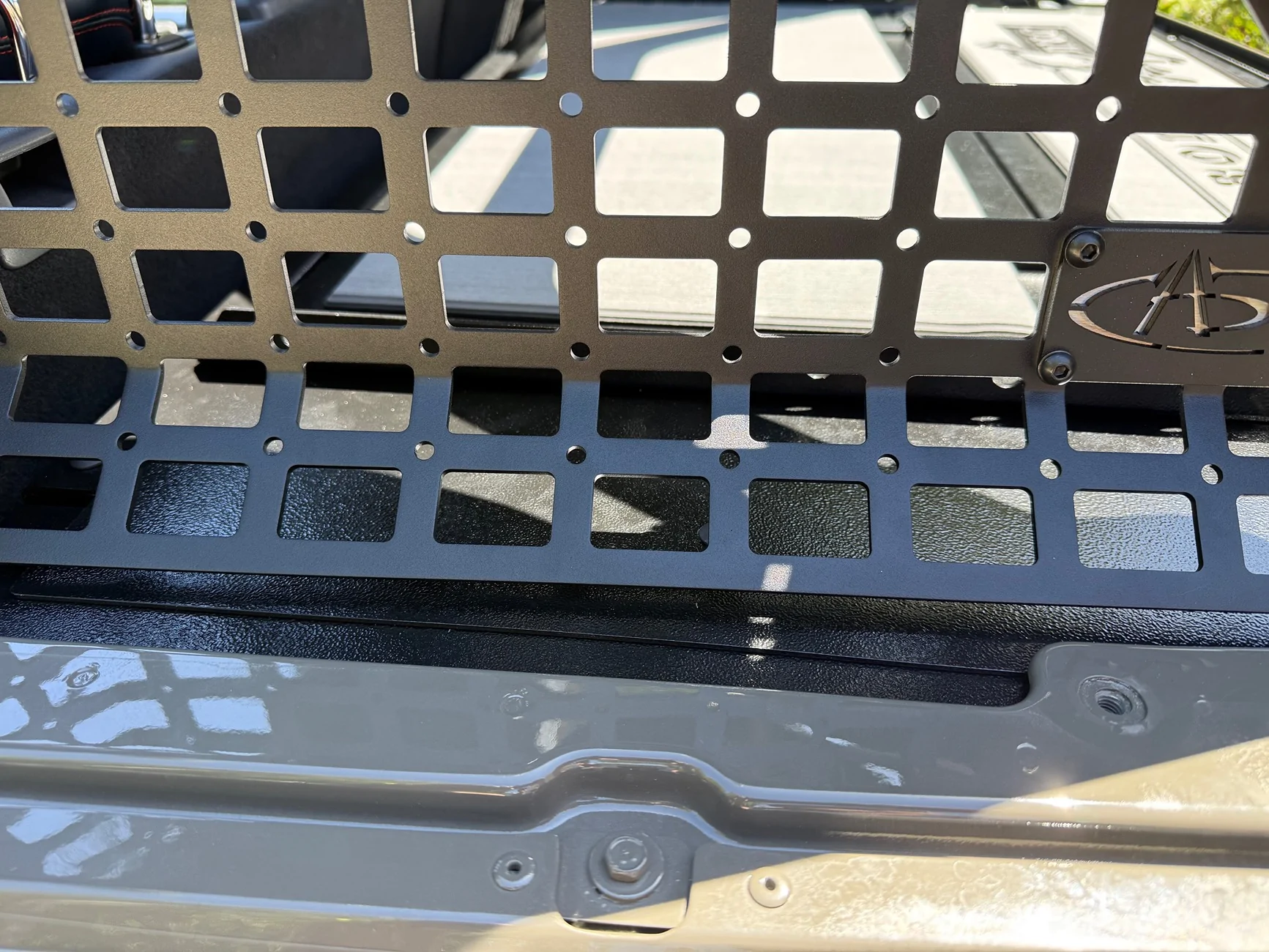

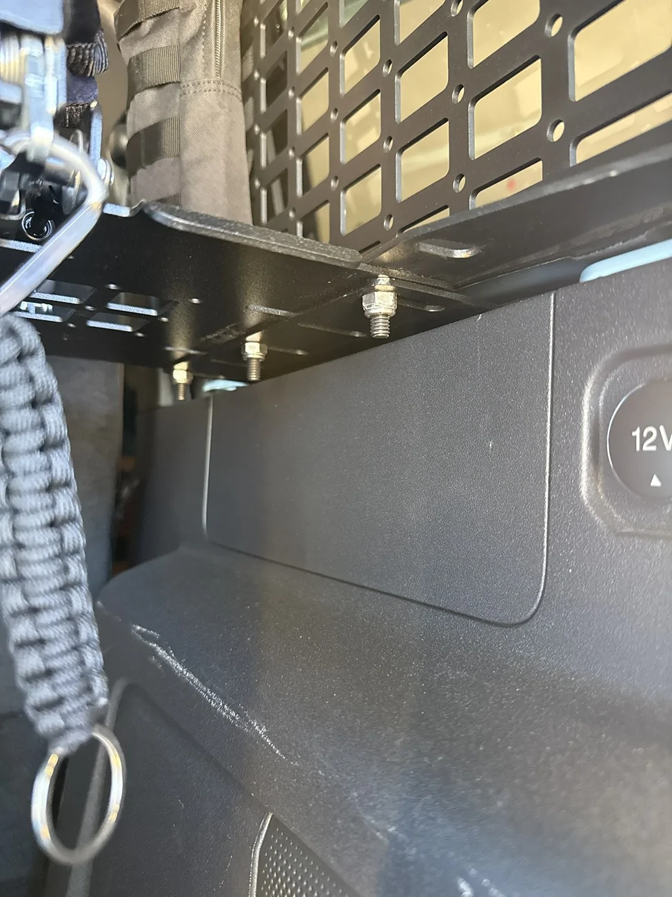

I have the DV8 side molle panels but I flipped the lower Bracket around and mounted it to the bracket of my Mountain2Metal flip up cargo shelf which does not interfere with the roof at all. The first image shows it with the bracket on the roof flange. The lower image shows it flipped around to the shelf bracket which mounts the the side of the bed that plastic door. FYI M2M does sell the mounting brackets separately if you need that option.
M2M shelf bracket
M2M Cargo Tray

Ford Bronco Rear cargo area side window molle panel question Side Molle panel
Ford Bronco Rear cargo area side window molle panel question Molle mount

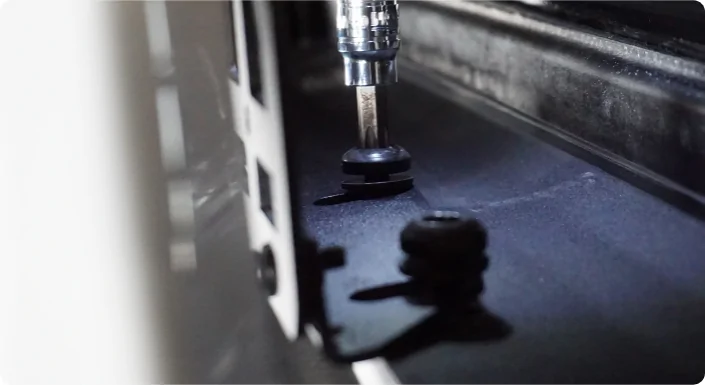

Not sure if your looking specifically at the ones you mention or just in general, I have the BroAddict version that does not attach using the hardtop hardware.
https://www.broaddict.com/products/4-door-rear-window-molle-panel-system
I have not taken the top off yet since I installed them, so I am not sure how hard the bolts will be to reach. I did replace the bolts with the thumbscrew ones from RockWorkx.

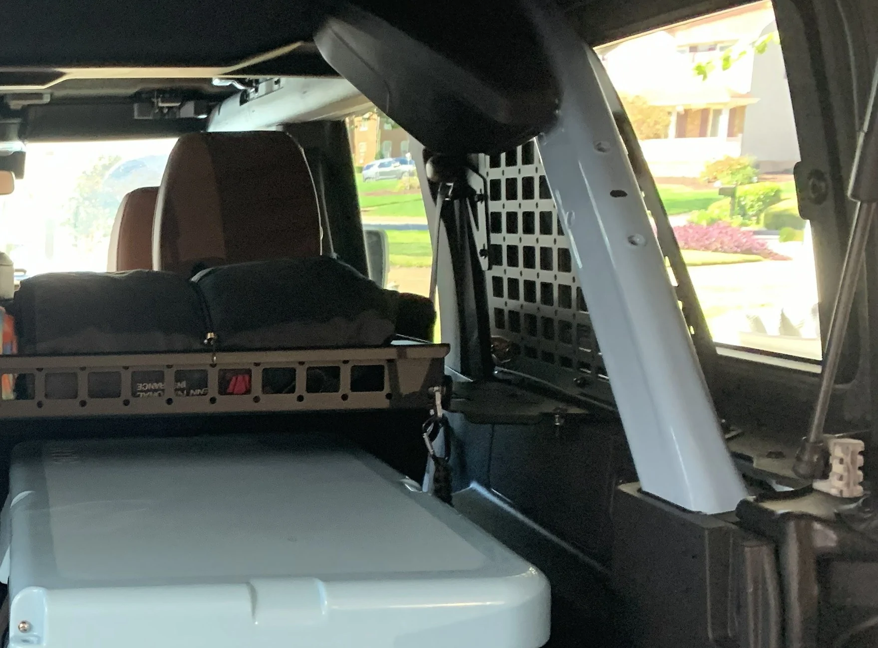

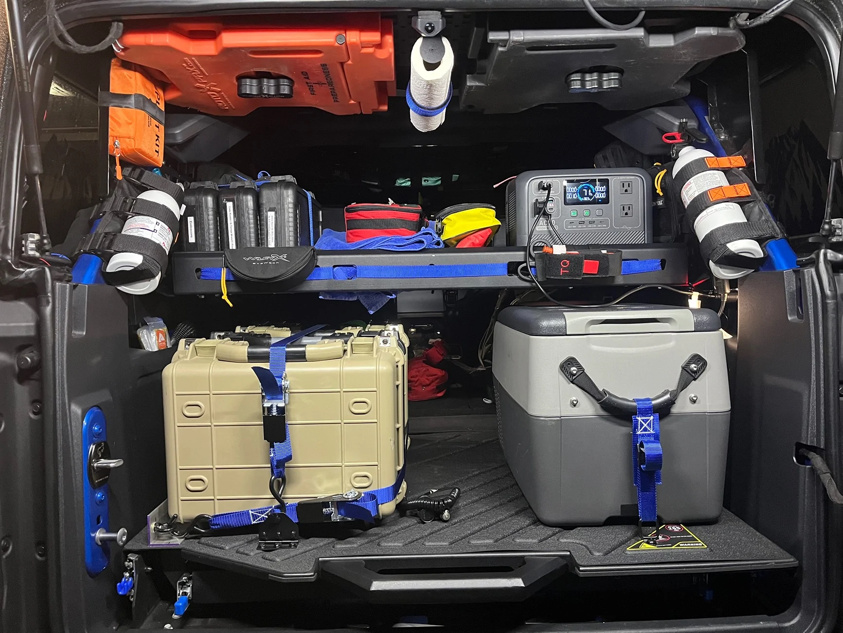

You can also check out JCR Off-road, they make the Molly panels that attach differently and not to the hard top mounting bolts. You really can’t see the Molly panels in the pictures, but the shelf attaches to them.
Ford Bronco Rear cargo area side window molle panel question IMG_9587

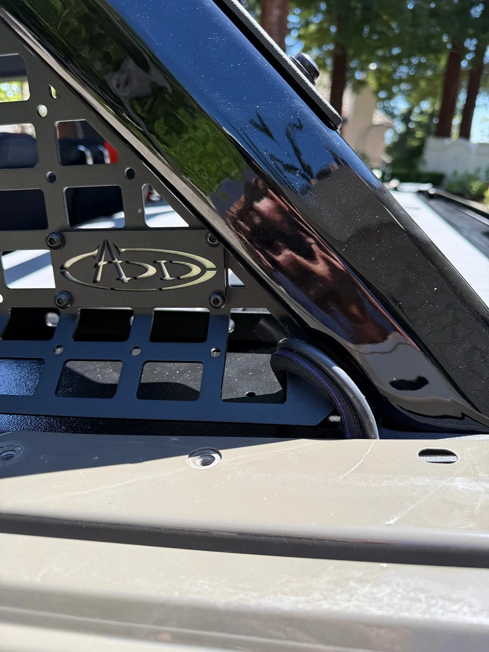

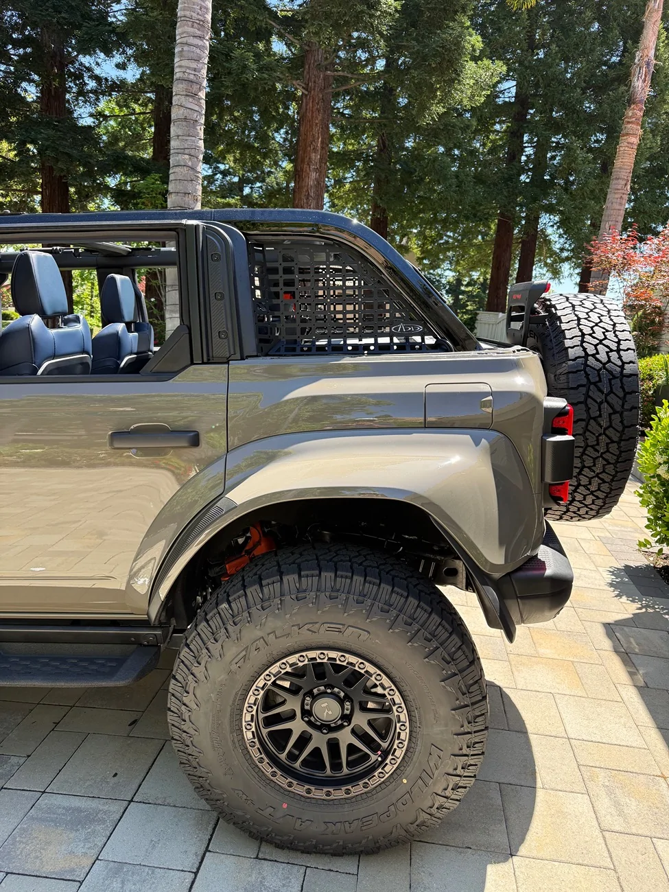

I’ve got the ADD panels. I run them under the hard top. Not been an issue in any way After 18 months of hard use. Mounting them on top of the top means you’d have to remove two brackets on each side that would be very challenging to replace with the top on.
they are rock solid and I store so much stuff (sleeping bag, emergency clothes, large first aid kit, jackets, etc) behind them due to the smart spacious design. I also have my ARB twin compressor mounted on one, again…rock solid. I did expand one molle hole on drivers rear to pass the wiper motor harness connector through.
if you decide on ADD this post might be helpful

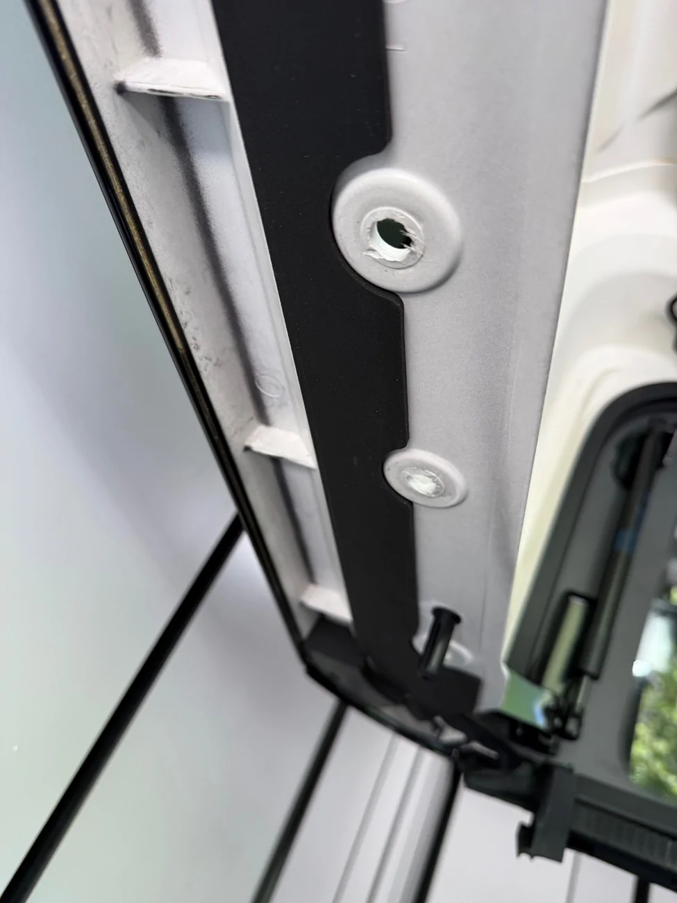

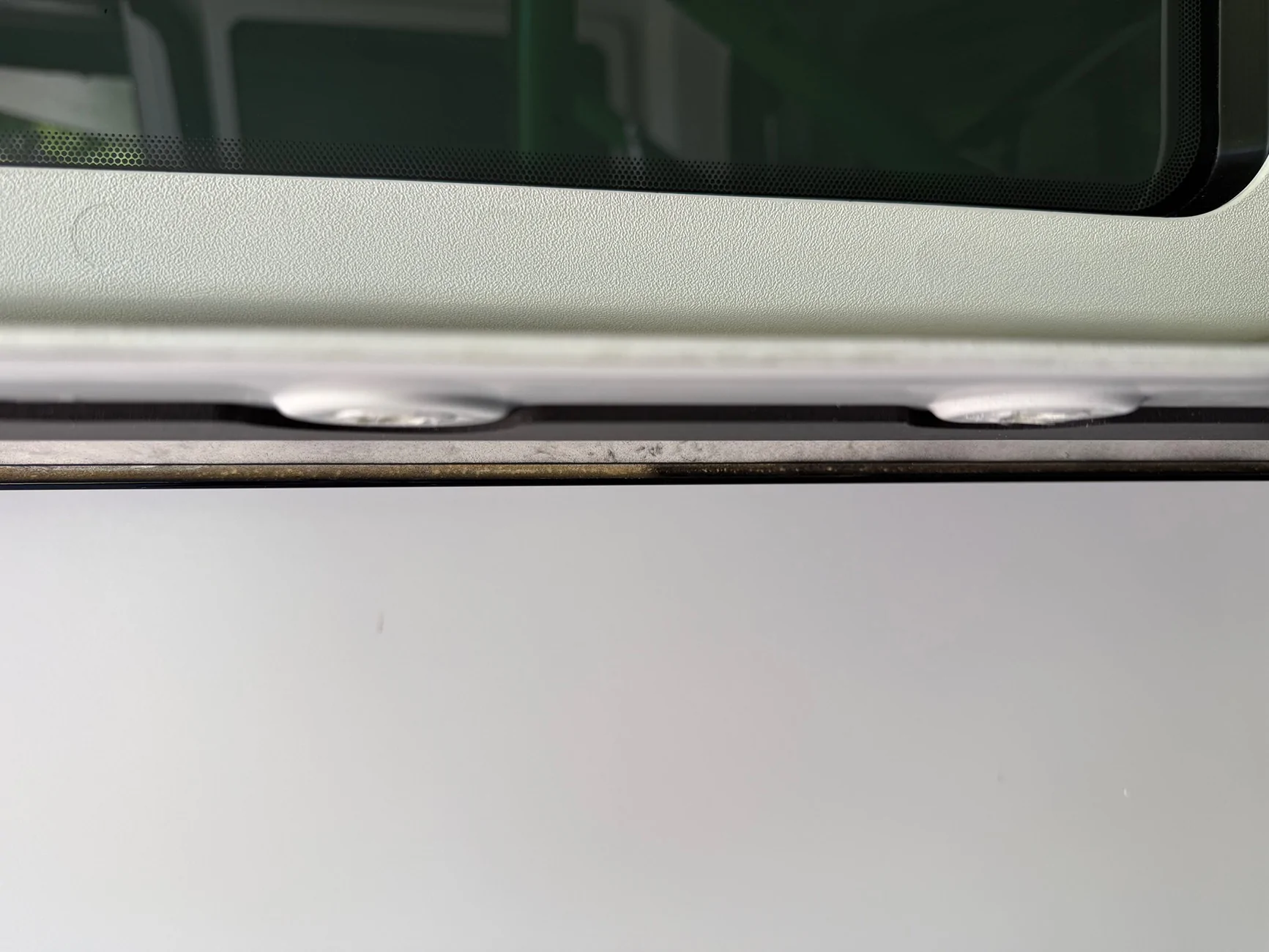

I did decide on ADD because I too like their design. But I won’t be using the brackets that go under the hardtop. These will definitely shim the hard top up by the thickness of the bracket due to the raised molded landing pad around each mounting bolt (see picture). If the brackets are mounted between the quarter panel and the roof, the roof rubber seal will not even touch the quarter panel. I have a Diabolical Slipstream and I’m going to modify the brackets that came with the ADD panels and mount them internally.

Molded in stand-offs on my 2026 hard top
Ford Bronco Rear cargo area side window molle panel question IMG_1887
