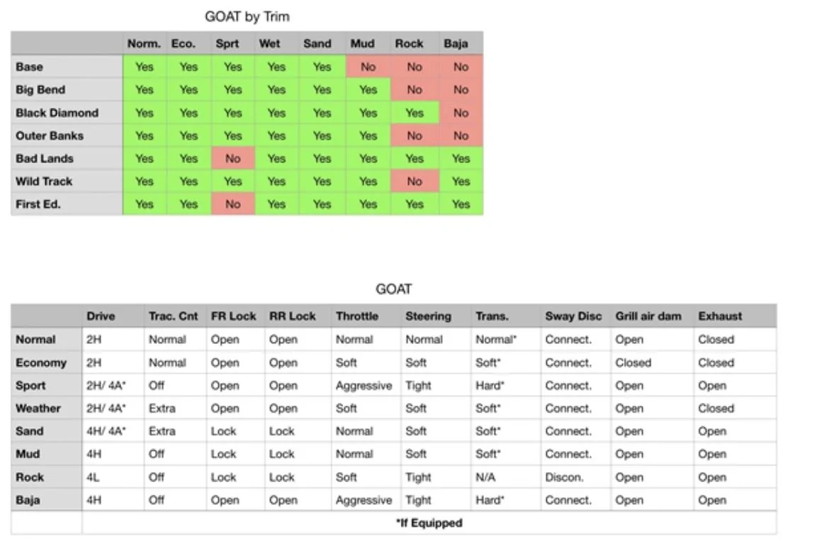

I don’t recall where I picked this up but it’s from “back in the day” (and pre-Raptor)
This provides an overview of the GOAT modes & their changes to vehicle settings.
this chart dates to way, way before any actual broncos were available and was pure speculation based on F-150 Raptor modes
