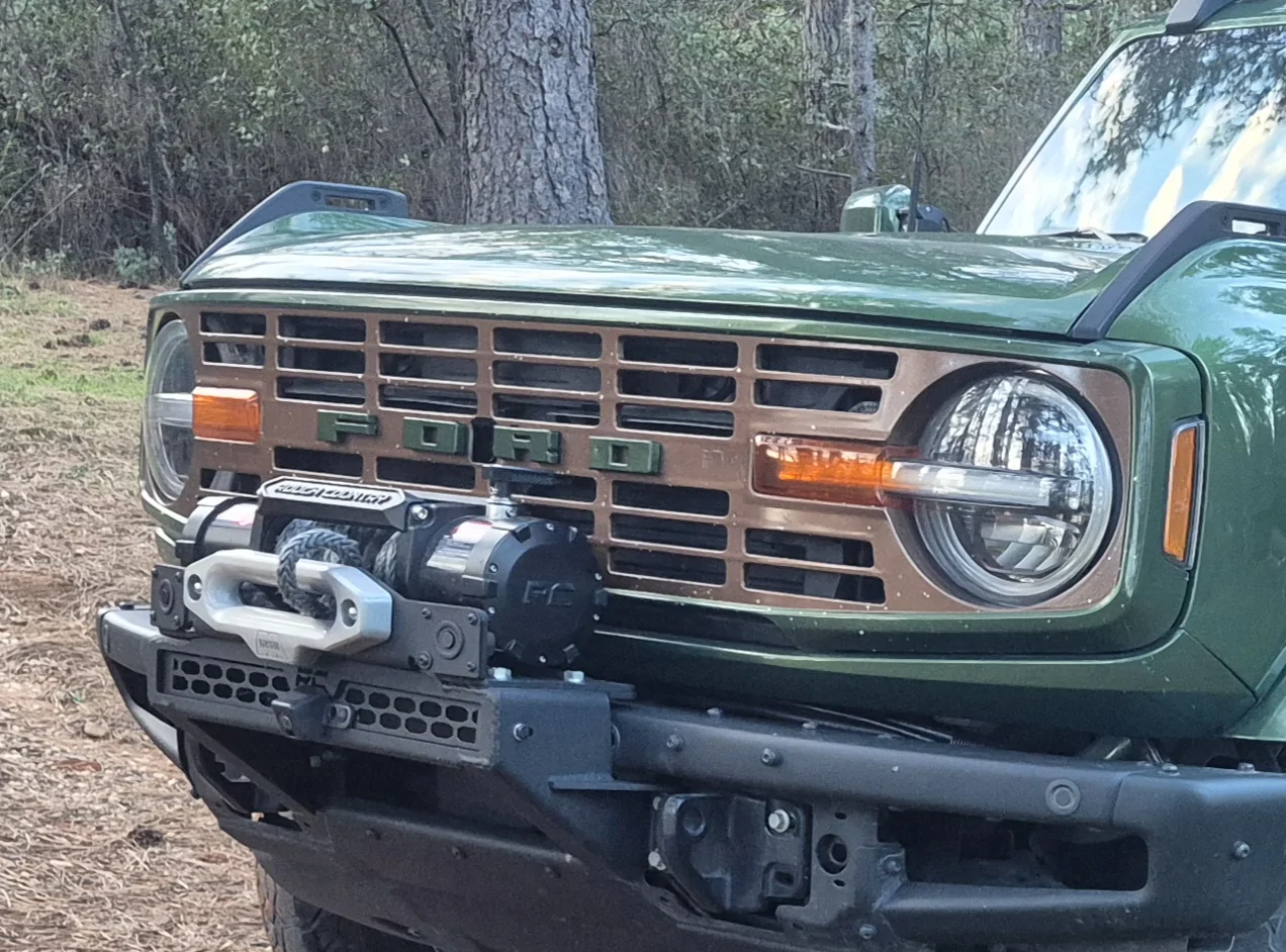

Great minds think alike... I also did almost the same, about a year ago. Used 'Automotive Touch Up' https://www.automotivetouchup.com/
brand paint to match the Eruption Green, and Krylon dark copper.
Ford Bronco DIY heritage grill 20260126_073331(1)
I also had my son 3D print up the F-O-R-D letters I drafted up based on the same script as the 6g letter font on Autocad. Now that I relocated the front camera to just below the winch, I need to have him 3D print up a blockout plug where the camera used to be...
That looks great! What did you use to cover up the holes for the first and last letters? Looks like it was only ever meant for the ford letters in the first place. Really cool!
