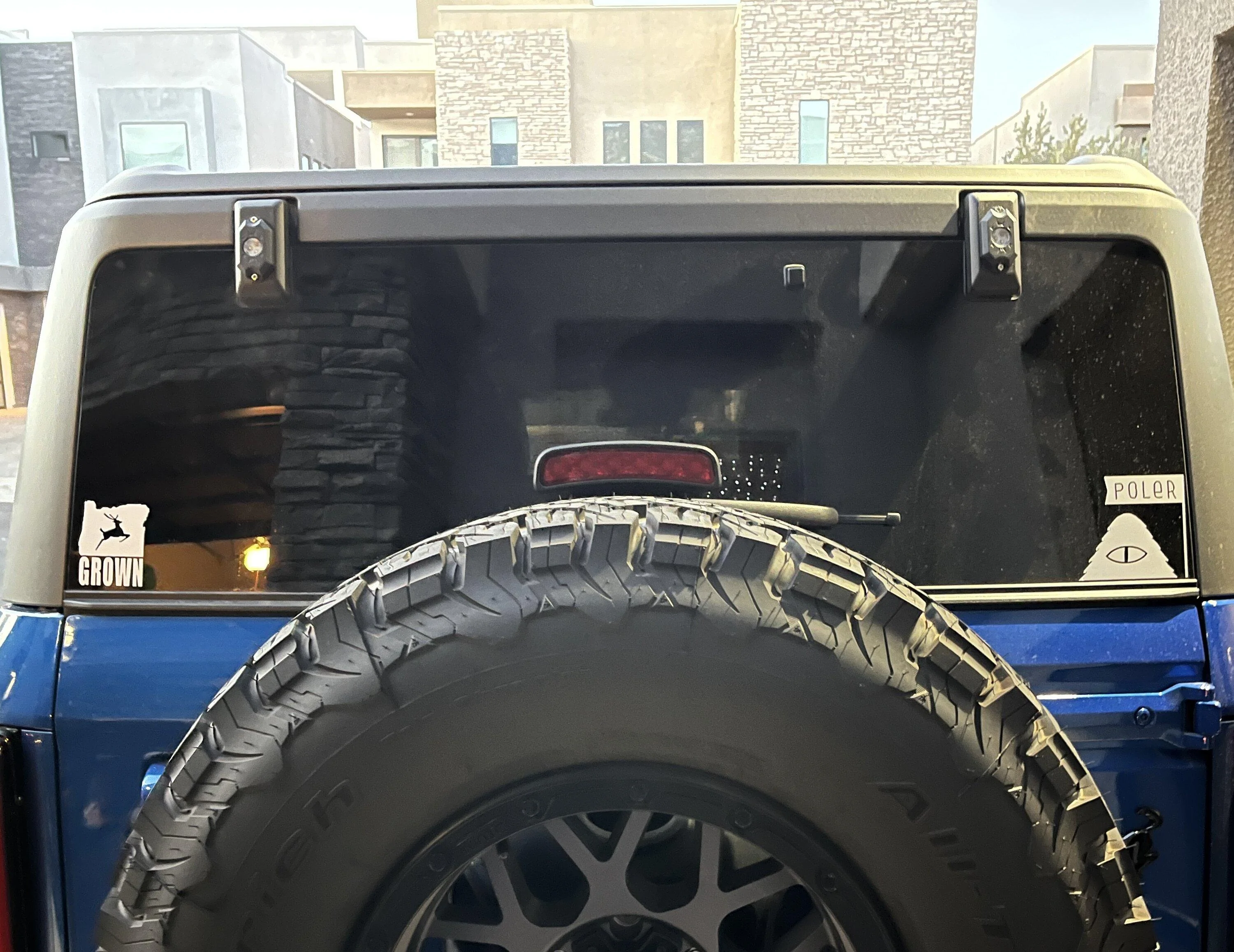

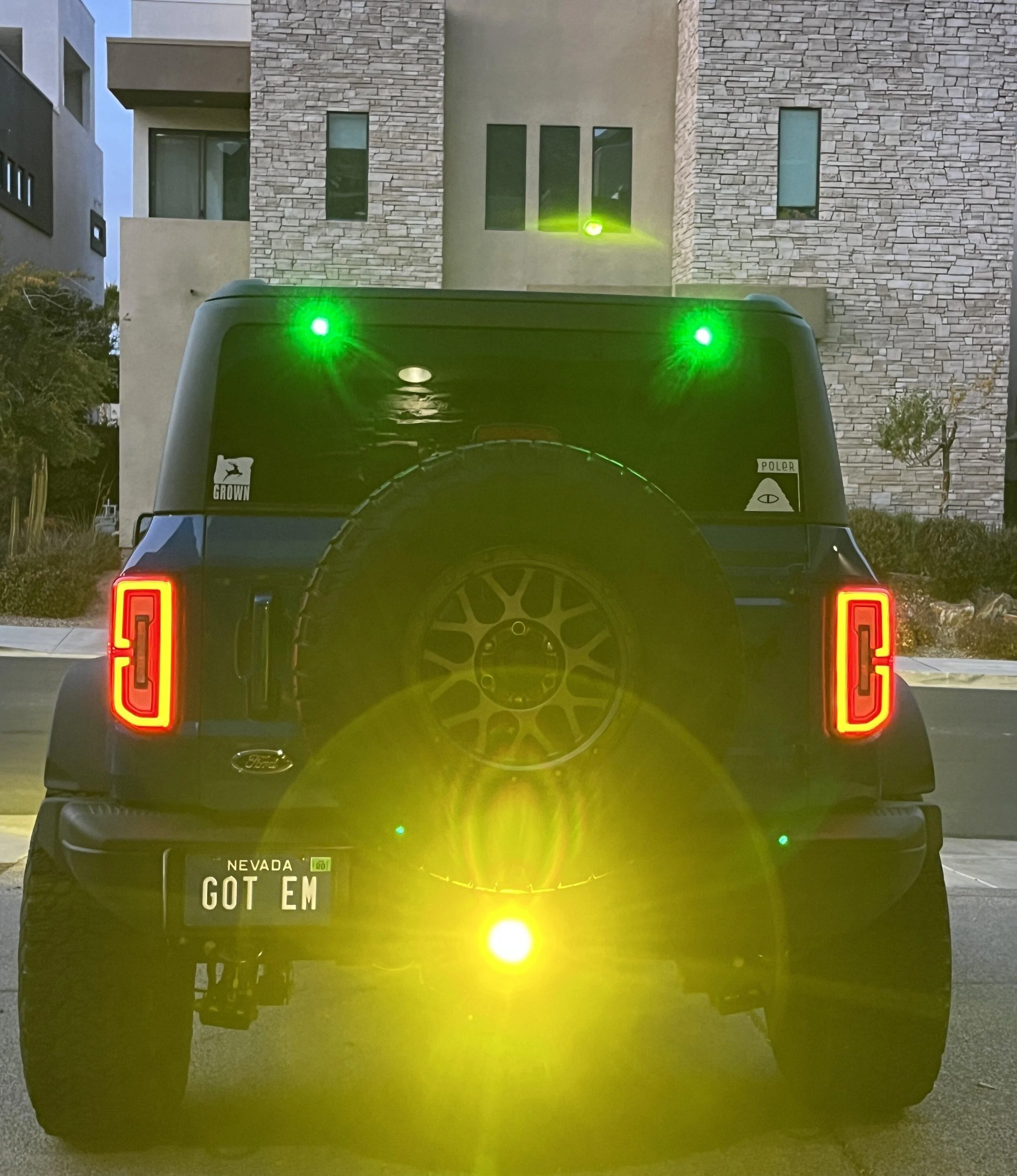

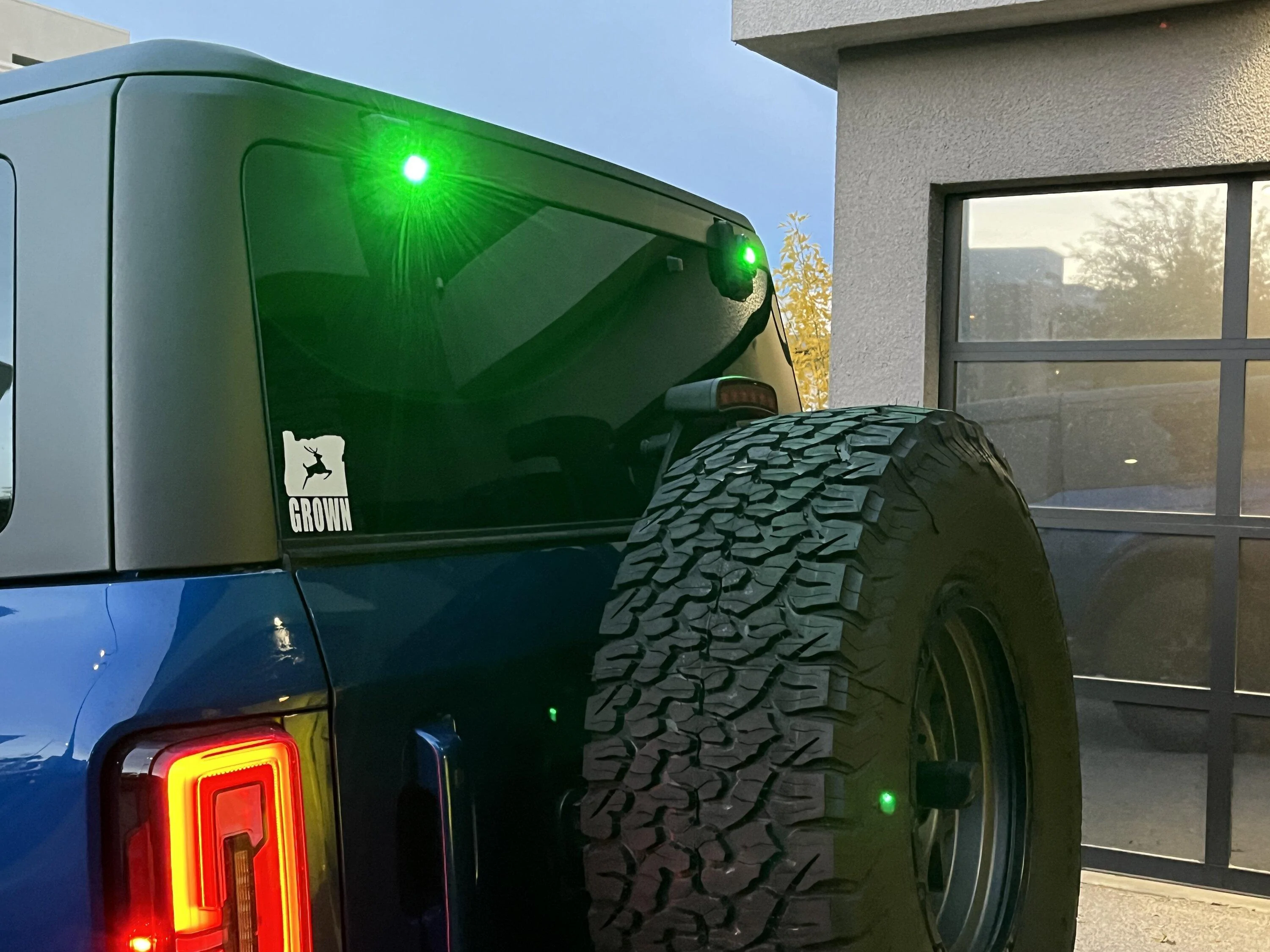

Used some RGB rock lights as chase lights. Mounted them to the rear glass hinge covers. I’m happy with it as they blend in well with the hinge covers.

Can you explain a little more about how you mounted them? Did you just screw it onto the plastic covers? Do they just pop off? I want to try doing something similar but don't want to crack the cover getting it off. :)

Sorry this might be a little late. but the covers pop off you have to push them up they have little hooks that hold on to the hinge pin. if you open the glass you can see them. it helped if i pushed them up with the glass open then had to close the glass to get them off. I am using the Nilight RGB set but they look identical to the OPs lights I had to use shorter screws then what came in the lights, to mount them dilled a hole for the cable and two holes for the screws mounted them with some RTV, I just need to mount the control box and wire them up.
I was going to mount the second pair on the sport bar for when I am rolling top off and need the lights.
