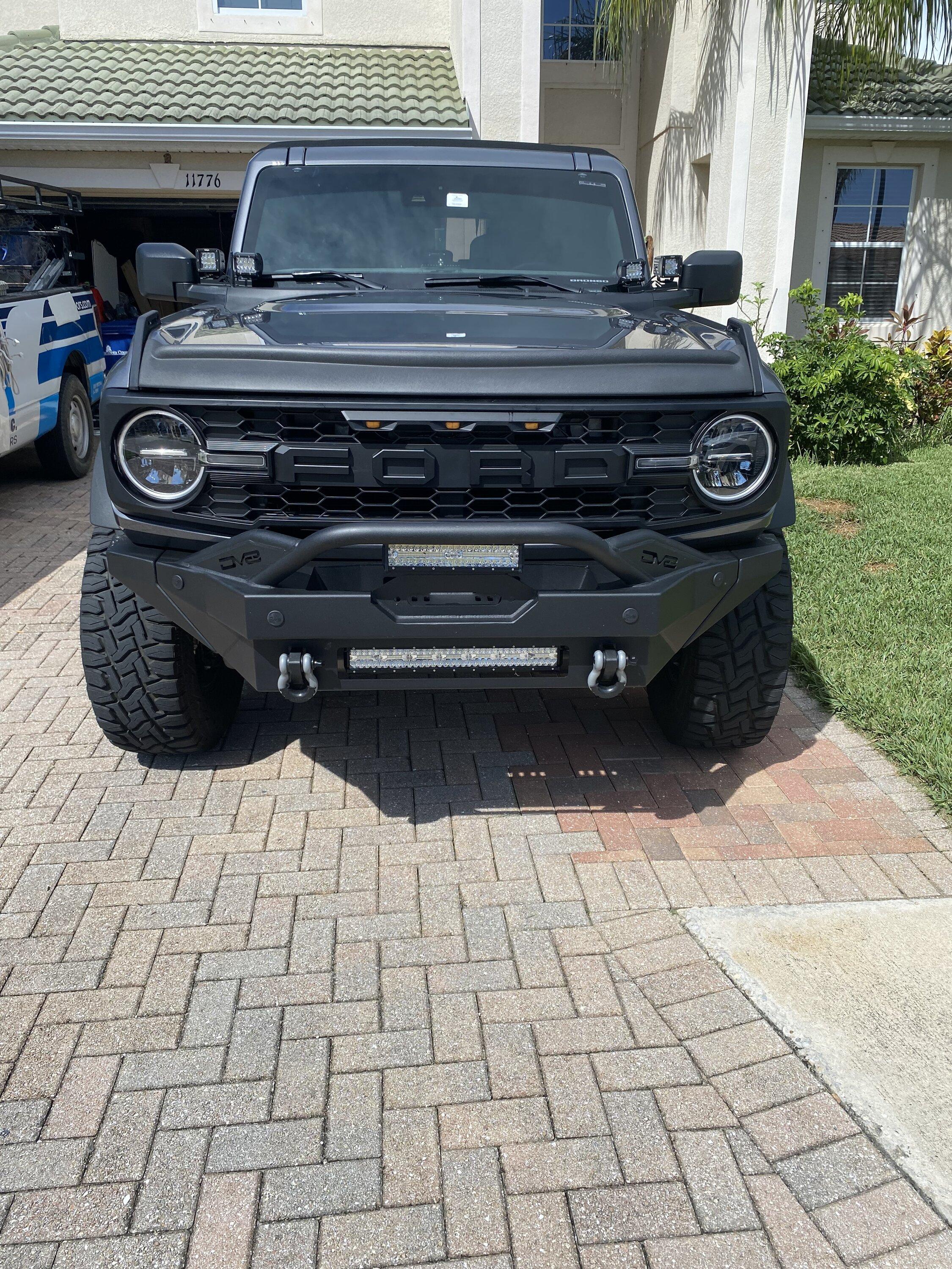

I just installed a Raptor grille on my black diamond today. Very simple and bolted right up. I assume everything else would also work the same way. Going to get the Raptor front fenders too
I'll be honest, I love that grille except for one minor detail. I wish the letters weren't as spaced out. Otherwise than that I love it and your bumper!

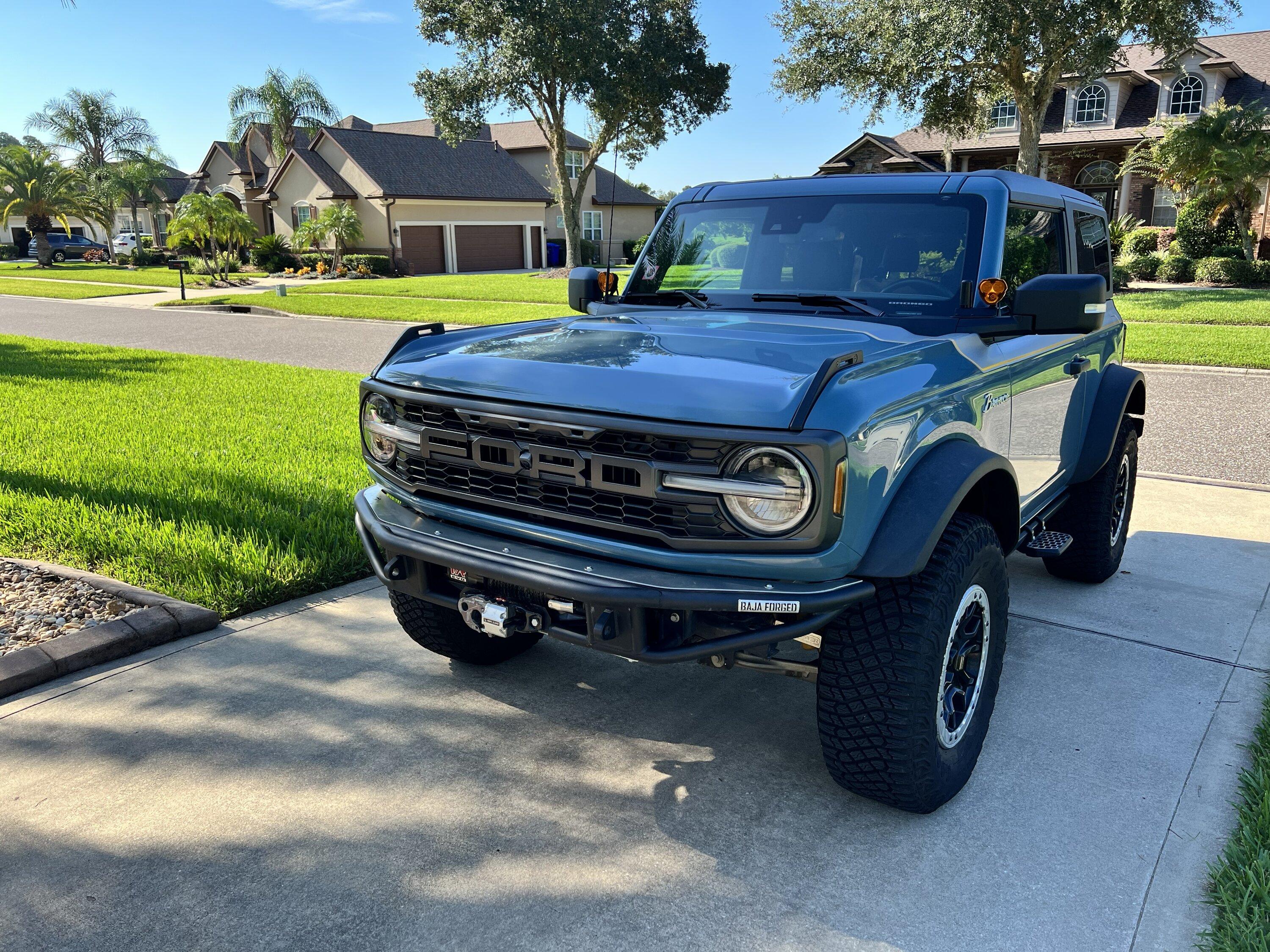

That is definitely a knock off grill. Here is an OEM on my two-door:
Yep drop shipped from cali by a Chinese company but I haven’t been able to find the OEM anywhere.
