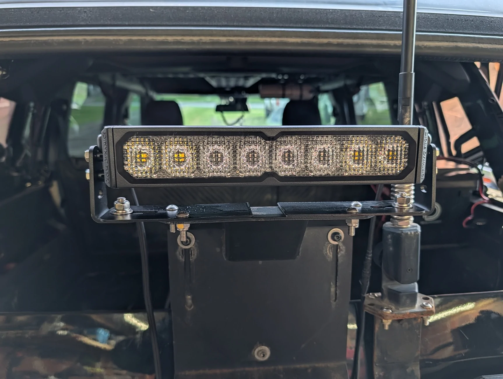

Just finished installing the brand new @Diode Dynamics 10" Chase Light Bar, purchased from Adam @4x4TruckLEDs.com
I'm super impressed so far.

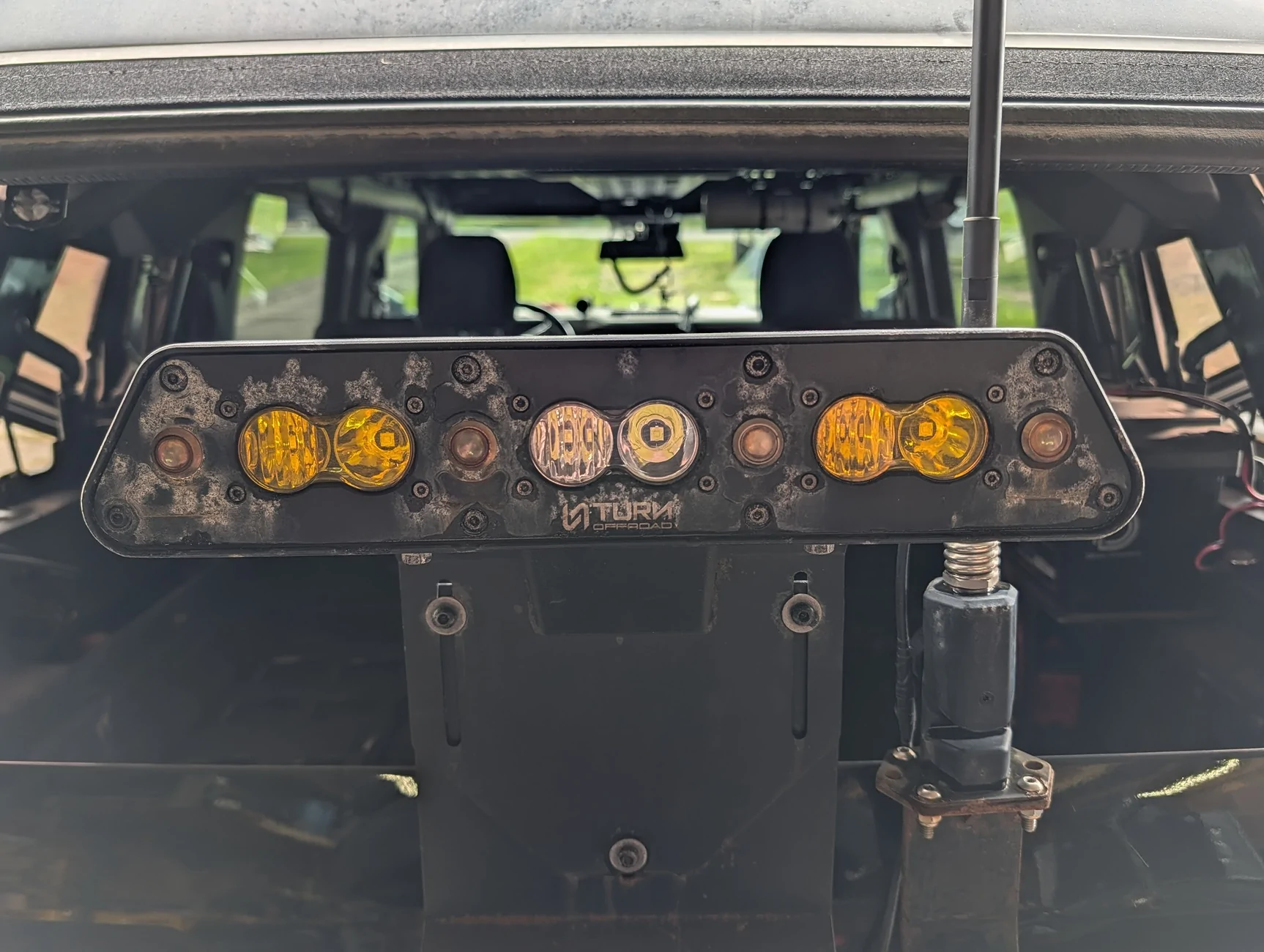

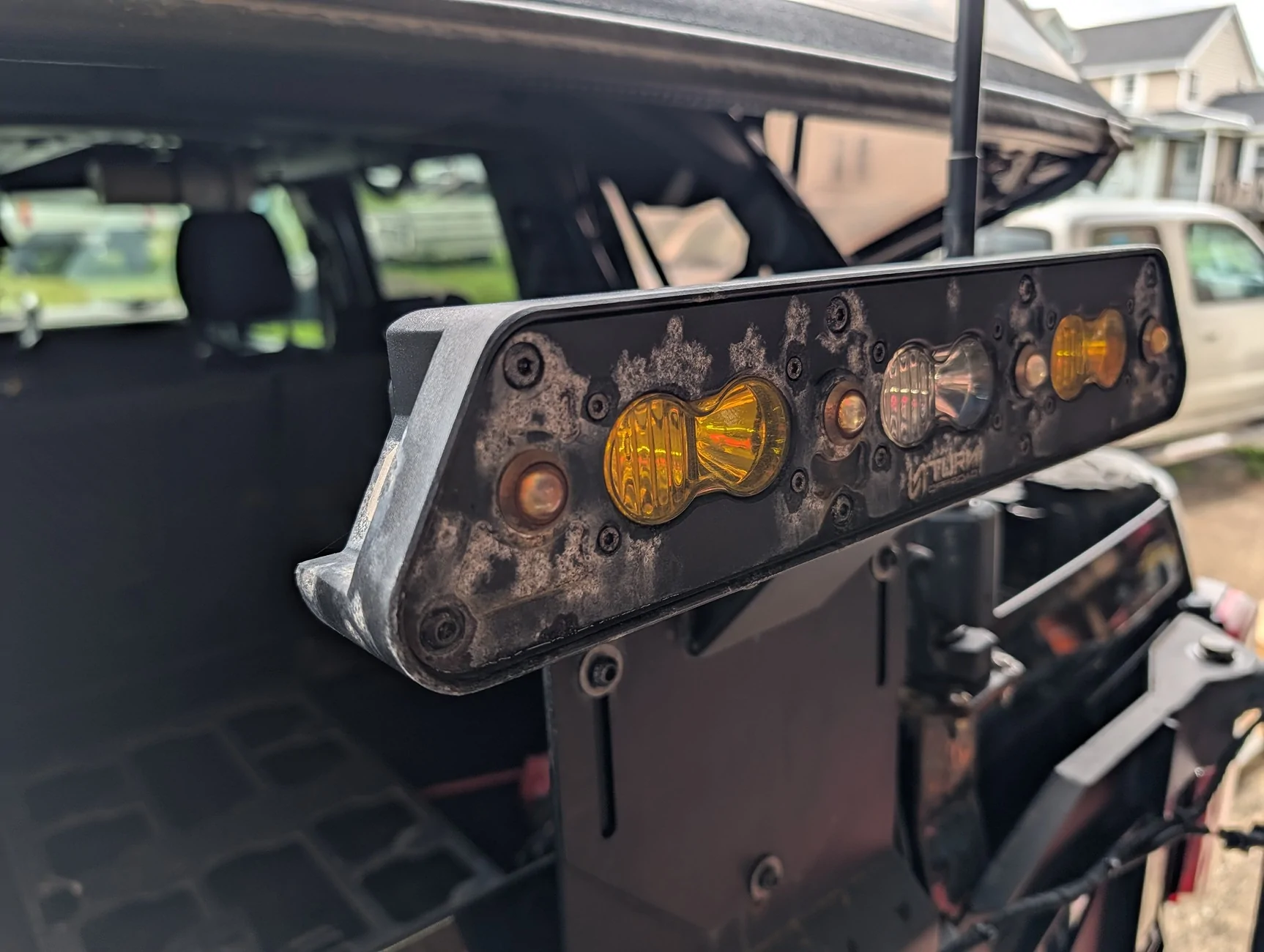

I previously had a @Turn Offroad chase light/3rd brake light, but I wasn't satisfied with the finish & quality of that product

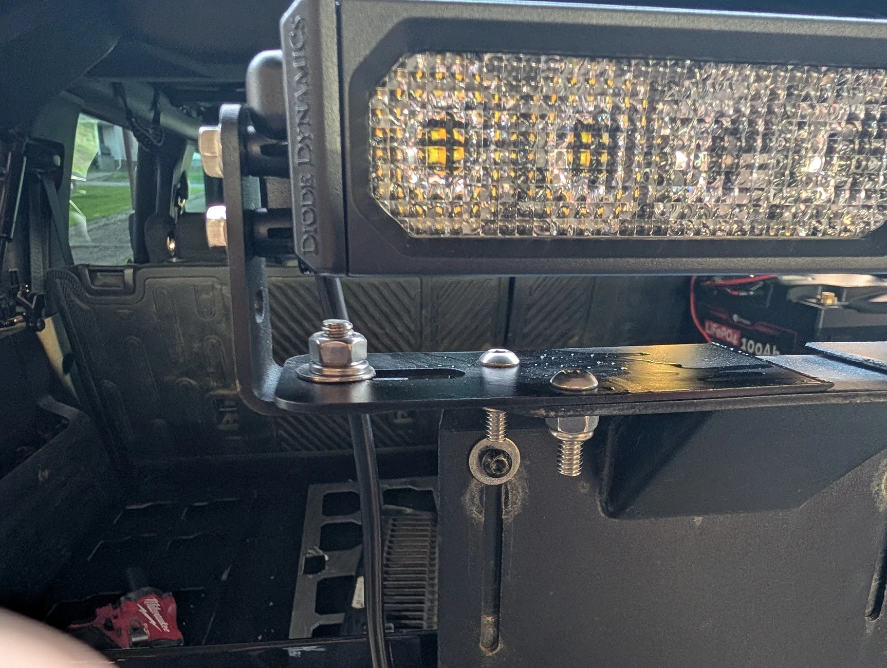

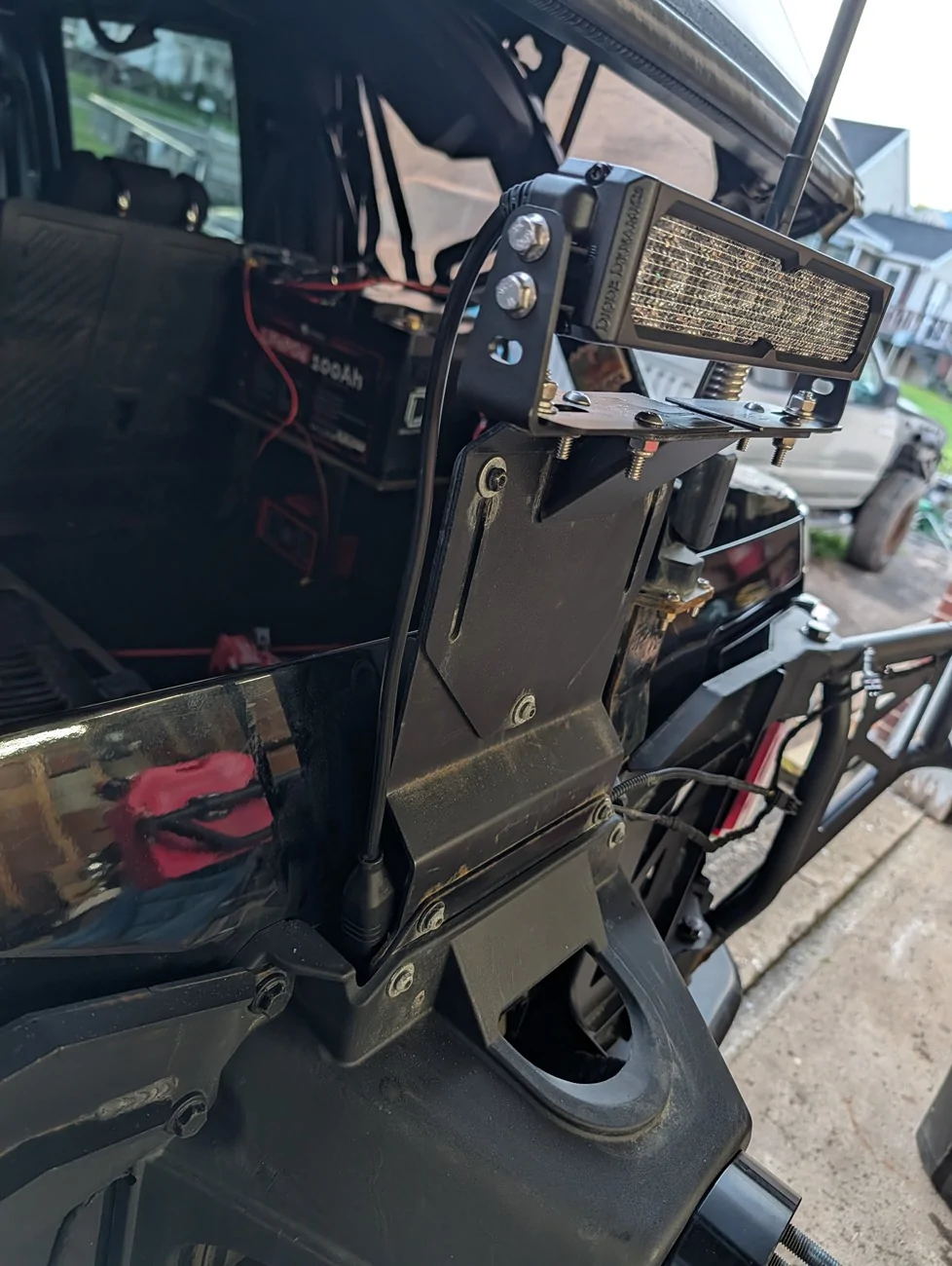

I did end up keeping their bracket to go from the tire carrier to the 3rd brake light area
Then I modified a pair of generic brackets I had left from something else by drilling a few holes to interface with the Turn bracket
Ford Bronco Diode Dynamics Chase Light Bar Install PXL_20260512_000628371
Ford Bronco Diode Dynamics Chase Light Bar Install PXL_20260512_000619224
Ford Bronco Diode Dynamics Chase Light Bar Install PXL_20260512_000623083
From there it was pretty simple for wiring, because I already had a light with the same functions, so I just removed that harness & cut my wires & remade connections with the 4 pin deutch connecter that come with the Diode kit.
It is nice that they give you a small pigtail, then a good length of cable & then the other pigtail is already connected to the light.
So if you need to remove it for some reason, you can disconnect at two different points.
