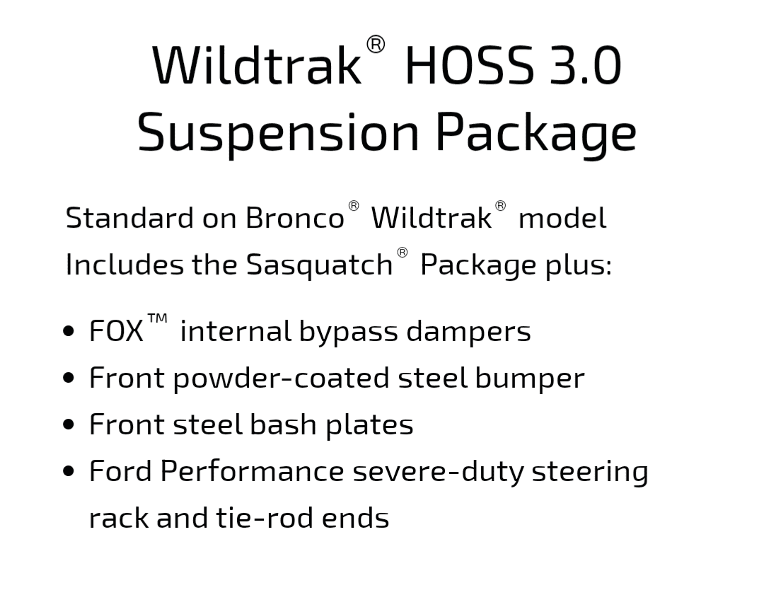

Thinking about trading our loaded 22 Badlands Sasquatch convertible with lux, etc for a similarly equipped 24 model Badlands or Wildtrack for a number of reasons. My purpose in posting is to make certain I fully understand the differences between the two trims.
I’ve studied Ford’s website extensively and it appears to me the main difference is lack of full skid plates and electronic sway bar disconnect and some minor cosmetic differences inside and out. If I’m correct Sasquatch package on both trims has the HOSS 3 suspension and steering rack. Am I correct?

The Badlands has the leather option, not sure about the Wildtrack. Badlands 24 has the HOSS 3.0 Rack which is what most people want to upgrade to. This is also the Ford Performance Tie Rods. It has the Bilstein Shocks. Badlands also has all the skid plates underneath and the disco connect. So in short Badlands is a out of the box rock crawler, and Wildtrack is a out of the box baja runner.

A BL Squatch has the HOSS 2.0 suspension and allegedly the upgraded steering rack. (I am not sure if the steering upgrade has been 100% proven)
A WT has the HOSS 3.0 suspension and the upgraded steering rack.
Edit. I just checked the Ford website and it does not specify the Sasquatch packages comes with the upgraded steering.
Thank you so much for getting things back on track and answering my question. Clearly, I missed the the info in the second part of your post when I was perusing Ford.com.
I’m also fully aware of the sas / non sas points of view. Like most everyone else, my mind is made up on that issue. I’m also knowledgeable on 74Weld’s steering product line.
In my case it boils down to this, it’s relatively easy to find a loaded Wildtrack equipped and in a color we like on a dealer lot within a reasonable distance. Not so much for a Badlands. I’m not ordering and waiting again. But the issue giving me pause is lack of electronic sway bar disconnect on the Wildtrack. I use it a lot in the kind of wheeling we do, but I’m not certain it’s a absolute necessity.

You can also add the badlands electronic sway bar to the WT, and not integrate it with the GOAT modes fairly easily. Just hook to an upfitter switch to disable/enable it. I've seen several posts here about people who have done it, and a few YouTube videos.
