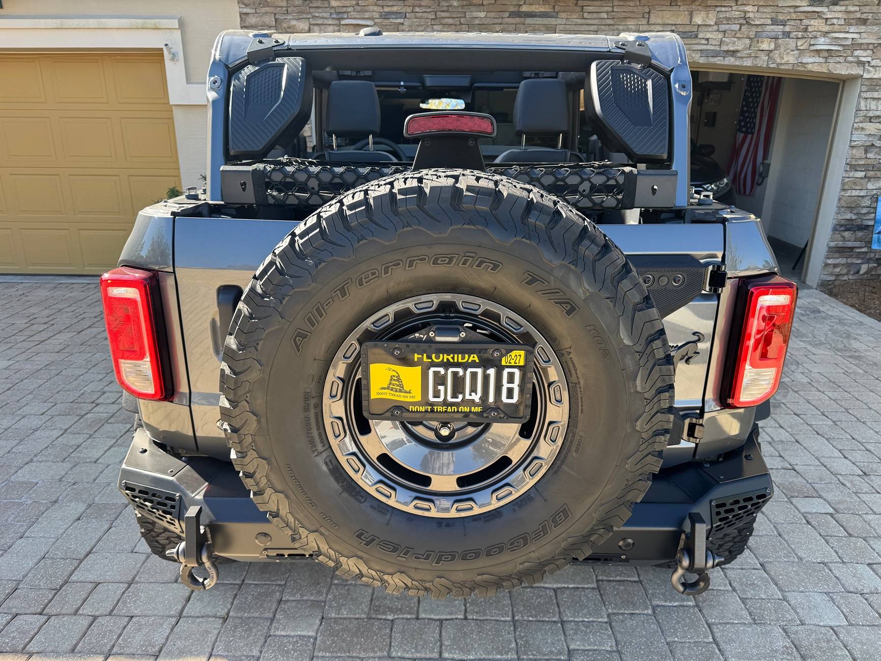

I have a non sas black diamond that I’ve swapped out a lot of the parts on with Sasquatch parts on (yes I know it would have been cheaper and easier to just buy the package in the first place). My question is what is the difference between the 3rd brake lights? Mine fits the sas wheel and tire but just barely and it’s pushing up against the light. I see sasquatches have a small gap. Is it a different light all together? I bought the rough country 3rd brake light extension but it’s too high and the gap looks funny. Would like the light to sit right where the sas light sits. If it’s a simple light swap the part # would be greatly appreciated. I’ve searched and couldn’t find. Thanks in advance!

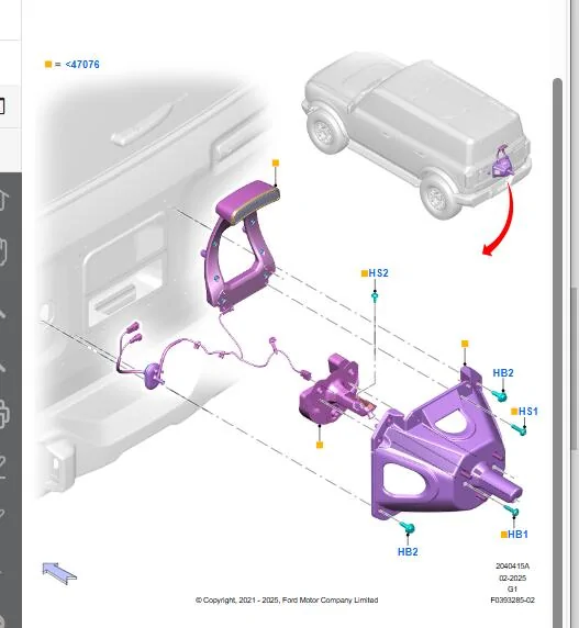

The whole rear tire carrier is different............
Notice that the square next to 47076 is next to all the big pieces in the picture,that tells you that they only come together.

The squatch brake light bracket is taller than non-squatch and not available to purchase separately AFAIK. Most of the extensions that are available aftermarket are to fit 37s is why you have a big gap. Numerous people have done the rear tire delete and may be willing to part with their squatch bracket...maybe post up a wanted to buy thread in the for sale section.

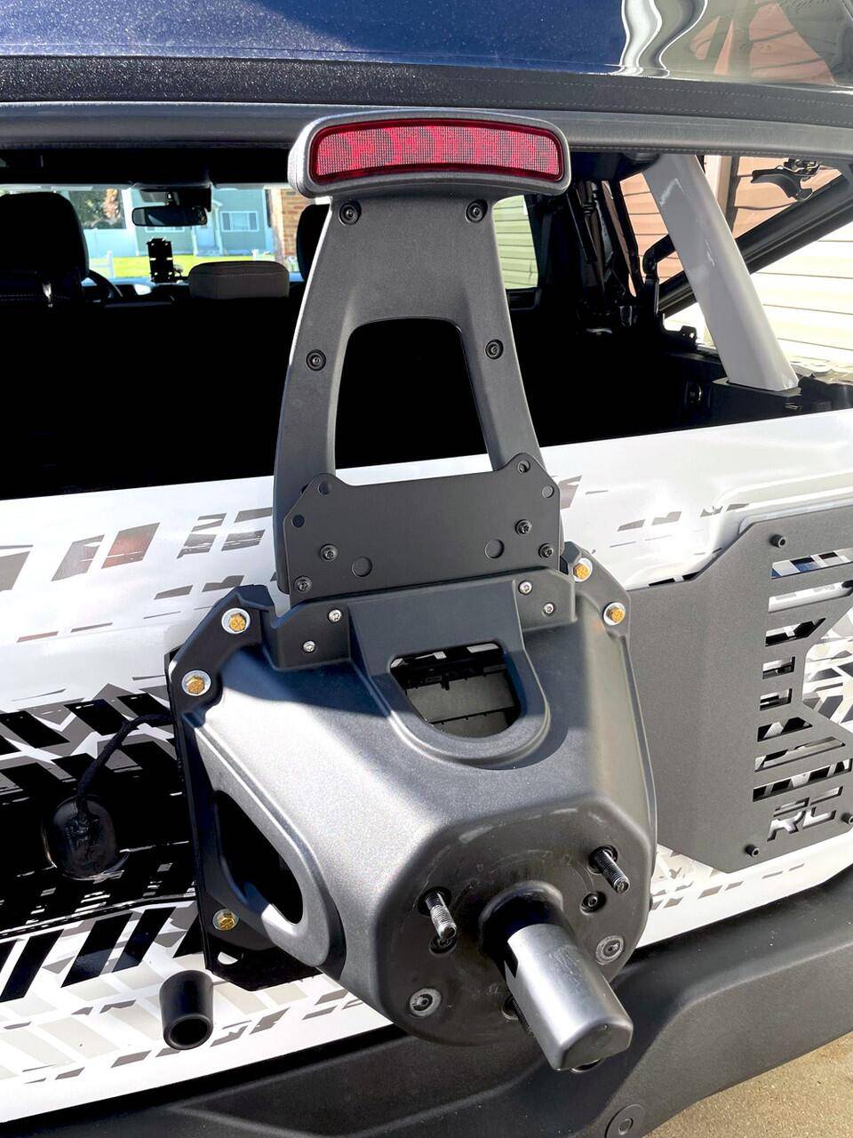

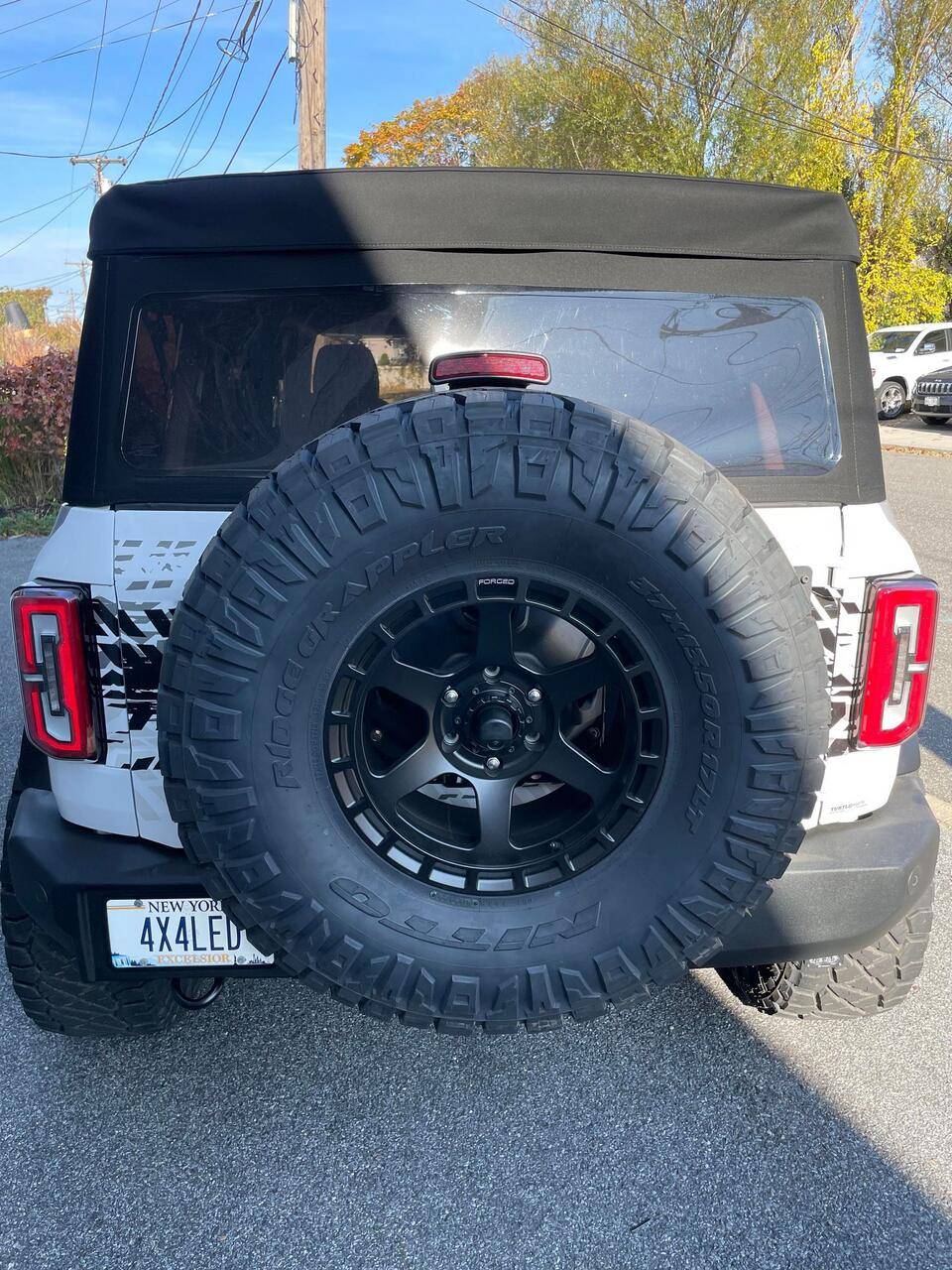

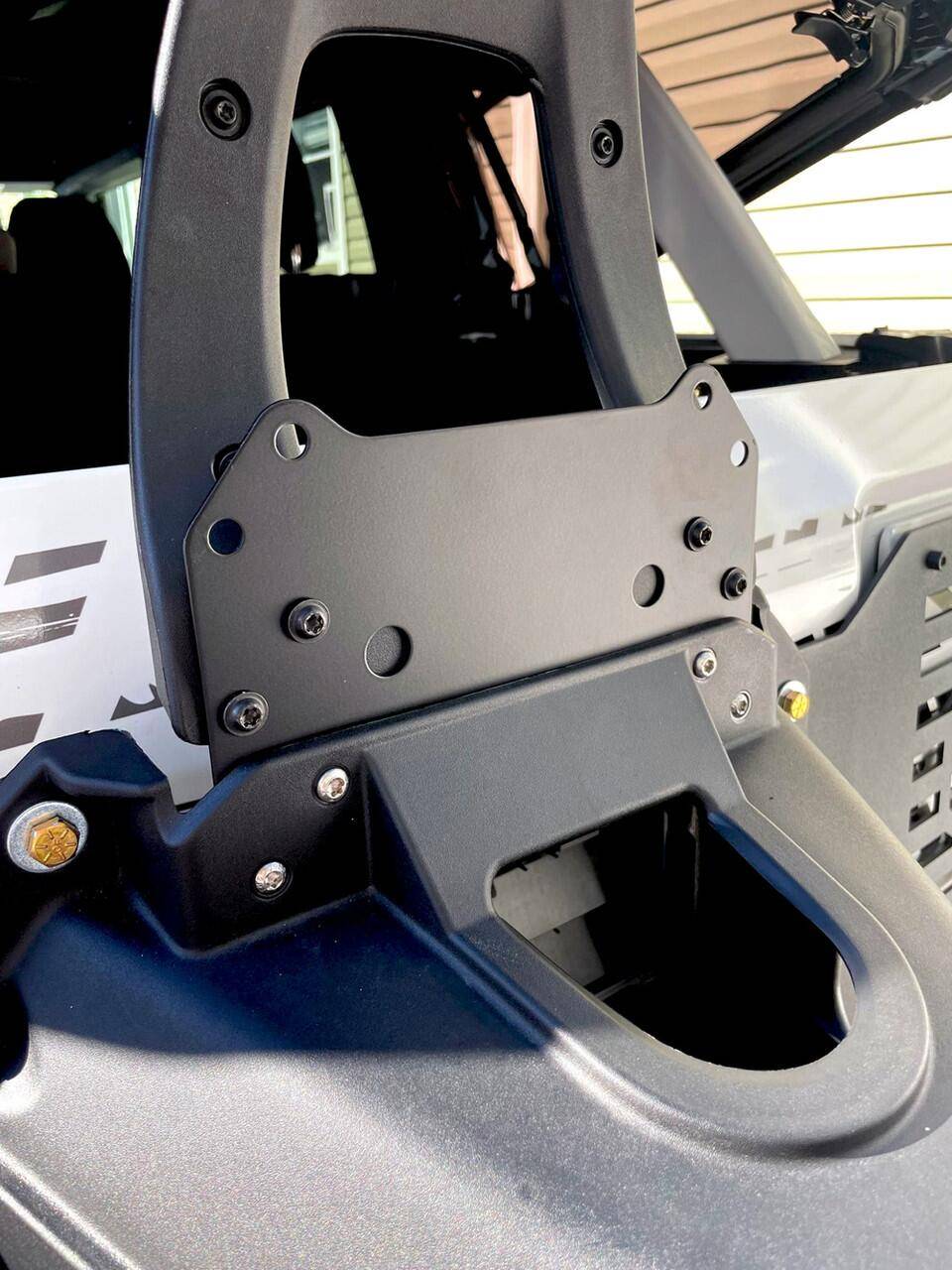

When you put larger tires on a non-sas truck you'll need a brake light extension. We sell them here:
https://www.4x4truckleds.com/kr-off-road-3rd-brake-light-relocation-bracket-for-2021-ford-bronco/
Made here in the USA from Stainless Steel.
Here is the brake light with a 37" tire on the back

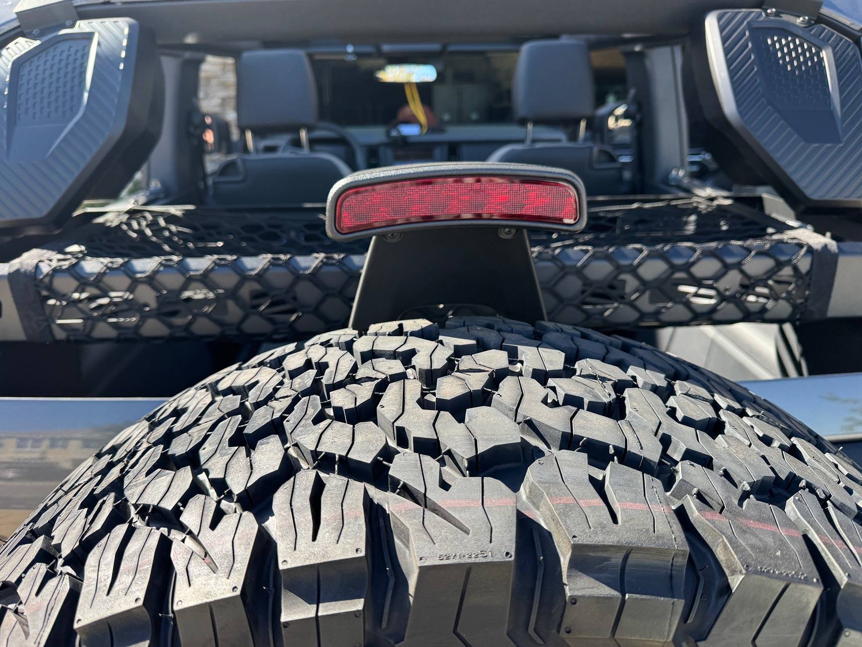

I have the Havoc extension with a 35" tire. It's ok for now. Kinda like the Turn Offroad one that has the chase lights but it's pretty pricey for what it is.
