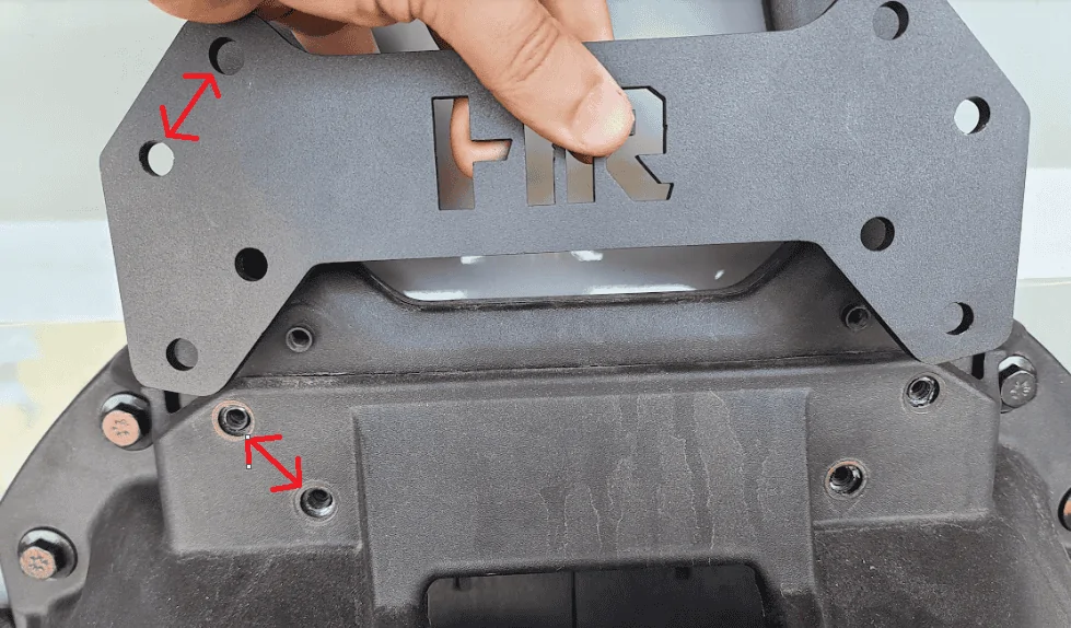

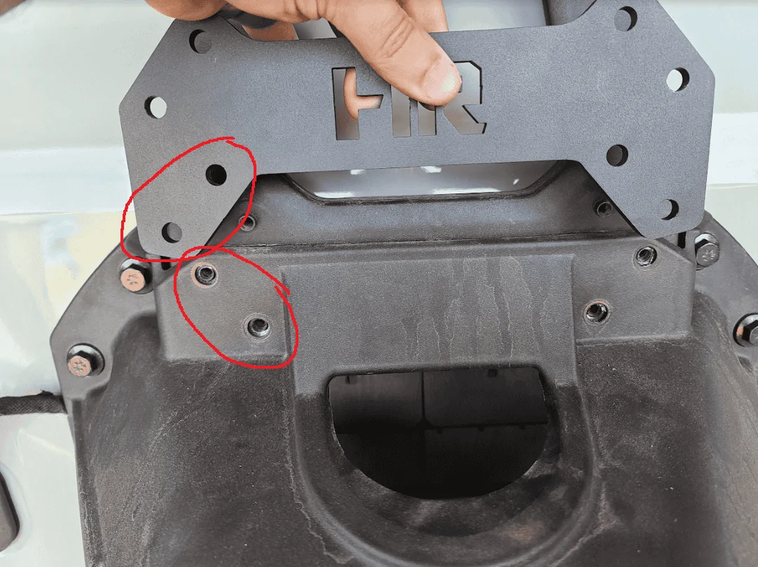

Yeah, ideally you'd like to use 4 bolts on the bottom. But if need be ours is longer so if you only use 2 you've got plenty of height. But you should be able to use the 2nd and 3rd set (opposite) on ours since it's backwards, so to speak. Know what I mean? Basically skipping the bottom holes and starting on the 2nd row for your bolt pattern since your mounts are opposite.
But we made ours longer so that you could go even bigger then 37's and have clearance. Although it'll start to wobble a bit the higher you get.

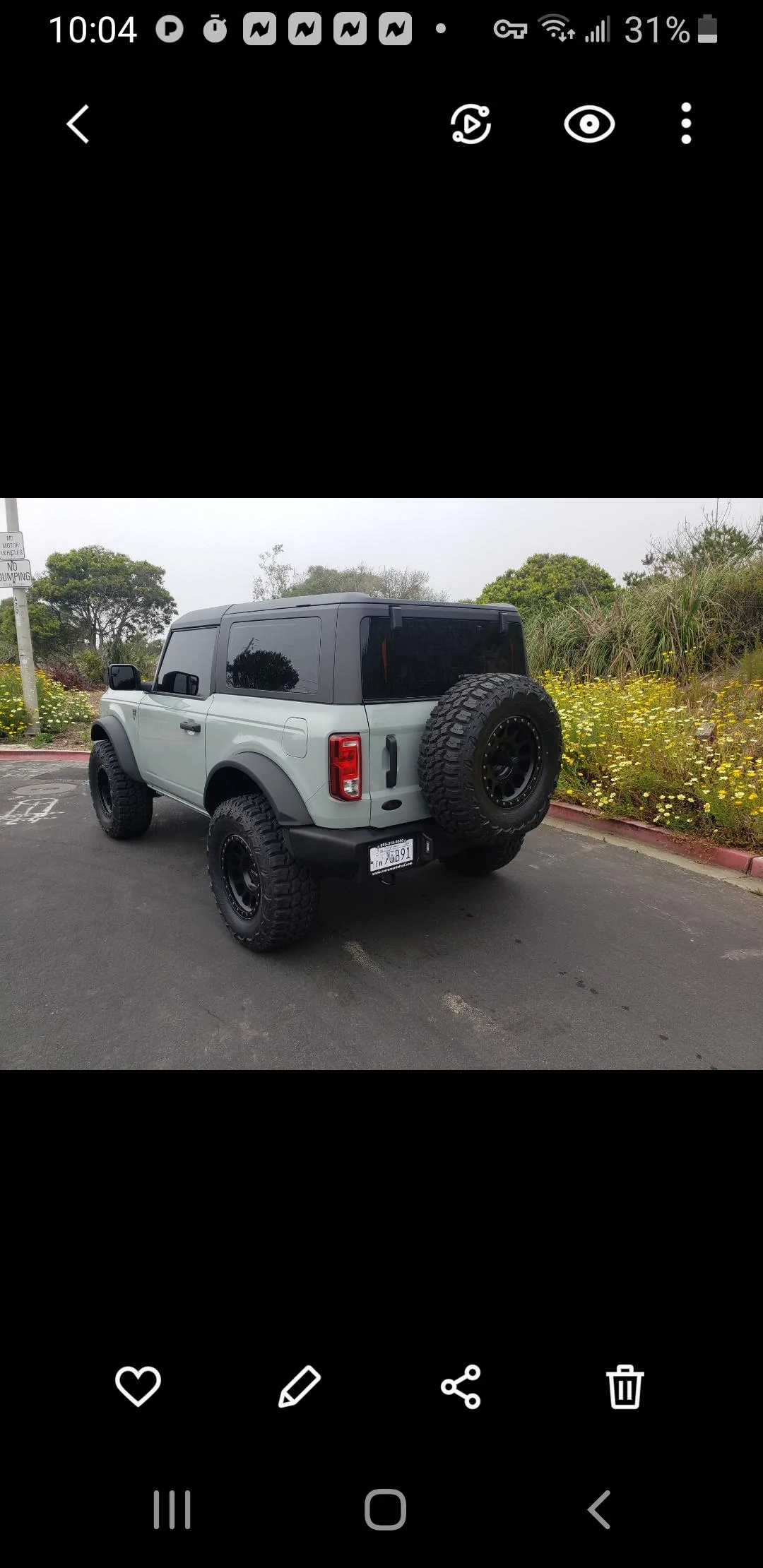

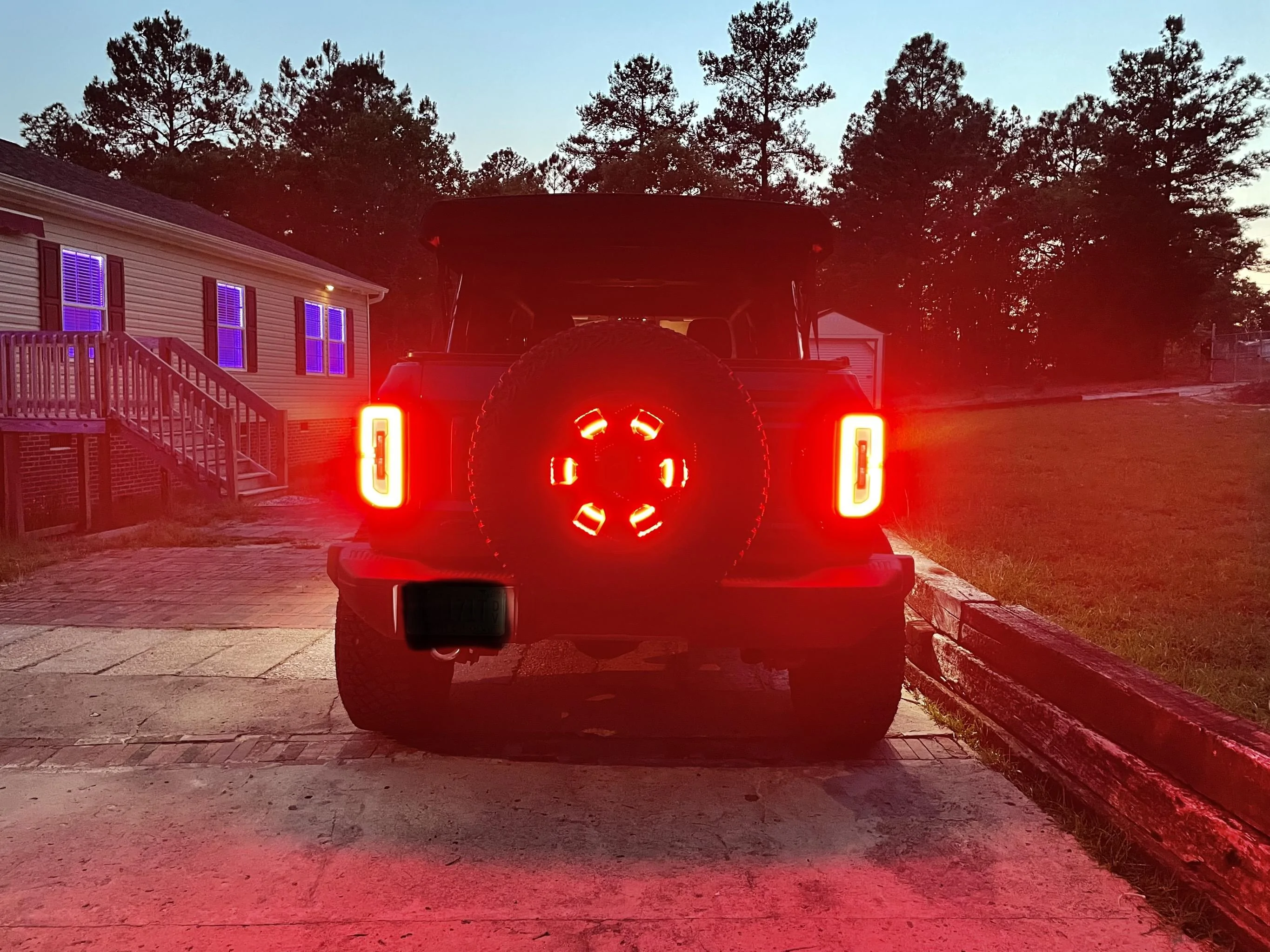

2nd day i yanked that light off and installed a led one for a jeep,I had to Redhill the bolt pattern (easy) and because it was for a jeep no bronco tax.

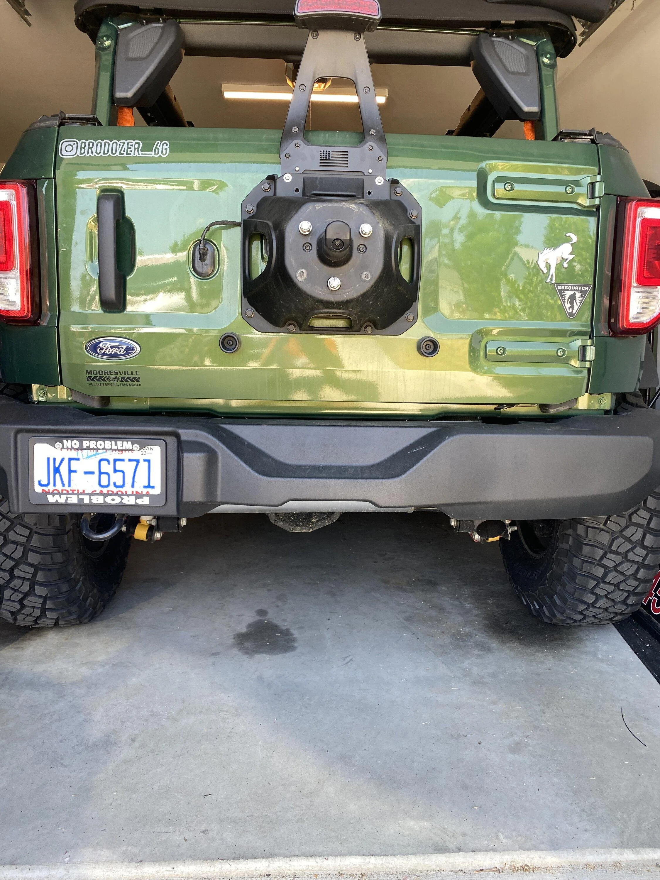

My state counts the rings as factory “equivalent“ and it passes jnspection.
