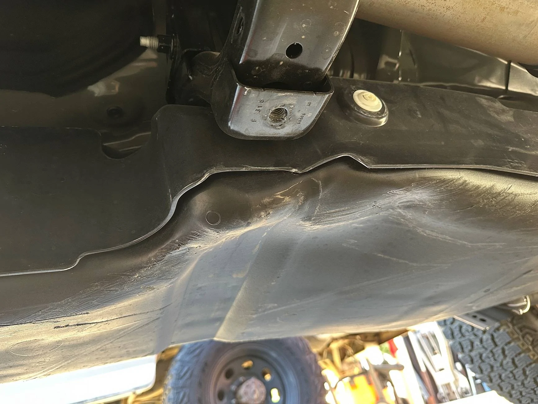

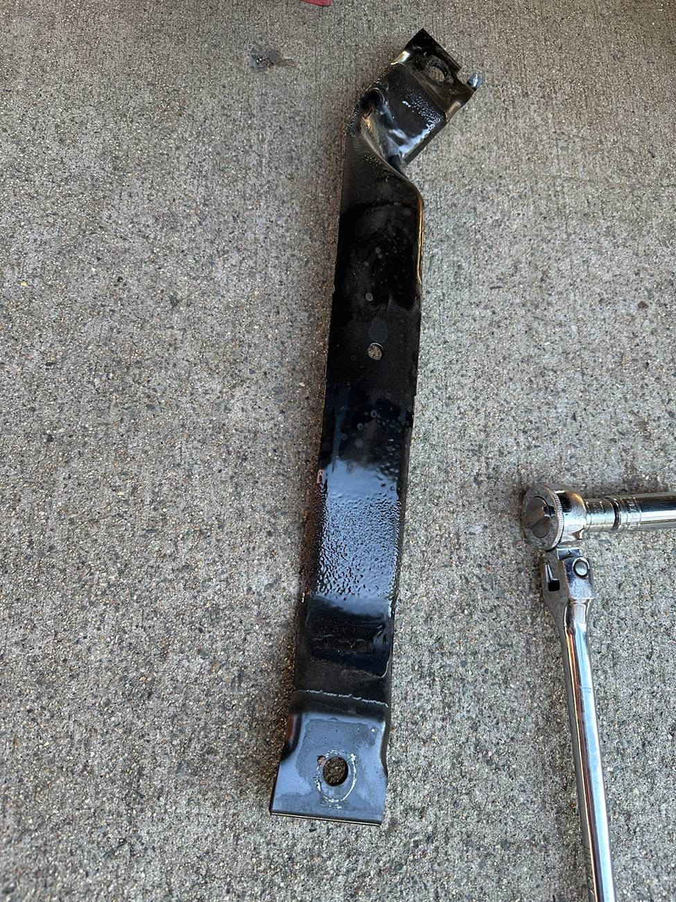

Finally got a few hundred miles on the new BaseSquatch, and so I took it out to the desert and high centered on a big rock to, uh... test how strong the gas tank is. I'll go with that lie story.
It passed the test, no leaks. Plastic is really strong. Bonus: my tank still showed full when I got back.
Any ideas how to get the dent out? I though it might just pop back once I removed the bracket, but nope.
Also, where is the pickup located? Front, center, back?
The pump comes out the top. Remove the tank, pull the pump, rig a plate with a hole and use air pressure to push out the dent.
