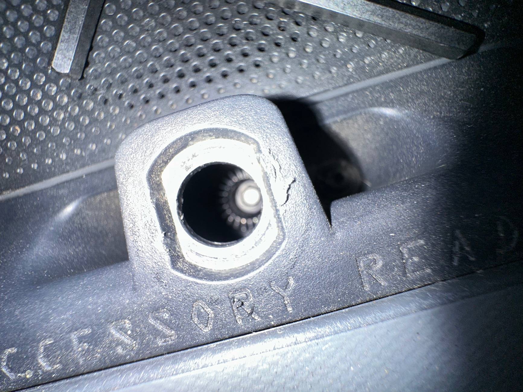

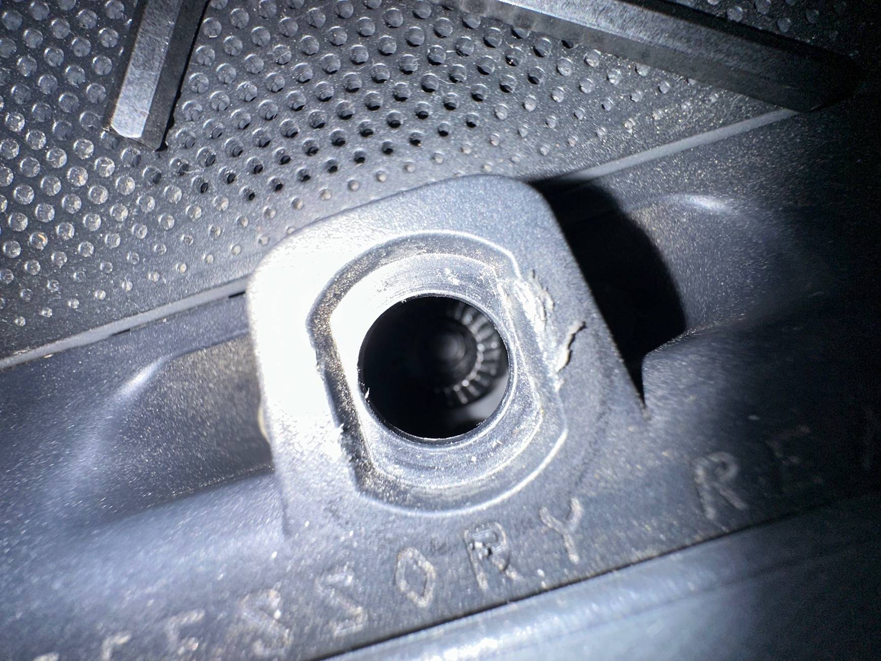

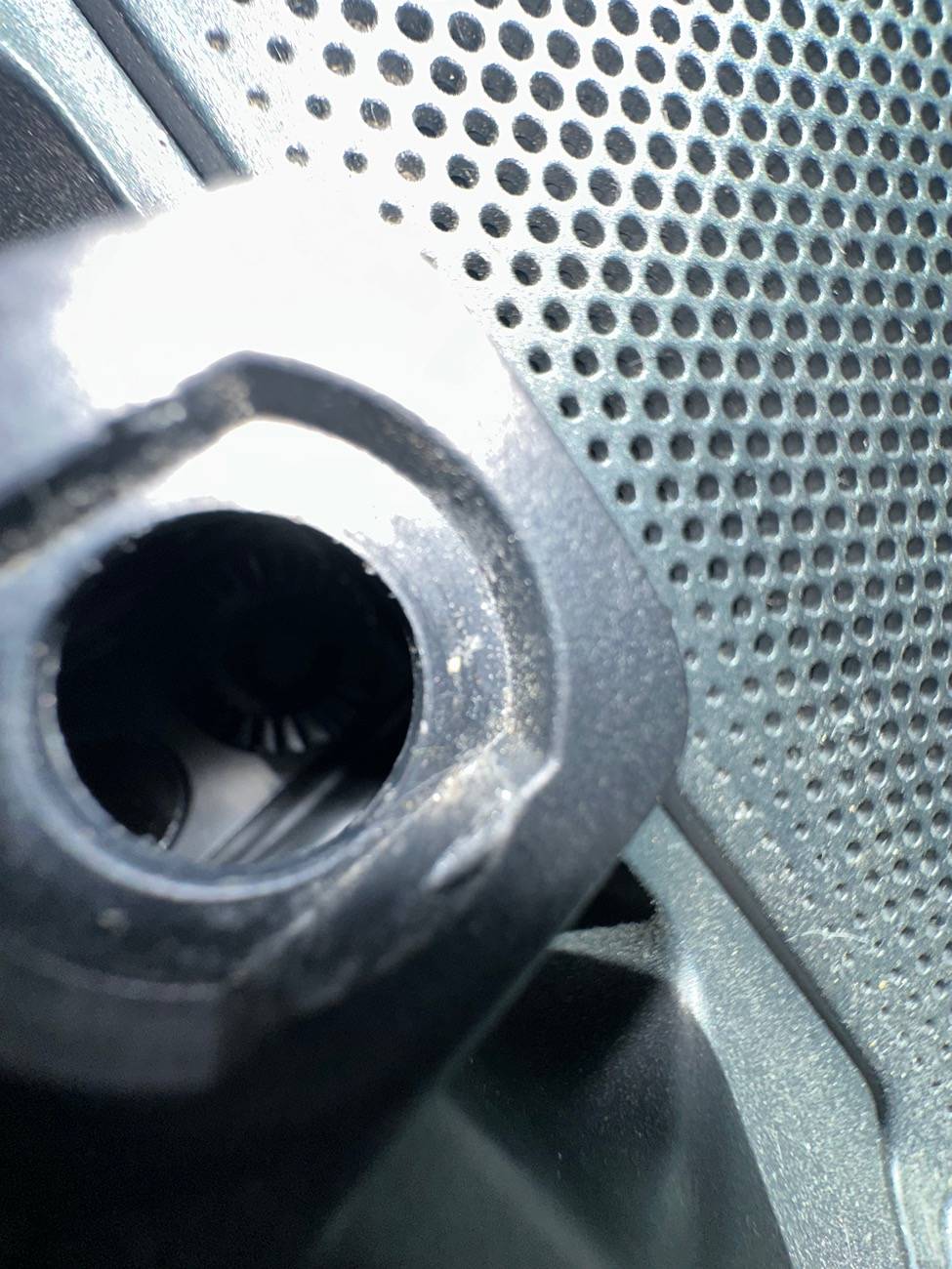

I had a phone mount that goes into the center dash part behind the emergency lights/lockers button. One day I adjusted the angle of my mount and it plopped off. I can’t get a good look inside to see if something broke or fell into the little well but I’m aiming that’s what happened because the mount is no longer attached to this part, lol. Anyone else encounter this or have ideas to remedy?

The assembly is accessory ready--which means it simply unscrews and comes right off. Might be fixable, is easily replaceable.

To me it looks like the nut backed off of the mount. You should be able to pull the whole mounting assembly via the 2 screws and put the nut back on.

What he said, but be prepared to go in with a long magnet on a stick to get that loose nut, it wants to fall into awful places.
