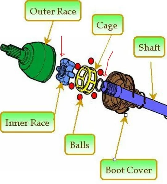

I think the big issue here is the installation. There requires a ton of extra suspension travel to clear the lower and upper studs on the OEM strut. Most other setups with the lower bar-pin have removeable hardware and don't need to clear them to remove.
Drooping the suspension farther than it should, by a large margin, will exceed the plunge designed into the axle shaft, making it come loose from the CV (inner or outer CV). The shaft can be pushed back in, but would be something that should be done on a bench, not in the vehicle as it requires some disassembly to check that it's reseated correctly.
Sometimes the retaining clip is a spiral clip and the CV itself needs to be disassembled to remove the shaft (930 or racing type CVs). Alot of times, for OEM stuff, one or both of the clips, are a spring clip. Pull hard enough on the CV and it'll come apart. Ease of assembly and repair.
