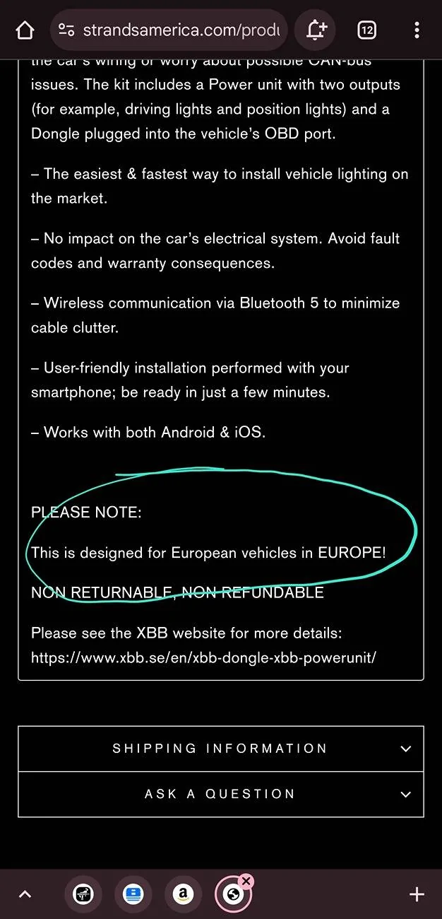

@Nibroc99 Not sure why you are having trouble finding the XBB online, I posted a link to it in this post earlier: https://strandsamerica.com/products/xbb-obd2-kit-xbb-dongle®-xbb-powerunit®-1
As far a I know the only US seller of that device. I've had mine installed for months now, and it works exactly as desired. Brights turn on, it triggers the power relay, and anything powered off that relay turns on too. Working well with auto-highbeam as it flicks on and off. I still haven't found anything quite so plug and play easy, so while feels overpriced, it does as billed.
I must've missed that earlier, my bad! I do see that it says "for European cars only" on the webpage too, but I assume that shouldn't matter? But yeah, definitely a hefty price tag. For now I'm actually in the middle of hooking up a 5 pin relay to my fog lights and AUX 1 switch lol.
My guess is as that's a CYA for the seller since brights-plus-fog/other-lights is a no go for in many if not all US states. The relay works on a 12 V system, so it will work on Bronco.
Guessing that is a liability statement, but works fine on my Bronco and few others on this forum that have it. I think I had to select Ranger as my vehicle type in the app to configure, but guessing headlight signal is pretty much common across the ford lineup on the CANBUS.
