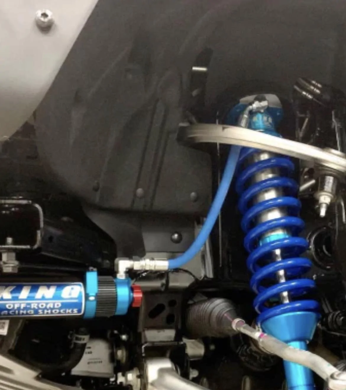

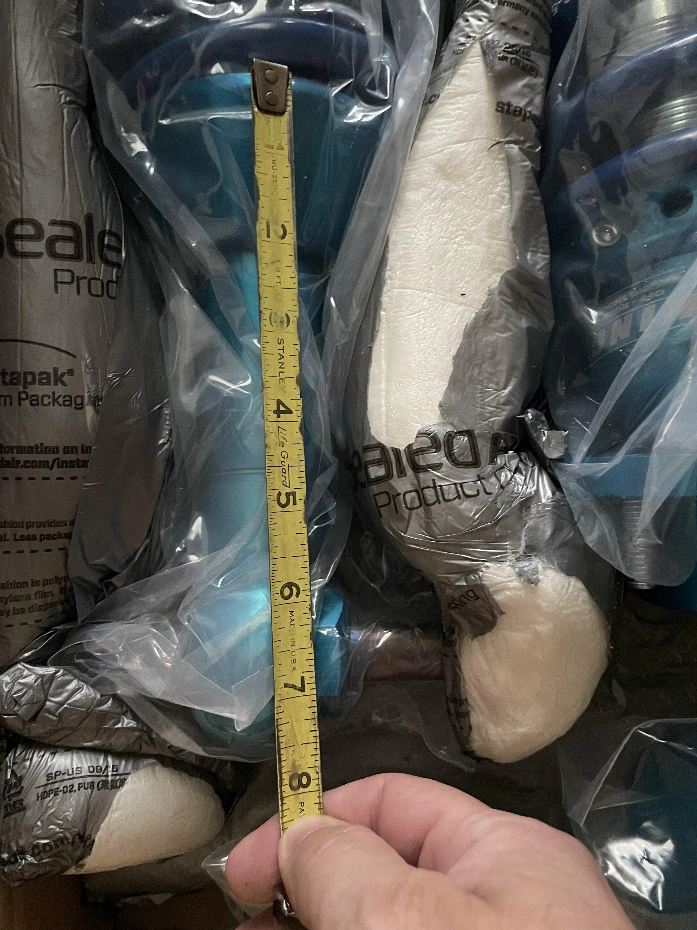

Little bit of a weird angle but you get idea.
Just received my King setup.
For reference, their lower cup is about 7”. A full inch higher than the Icon setup.

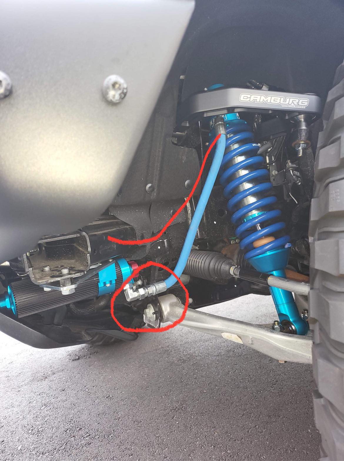

I would recommend checking your hose direction before you mount. I had mine mounted and now I have to have them removed (+$500) to have king turn the fitting locations because the hoses are too tight.
If your hoses measure 17.5" end of crimp to end of crimp check the rotation of your reservoir before having them installed. King was super helpful but they aren't going to pay to have them removed again for the service.

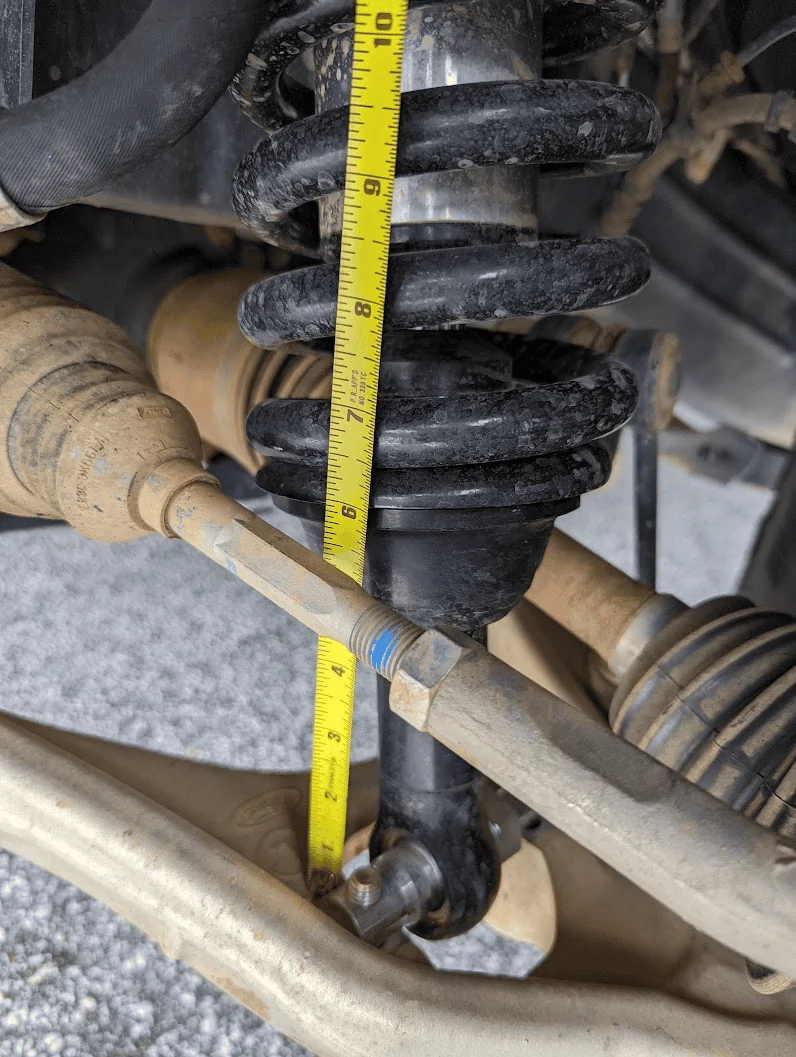

Have you tried rotating the reservoir with the fitting on top? Too much twist in the hydraulic line?
