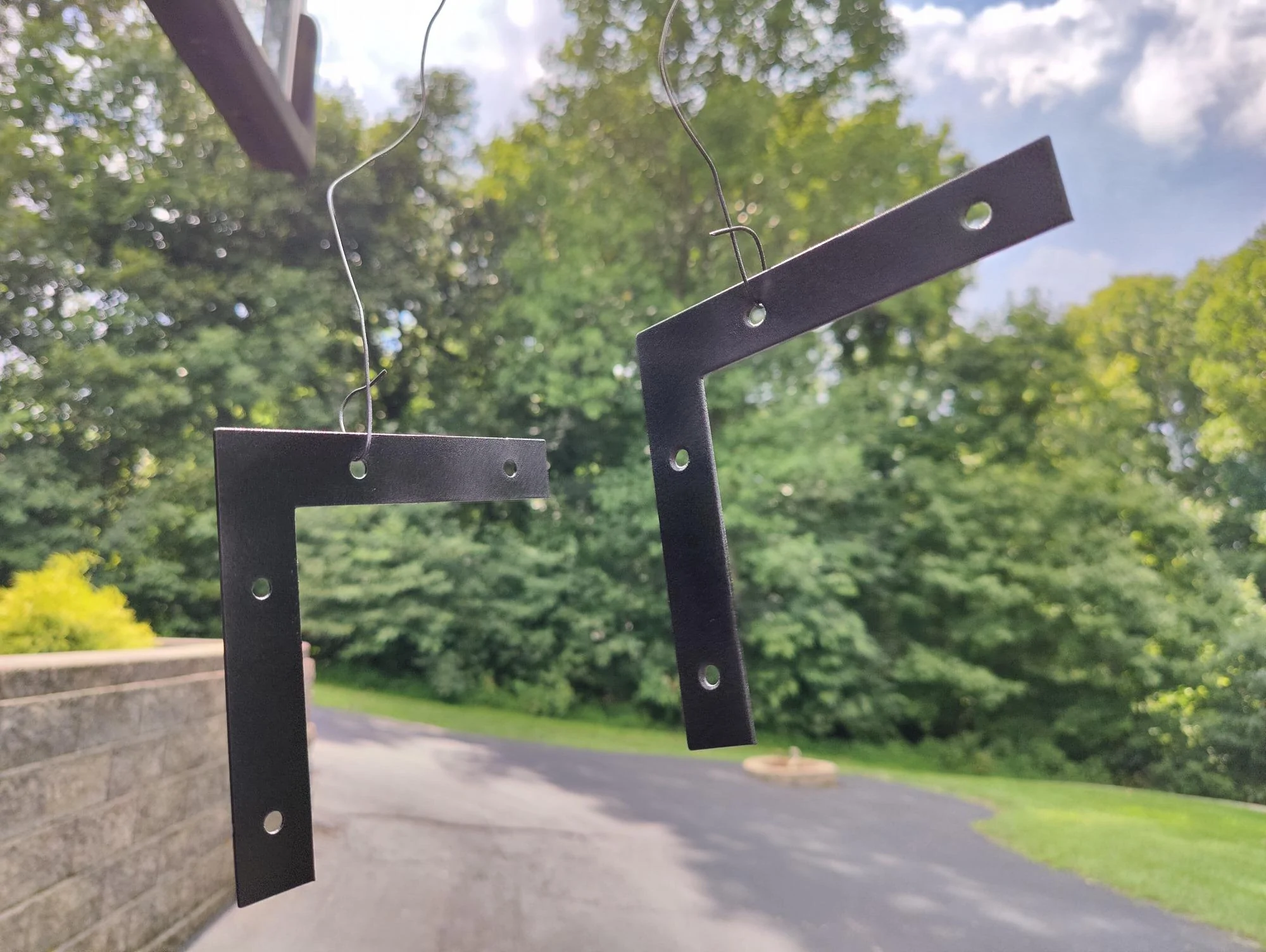

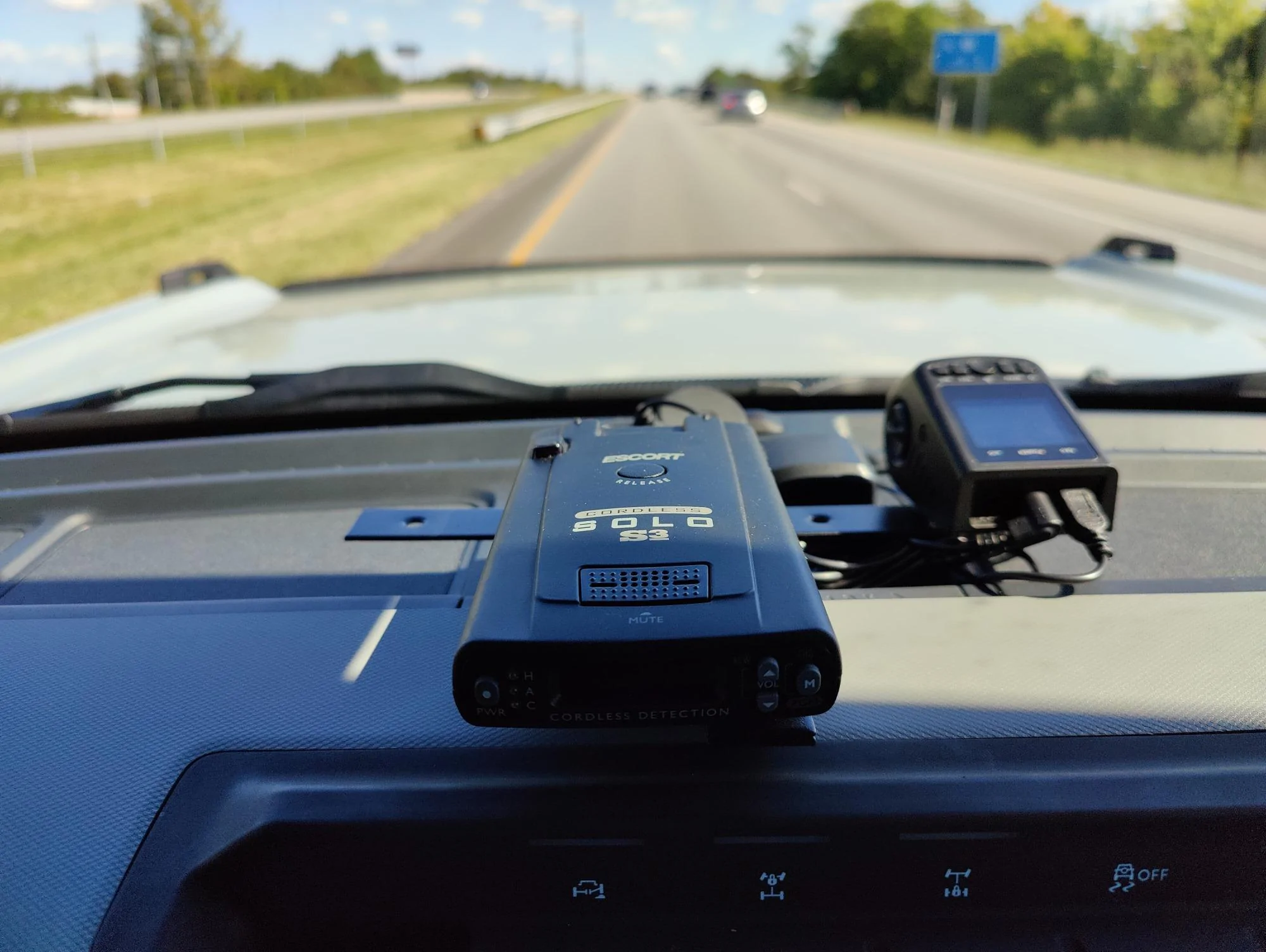

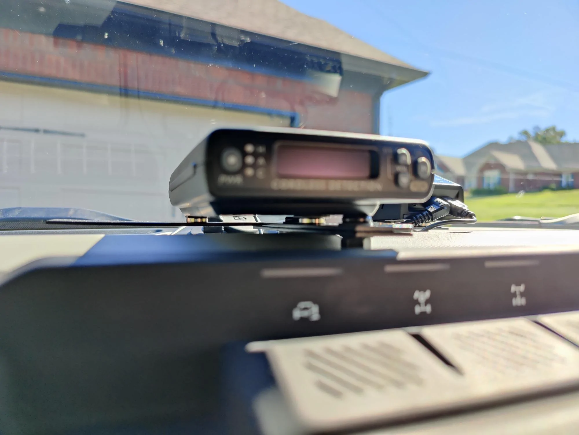

Here's my mounting solution, although I have a headstart with a cordless Escort S3. Detector and dashcam held via two magnets each onto two 5" L-bracket plates bolted together into a T.

Isn't that a bit low for a radar detector? I was always told to mount it as high as possible on the windshield.

Not necessarily. These radar detectors claim to receive laser and whatever beams from sometimes miles away. There's no way you're always in line-of-sight when you detect a signal while moving on the road. I imagine that the lasers and beams are bouncing and reflecting off of every surface, including the Bronco's massive hood. The Bronco is already high off the ground compared to the highest point in a car's windshield. Hey, maybe my detection distance performance is degraded by 20% where I've placed it. 20% reduction from a mile is still a long enough distance for me to slow down.

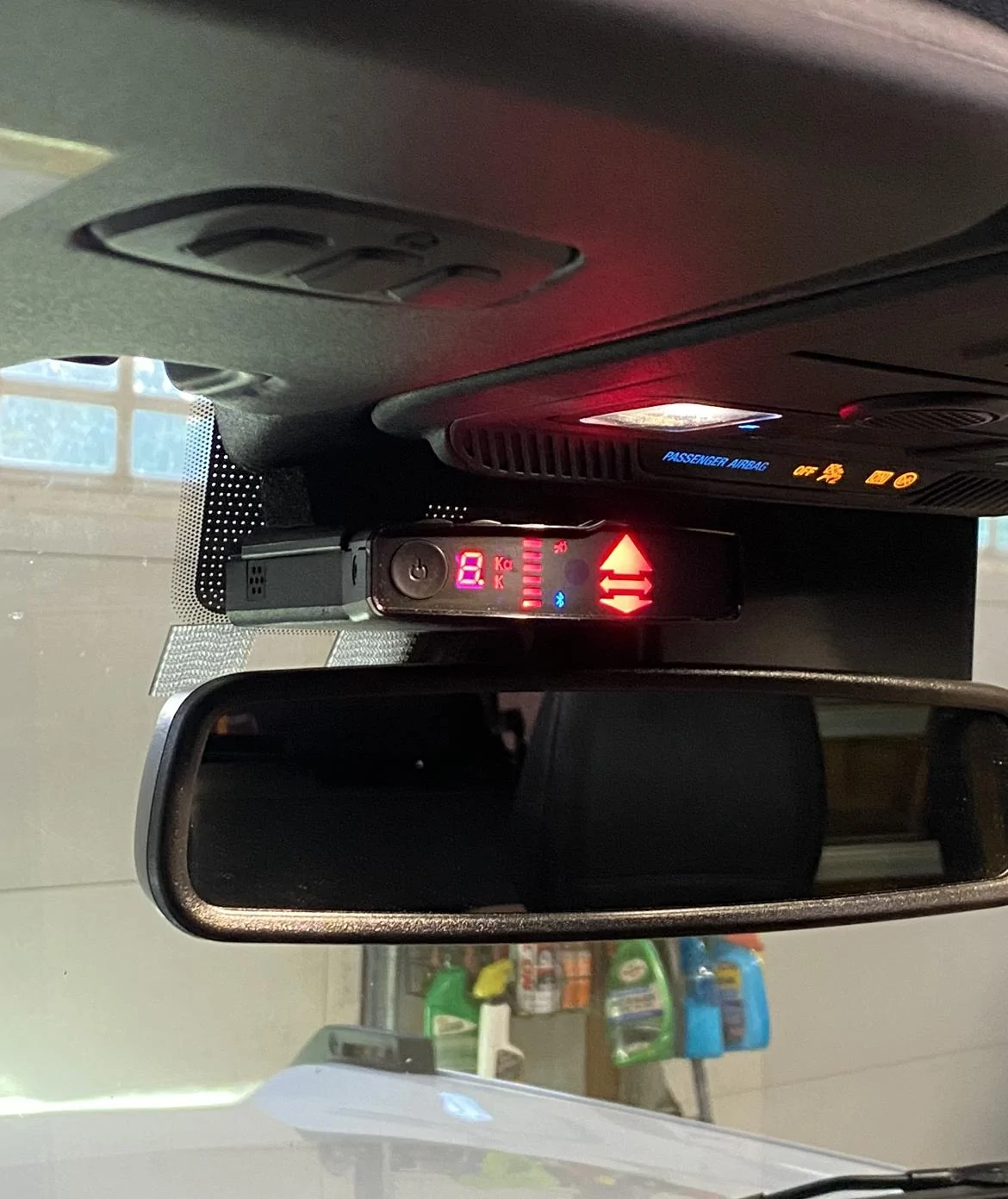

I installed my Radenso DS1 in the Bronco back in October, along with a VIOFO A229 camera. I went to the fuse panel with hardwire kits for both. I used heavy duty velcro on the overhead console and had to make a 1/2” spacer to clear the downward bump with the airbag light. The DS1 has a 1/4-20 screw insert on the top, so the spacer is secured with a screw rather than adhesive. The detector is high and tight and works great. The black dots on the windshield are non magnetic paint that “according to youtube experts” doesn’t affect the signals reaching the detector. The only drawback to this setup is that this hard velcro doesn’t come off without some sort of pry tool, so I keep a plastic trim tool in the console. Quickly removing for a traffic stop might be a challenge.

Very nice. I’ve got a V2 in mine. Mounted with a visor clip going behind the plastic header trim along the top of the windshield. Had to shim it with some foam but came out slick. I didn’t do a mirror tap just ran a wire from an add-a-fuse from the box behind the knee board.
3 Day old Bronco after over 1000 waiting (had two use reservation or loose it) so have not accessed the knee board or trim pieces. Also have the V1G2, glad to see that the windsheild black mesh paint didn't affective performance... looking to do the same exact mount, glad to hear it is working well!!!! No problem with the visor mount, were you able to bend the visor mount as opposed to shimming? Also, did you use the V1 hardwire kit or other wiring harness? Was it easy to run the wiring up the side from the knee board, assume you had to remove some plastic panels to go around air bag?

The install is clean but the radar is too far away from the driver to mute, lock out annoyances, etc.

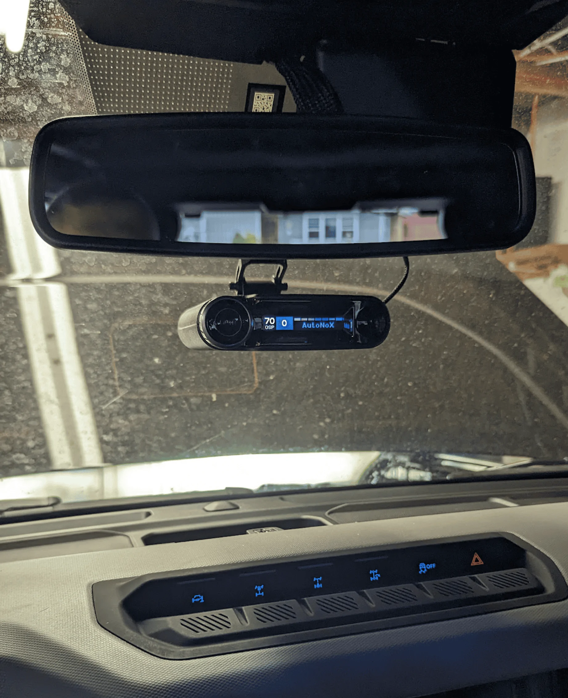

here's mine. Blendmount, Dongar mirror adapter, usb to rj11 adapter, and an Escort MaxCam 360c with integrated camera. the above the mirror installations seem like detection would be more negatively impacted. it's easy to pop off and lock up when i got the top off as well.
