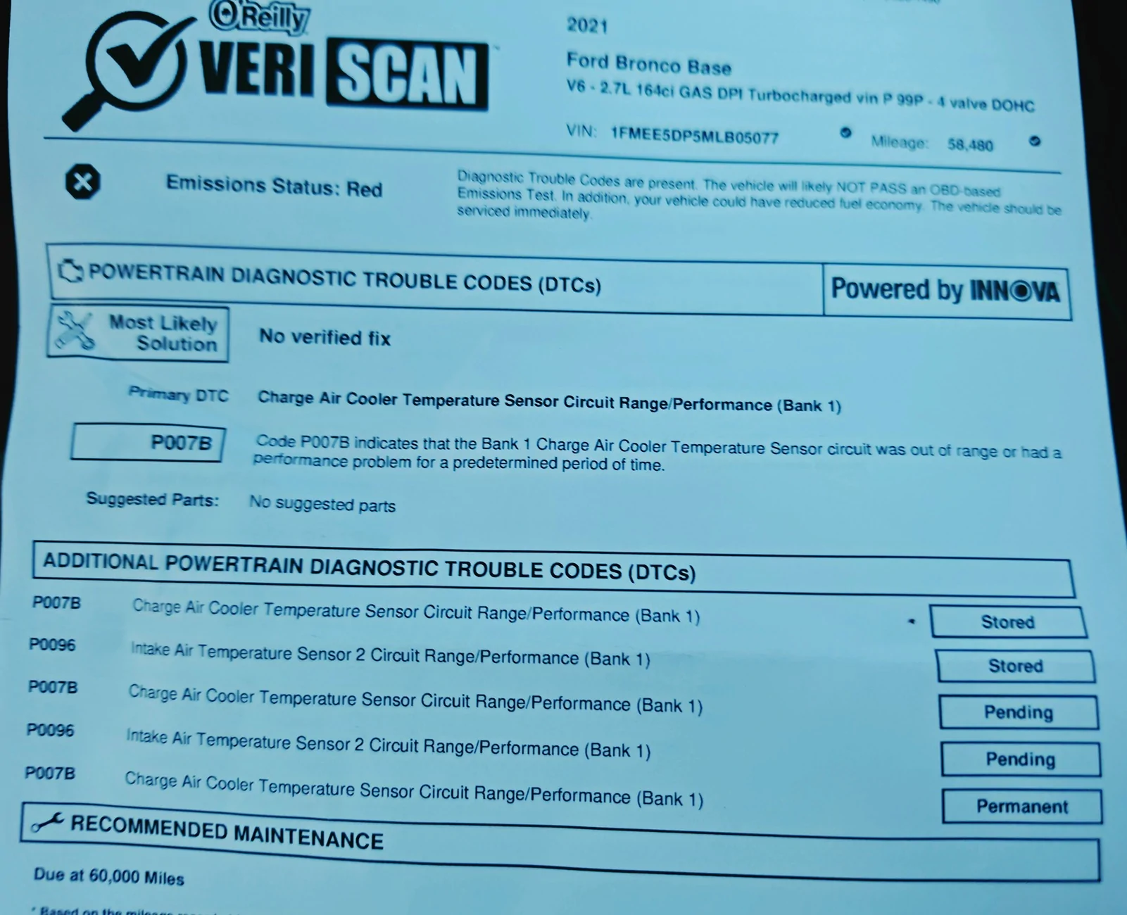

First day of 3k mile road trip to Utah, Colorado and Idaho. My check engine light came on. I stopped and had an OBDII reading.
Water, oil and transmission temps are normal.
Can this wait until I get home in 4 weeks
Ford Bronco Check engine light on 110640

That makes for a few options. No rough idle or acceleration problems. I wonder if my extended warranty will cover this. Did 500 miles today at 80mph. Ran great

Wrong code. It’s P007B

The report said no parts were needed. Is this something a Ford dealer could repair in a day

If the intake is not blocked I am betting on a dirty sensor.
That report is just generic information. The fix depends on the diagnosis.

Just curious; What temp was it outside, and what altitude ?

I’m not sure if the ECU adapts quickly to significant altitude differences especially over a short period time.
It adapts faster than the Broncos can change altitude or the temperature can change or both.
