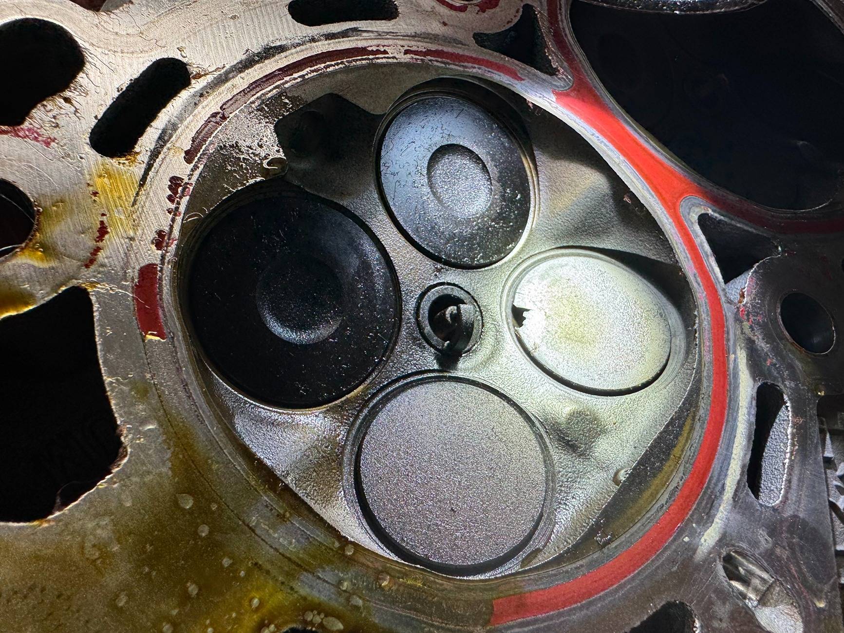

in case you're curious - spent about 20 minutes with the tech in the shop Friday.
Ford Bronco Check engine light flashing - Cylinder 6 low compression image0 (4)
Spooled
Mar 3, 2020
1,983
6,862
Republic of Texas
Raptor, Model 3
definitely looks like a burned up valve to me.
I wouldn't get a warm and fuzzy feeling with them just slapping on a new head and sending me on my way without a proper root cause analysis.
Agreed - Ford comped me 36k miles of their premium warranty so i have that through 88k miles. I'll be making a decision over the next year as to my future with the Bronco (and ford maybe). Time will tell.
