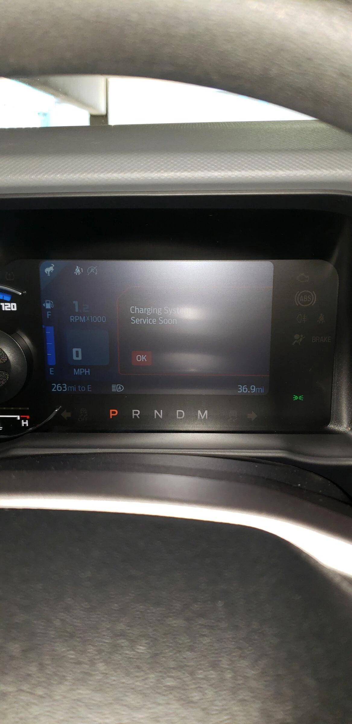

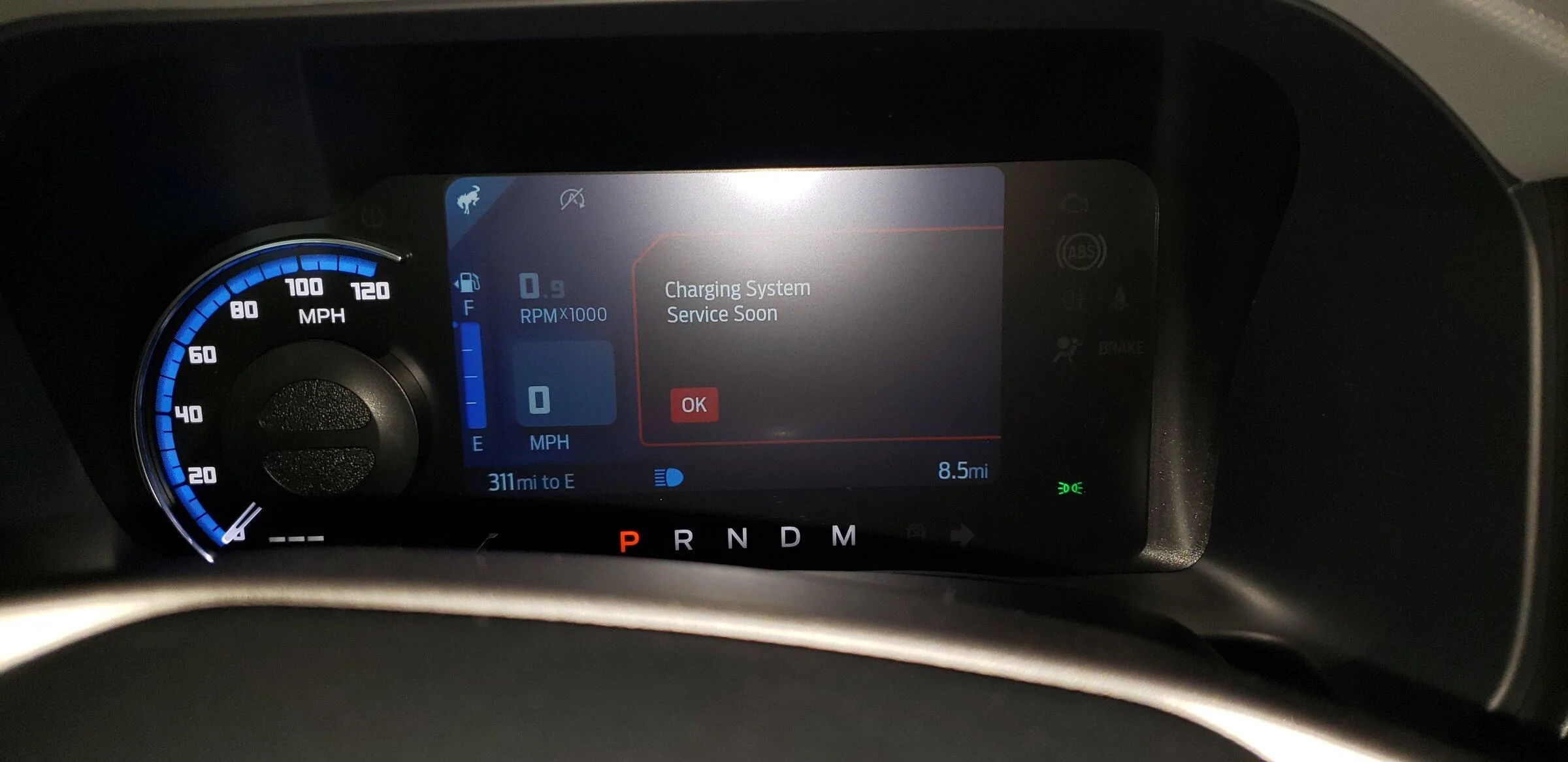

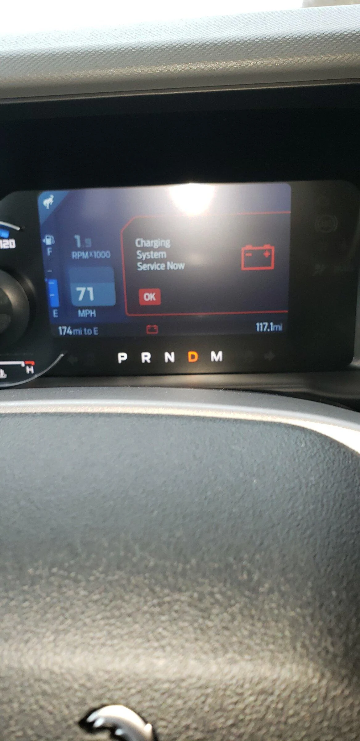

Hello! Just received my 2 door base model 2022 Bronco yesterday (2.3 -automatic). I ordered it at the dealership mid-December 2021. I received a call and a text that the car had arrived. I was unaware of the status because I received no communication after I built in at the dealership. I was surprised to get a call because the estimated arrival date was summer of 2022. I got home and pulled the car in the garage and noticed the charge system fault warning on the dash board light up. The car has 8 miles. I drove the car home, straight from the dealership. It's quite disappointing to have to figure out issues with a brand new vehicle. I researched the issue today and how I should proceed. The dealership service shop was closed so I scheduled an appointment online. The first available appointment is April 27th. I'm not sure if I should drive it until the dealership examines the issue.
Update: Took it for a long ride and I am happy to report that the Charge System Fault alert has gone away 😅. I'm hoping that this isn't an off and ongoing issue. Thank you all for sharing information and providing sound advice.
Yesterday I was able to take the bronco to the dealership...here's the results. I'm hoping everything has been resolved.

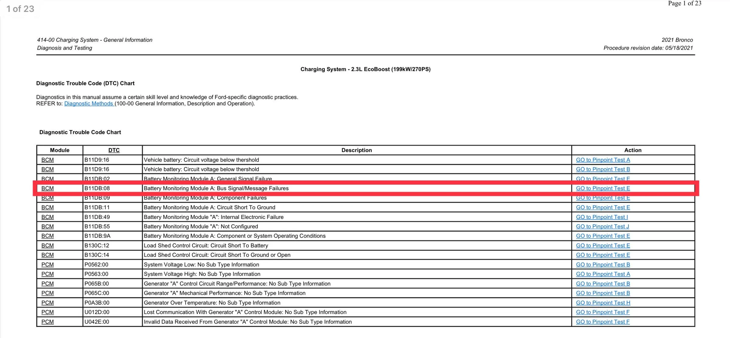

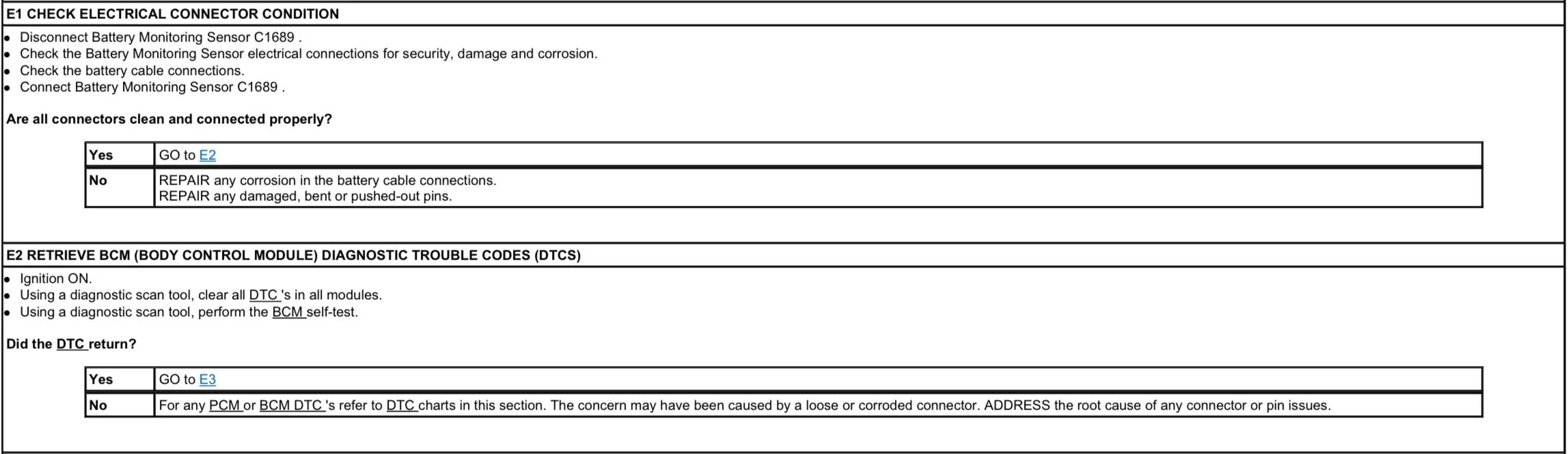

FYI only. Attached below is a copy of the Diagnosis and Testing section of the Technical Service Manual for the 2.3L charging system. It's very detailed. I don't expect you to completely understand all of the topics covered, but reading through it may help you understand the types of things that your dealer might check.
Thanks for posting the service technician’s write-up. 👍
Congratulations! You got an experienced tech who followed the Diagnosis and Testing section of the Technical Service Manual carefully and documented his work. This is necessary for the dealership to get warranty reimbursements from Ford Motor Company, but it also benefits you, because it provides you information about the work that was performed, and it preserves a record of the diagnosis and remedial actions taken, if the problem ever reappears.
Here are the relevant sections that your tech followed…
Ford Bronco Charge System Fault With Only 8 Miles 35267F5C-06C3-421B-9B2A-7D0D6F7DFE6E
Ford Bronco Charge System Fault With Only 8 Miles 51F97688-6347-4297-BCA2-CABFFABFF5E4
Since the Diagnostic Trouble Codes (DTCs) did not re-appear, hopefully the problem is now finally resolved. 👍
Now go enjoy your Bronco. 😎
