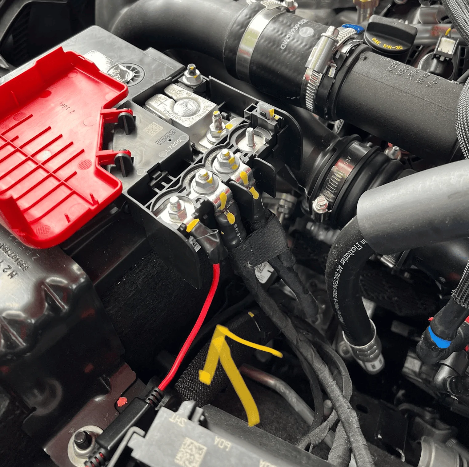

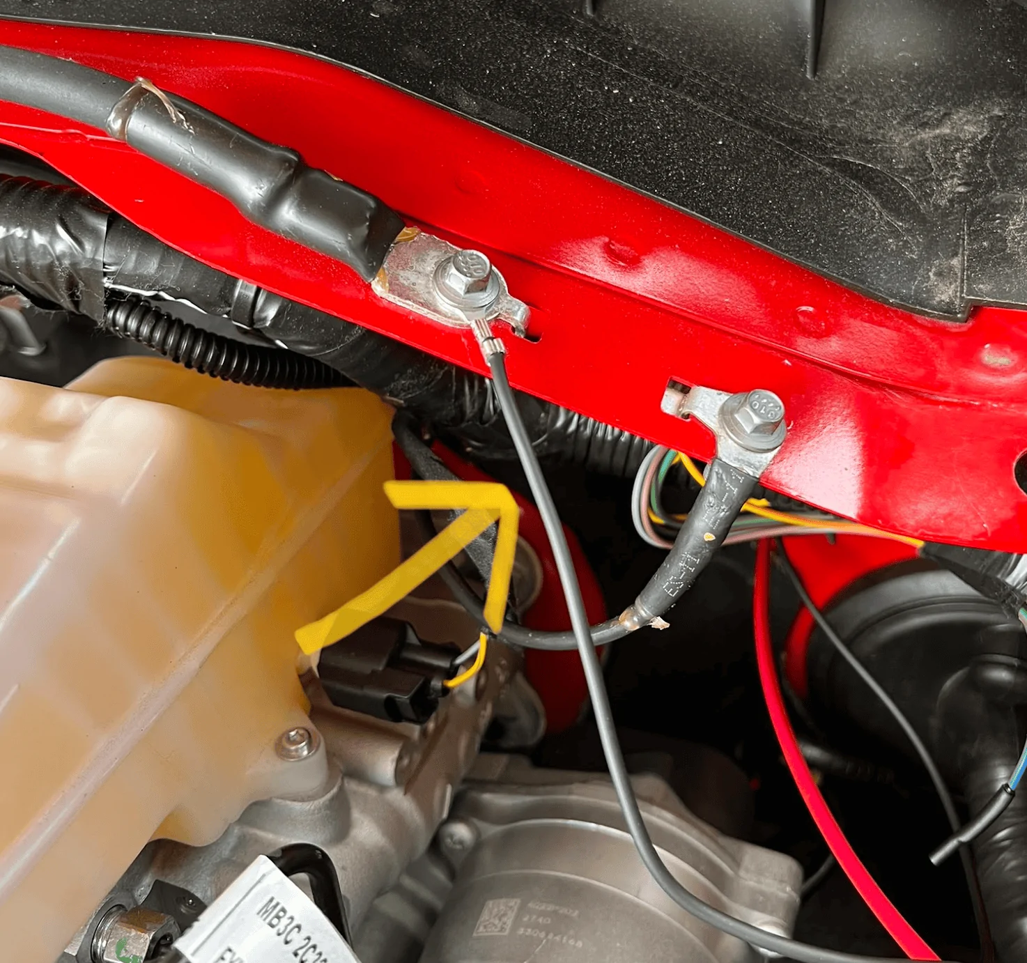

Hey 6G folks,

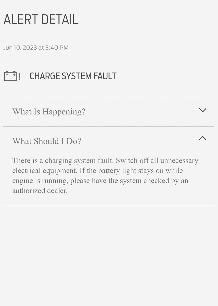

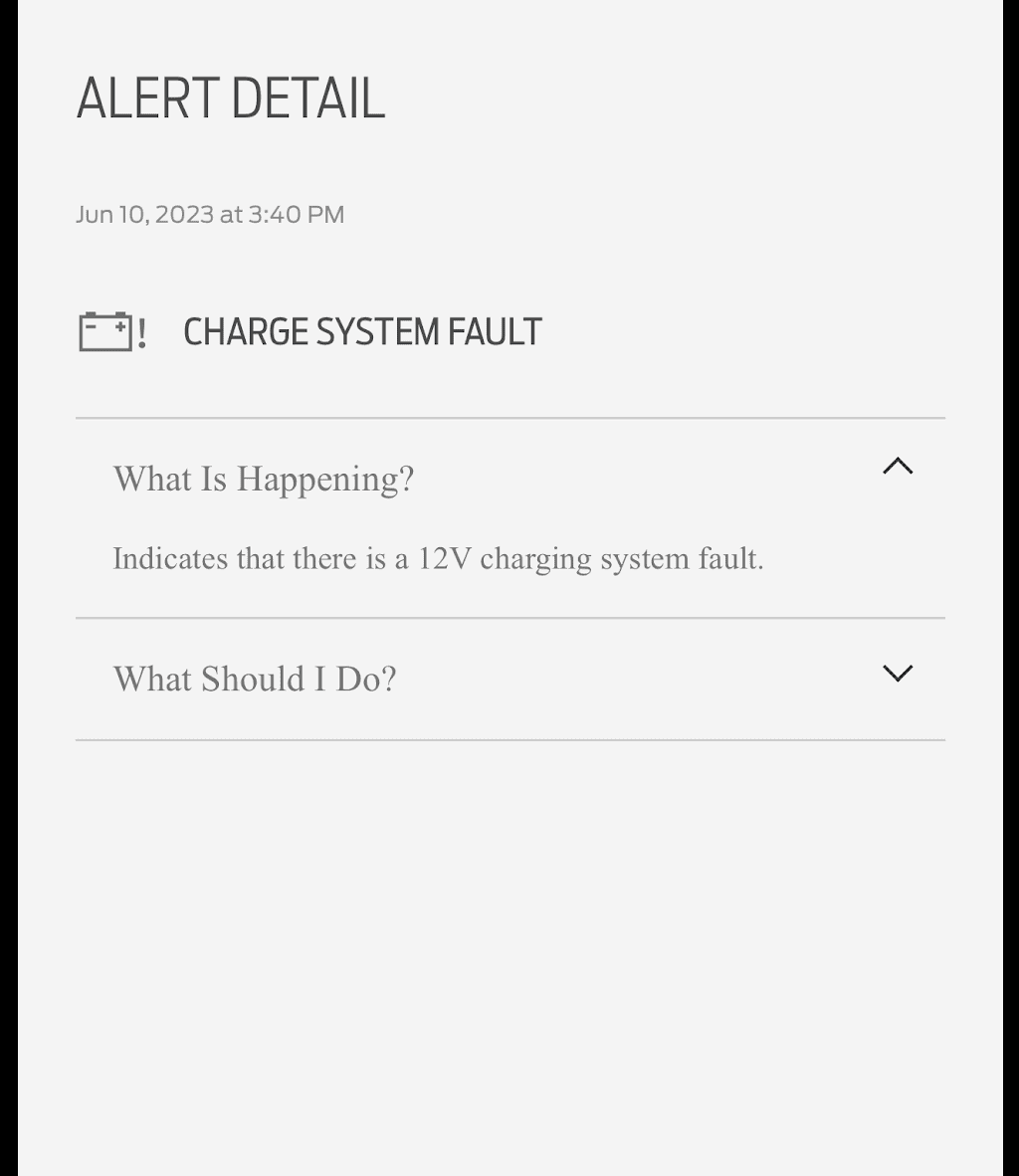

I installed the Kicker Key 200.4, using a harness from PlugNPlay, and wired directly to the battery. Everything is working fine with the amplifier, but I'm getting a charge system fault error (see images). I've double checked my connections and everything is tight, but maybe I'm missing something?
Anyone have an idea of what I'm doing incorrectly? Thanks in advance.

i just noticed that when i turn on my ditch lights it interferes with my radio. i also grounded to the same spot as you. i since moved the ground to a different location and problem solved. hope it works for you and i have no idea why it would matter

That fixed it. Thanks dude.
