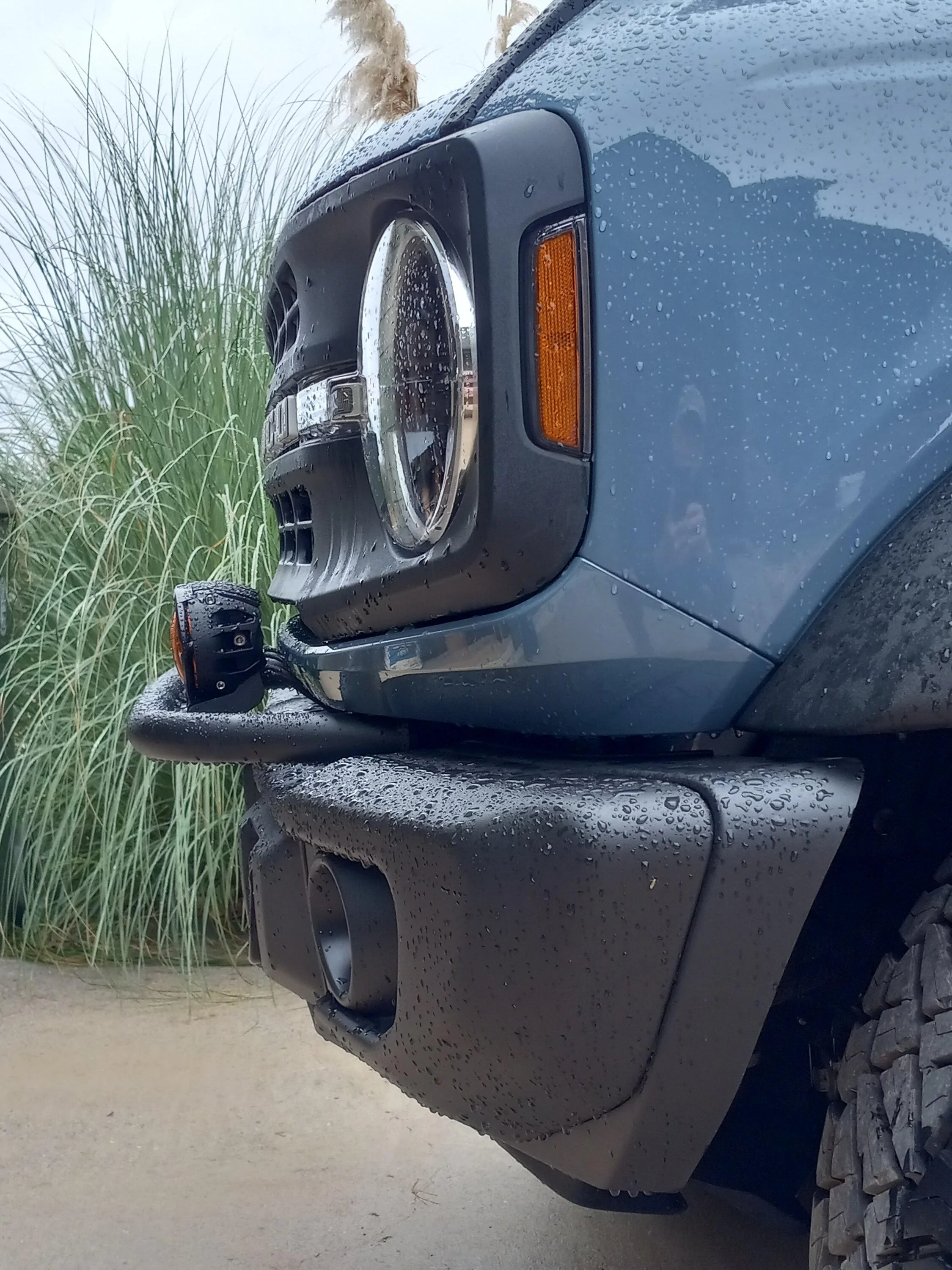

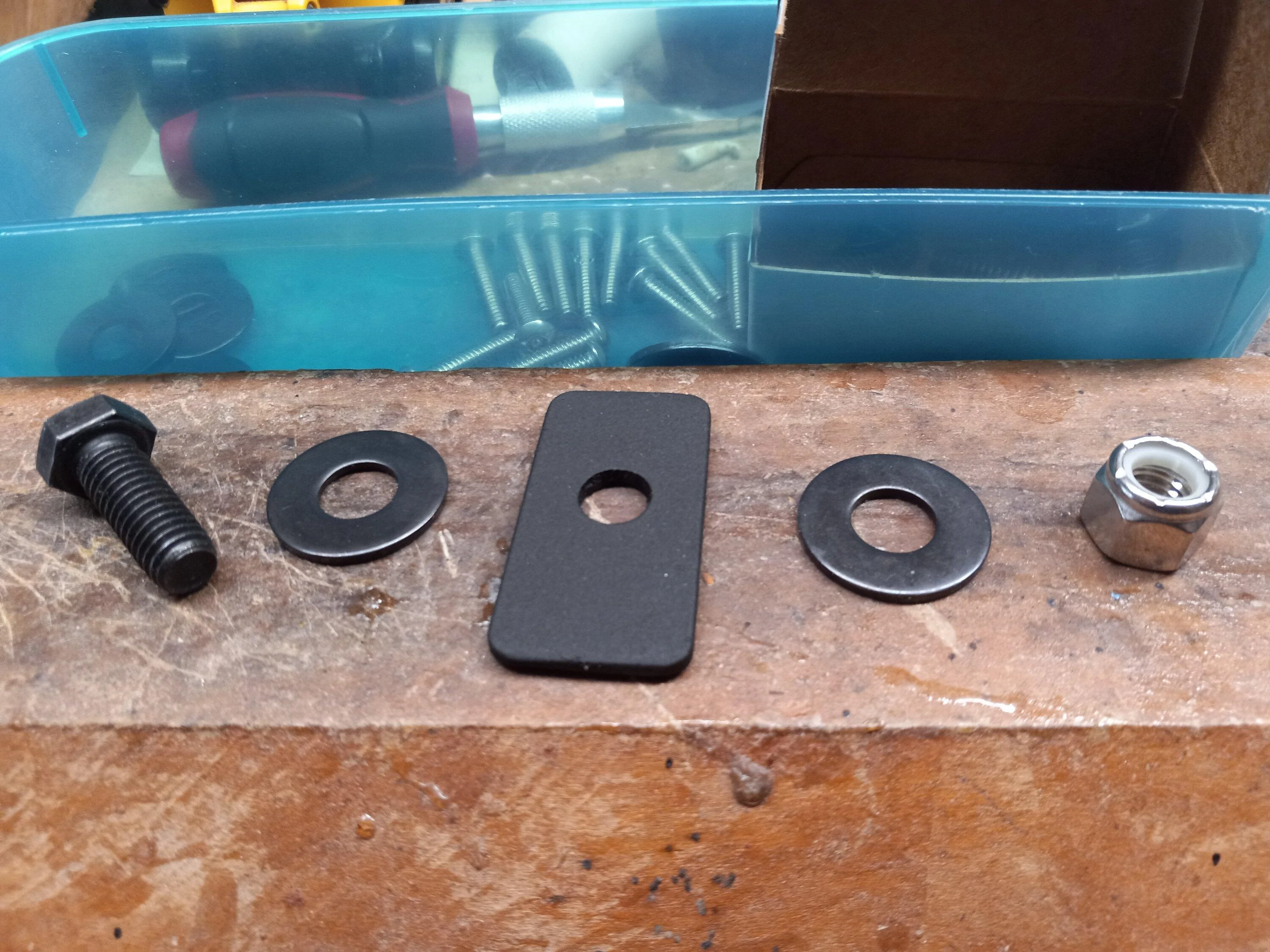

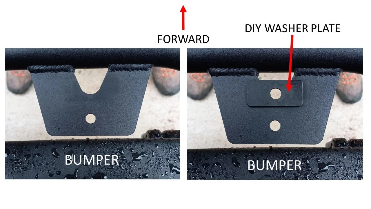

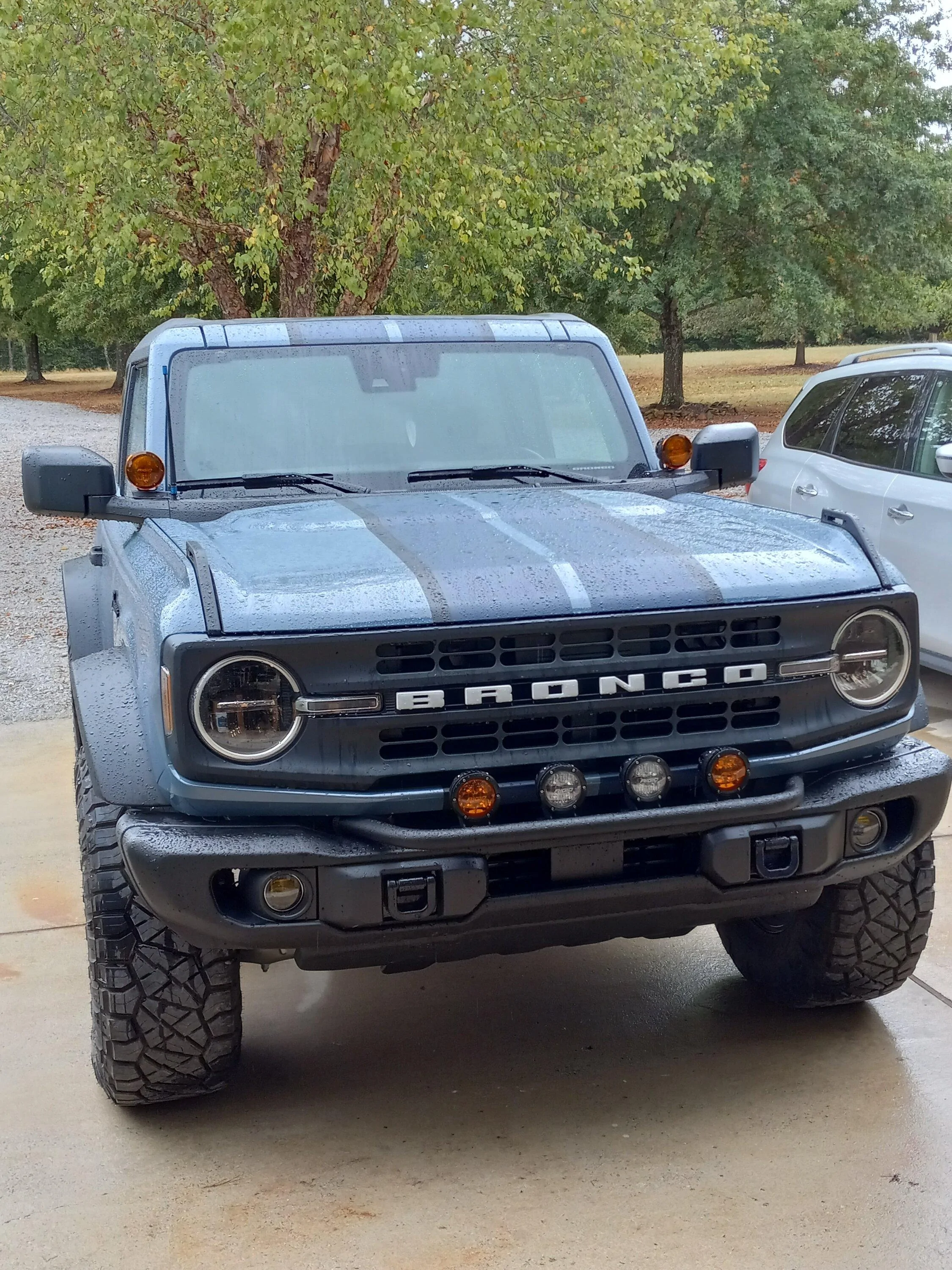

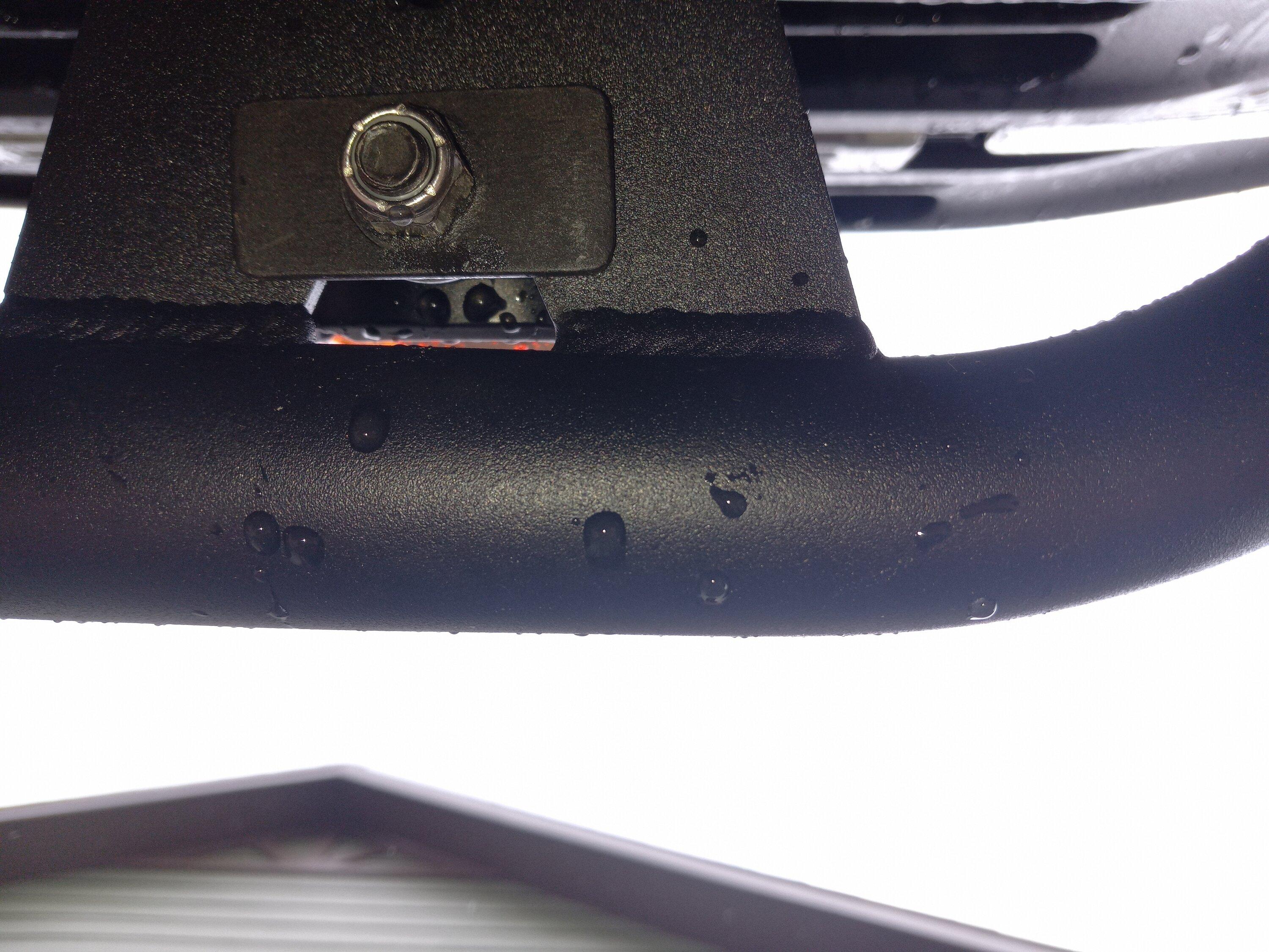

I installed a Nacho Offroad Technology capable bumper light mount bar and as stated, the depth between the mounting holes and the grill is narrow and some lights will not fit. However, here is a solution to gain some space. I fabricated an aluminum plate with a hole to act as a big washer to mount the lights forward of the mounting hole. The plate is installed underneath the mounting tab in the forward cut out gaining some additional room for lights. You could use a large fender washer, but the plate is thicker and provides more contact for a stable connection.

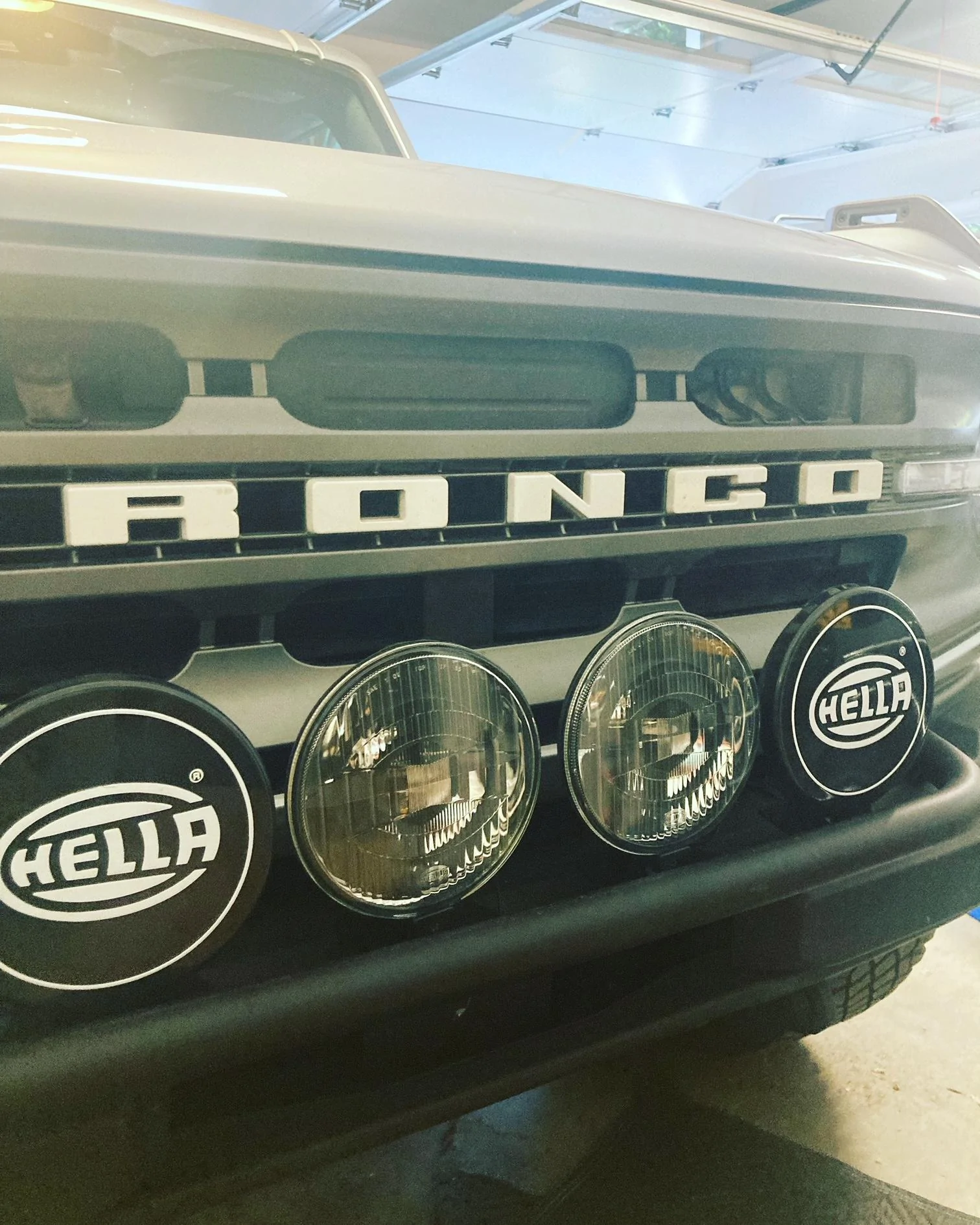

Did it... I'll have better pictures soon! I got em all wired up and as I was securing the wiring, one of the wires disconnected. The pictures will come when it is complete ;) (y)
Hi, what model are the Hella. Do you know if they come in amber also?

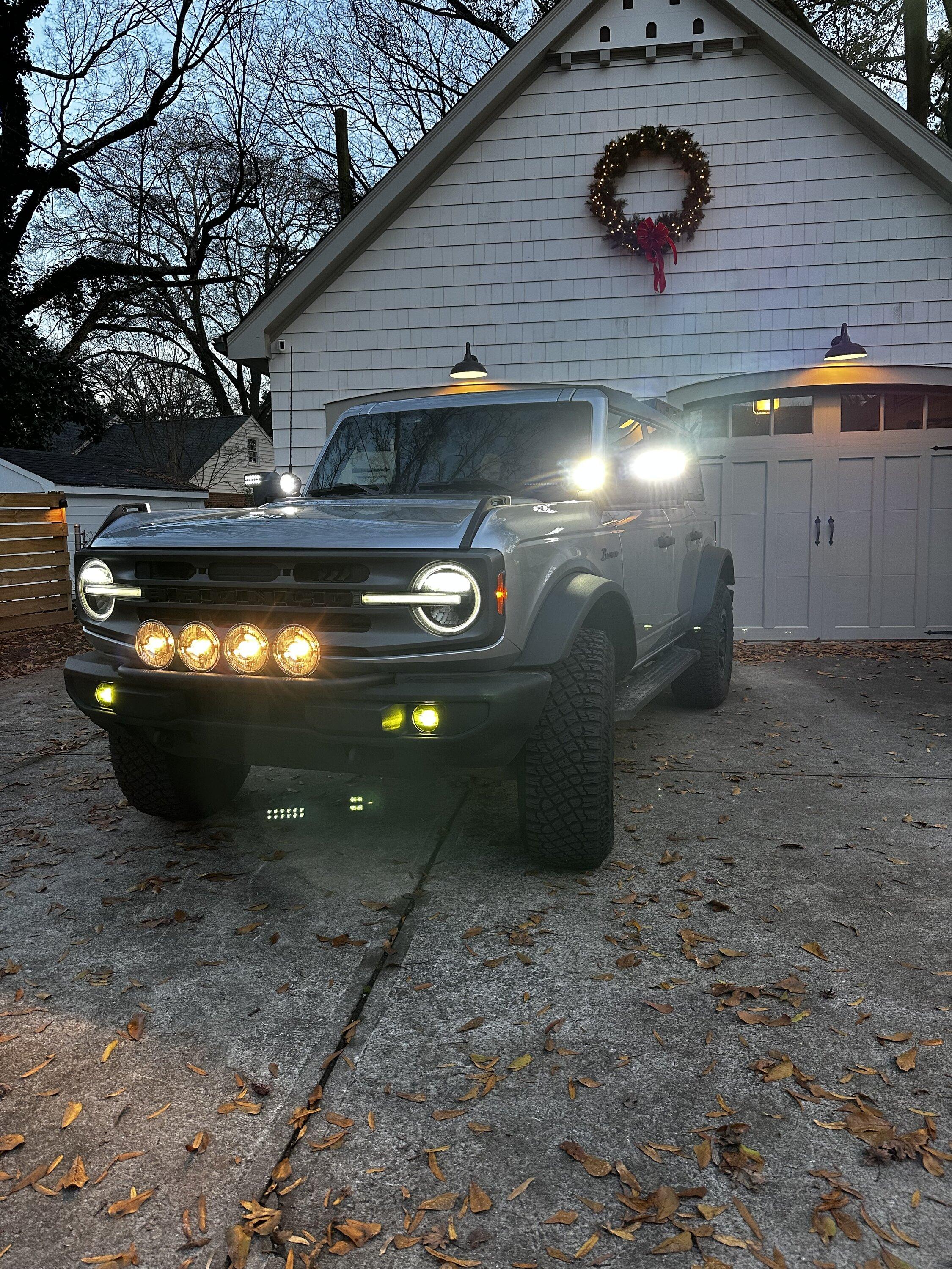

COLIGHT are awesome! I have their Mars and ROB 2 Pro lights on my bronco. Good quality, great light output!

You guys with the nacho bar…can you give a measurement from outside light mounting hole to the opposite outside light mounting hole?
Based on the pictures and my rough tape measure work I’m estimating 22”?
Thanks for any help on an exact measurement…

Just measured mine... the outside light mounting holes are spaced 21 inches apart. See my post above... if you used the larger cut out in front of the light mounting holes and used a large fender washer to mount the lights a little farther forward, you could spread them a little farther... maybe 22 inches.
Just what I was looking for, thanks for the help….
