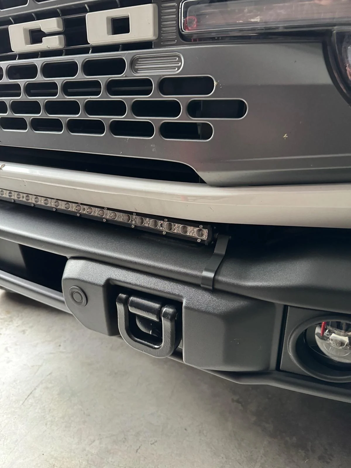

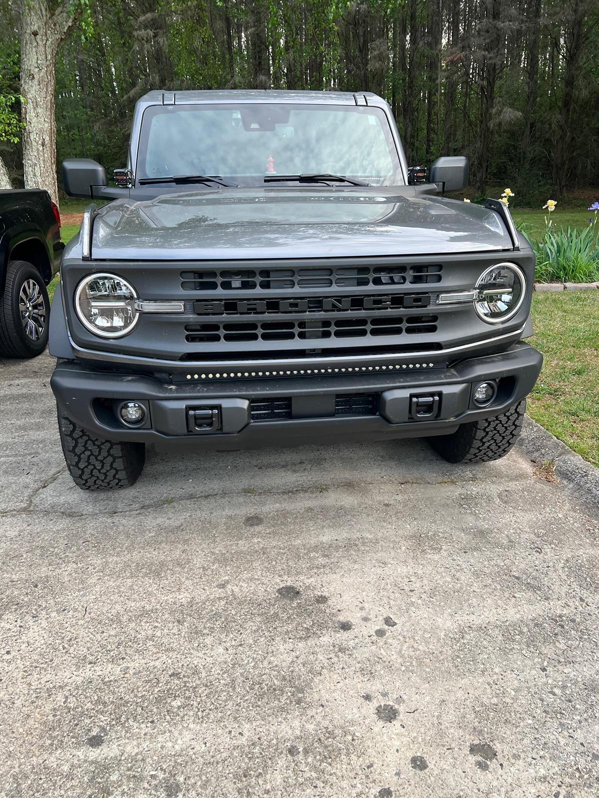

Looks like you have the standard plastic bumper too. What did you have to do to get the bumper to fit over the bar. Website says plastic/capable so I bought it, but having trouble getting the bumper to slide in under the bar. Any tips would be appreciated.![]()

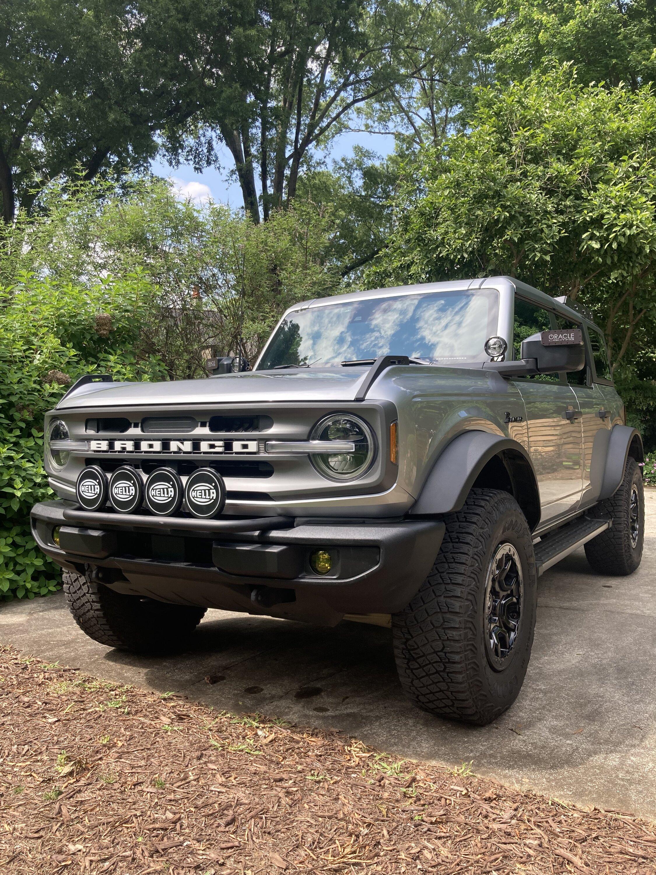

Nacho Bar w Hella 500s

Yup, its the original capable bumper, but I think the spacing is the same throughout. I do remember a bit of struggle that I thought was from the bumper sliding under the bar, but it ended up being the bumper sliding back in around the plastic skid plate. The sides of the plate were pushing against the bumper making it feel like the bumper wouldn't go under the bar. Maybe check that...Looks like you have the standard plastic bumper too. What did you have to do to get the bumper to fit over the bar. Website says plastic/capable so I bought it, but having trouble getting the bumper to slide in under the bar. Any tips would be appreciated.
