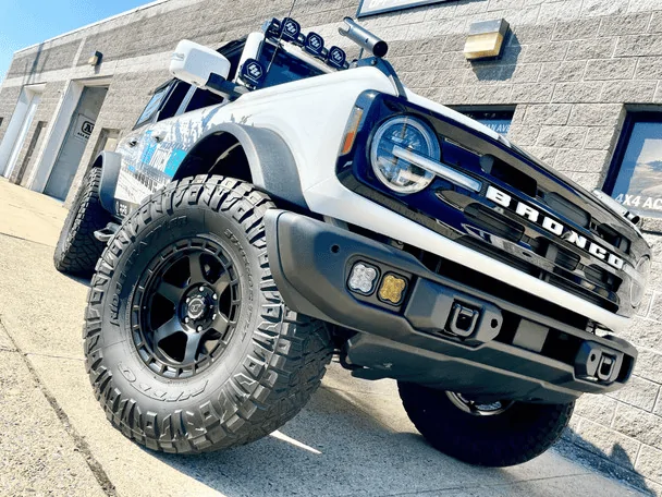

I know this is an old post but we already have options for the Capable
Elite Series Fogs from Diode Dynamics
https://www.4x4truckleds.com/diode-...-fog-lamps-2021-ford-bronco-2019-ford-ranger/
Dual Diode Dynamics fog kit from KR Off-Road (coming soon)
https://www.4x4truckleds.com/diode-...brackets-for-2021-ford-bronco-capable-bumper/

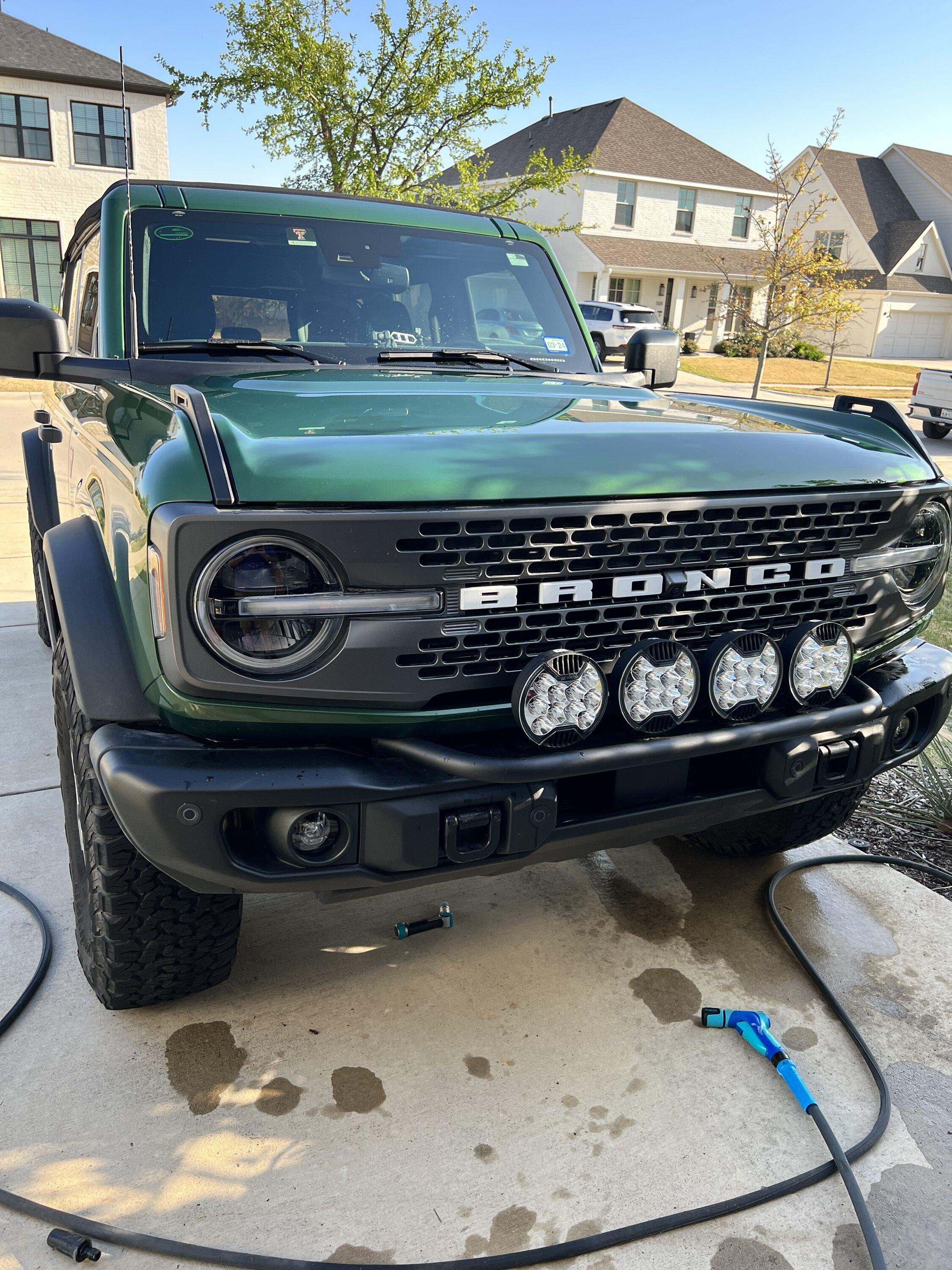

Thanks. Yea I ended up doing this with my capable. I think it turned out well.
https://www.bronco6g.com/forum/thre...aded-with-diode-dynamic-fogs-and-spots.46551/
I do really like that bracket for two ss3s though.

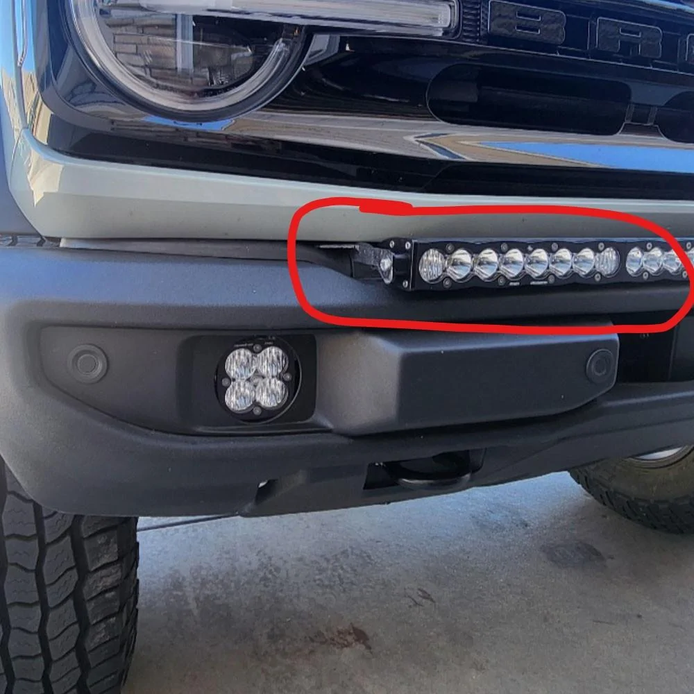

Thought I'd catch this thread up with what M&R has put out for the Capable Bumper.
M&R Capable Bumber Light Bar
- Choose Amber, White, or White output with Amber DRL Backglow
- Includes all mounting hardware
- No cutting or drilling required. The kit is a complete bolt on using factory openings and hardware.
I put on the one for a Standard Bumper and it was an easy install.

Nice. How is the light output?
Would you mind uploading a short video showing light with/without it at night?
Sorry, no Video capability here (but I will see what I can do).
According to the M&R Website:
15,000 Lumens
8 amps (12V)
I can tell you that it's a VAST improvement over just the Pod Lights. For me, it was all about the 'Fitment', since no one cares about those of us with Standard Bumpers.

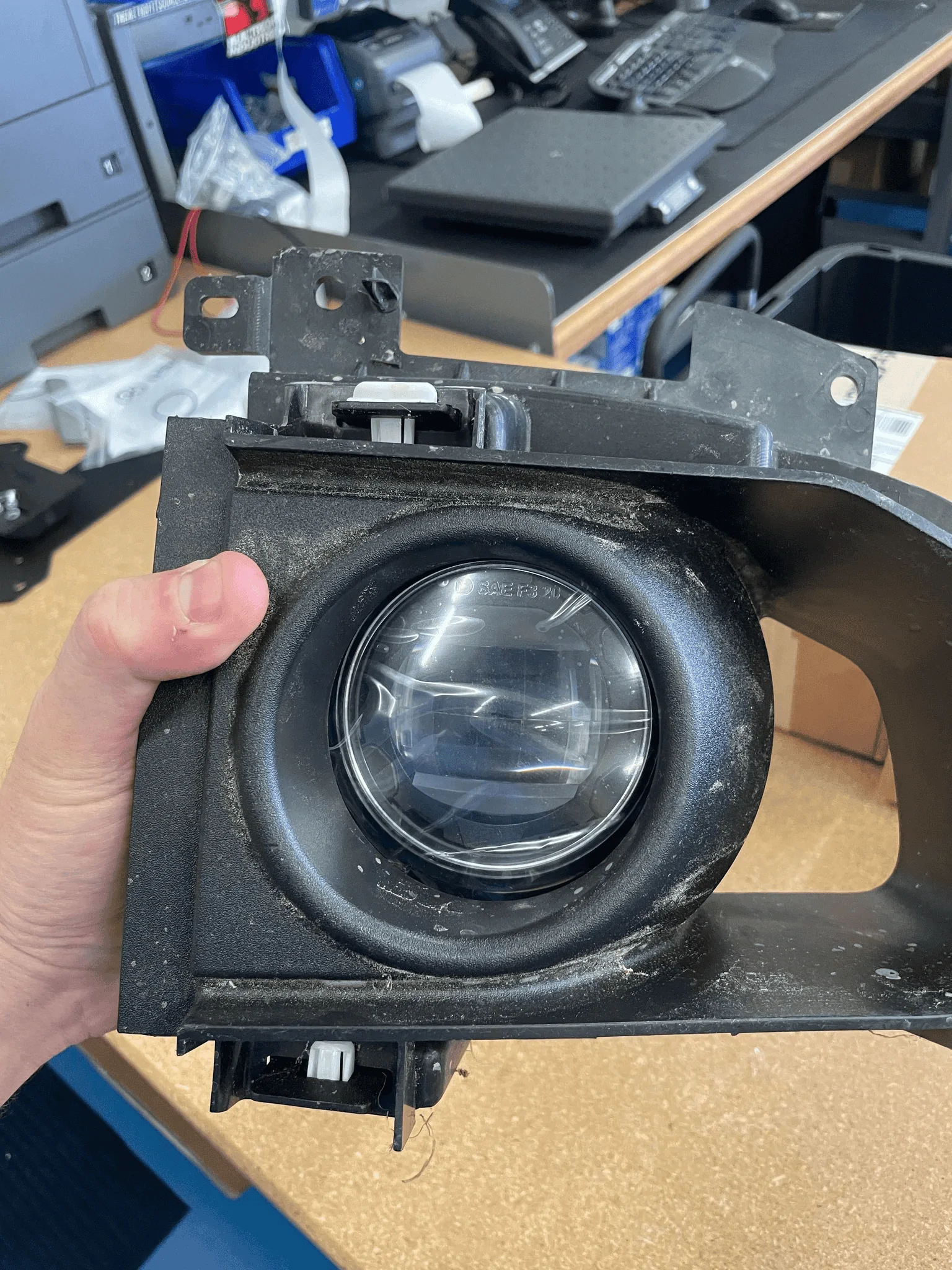

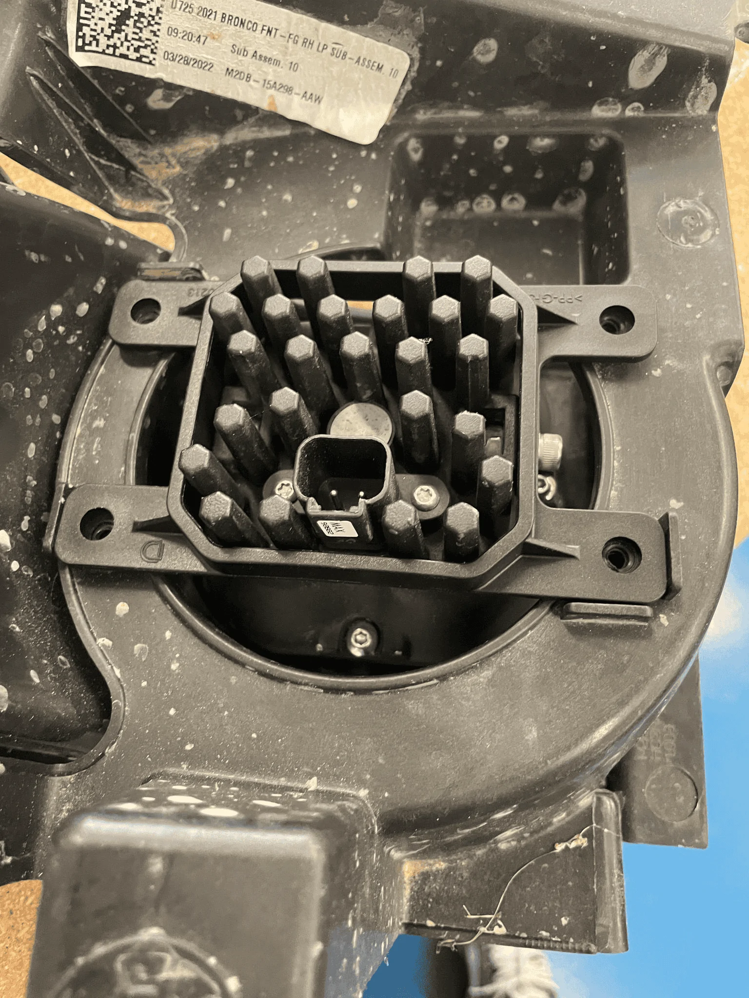

This Elite Series shows as compatible for standard bumper only. Have you test fit it on the Capable?
Do you plug it to the existing fog light harness, and then plug the backlight to an aux switch?
Yes we made a post right here about this:
https://www.bronco6g.com/forum/threads/diode-dynamics-capable-bumper-fog-compatibility.55254/

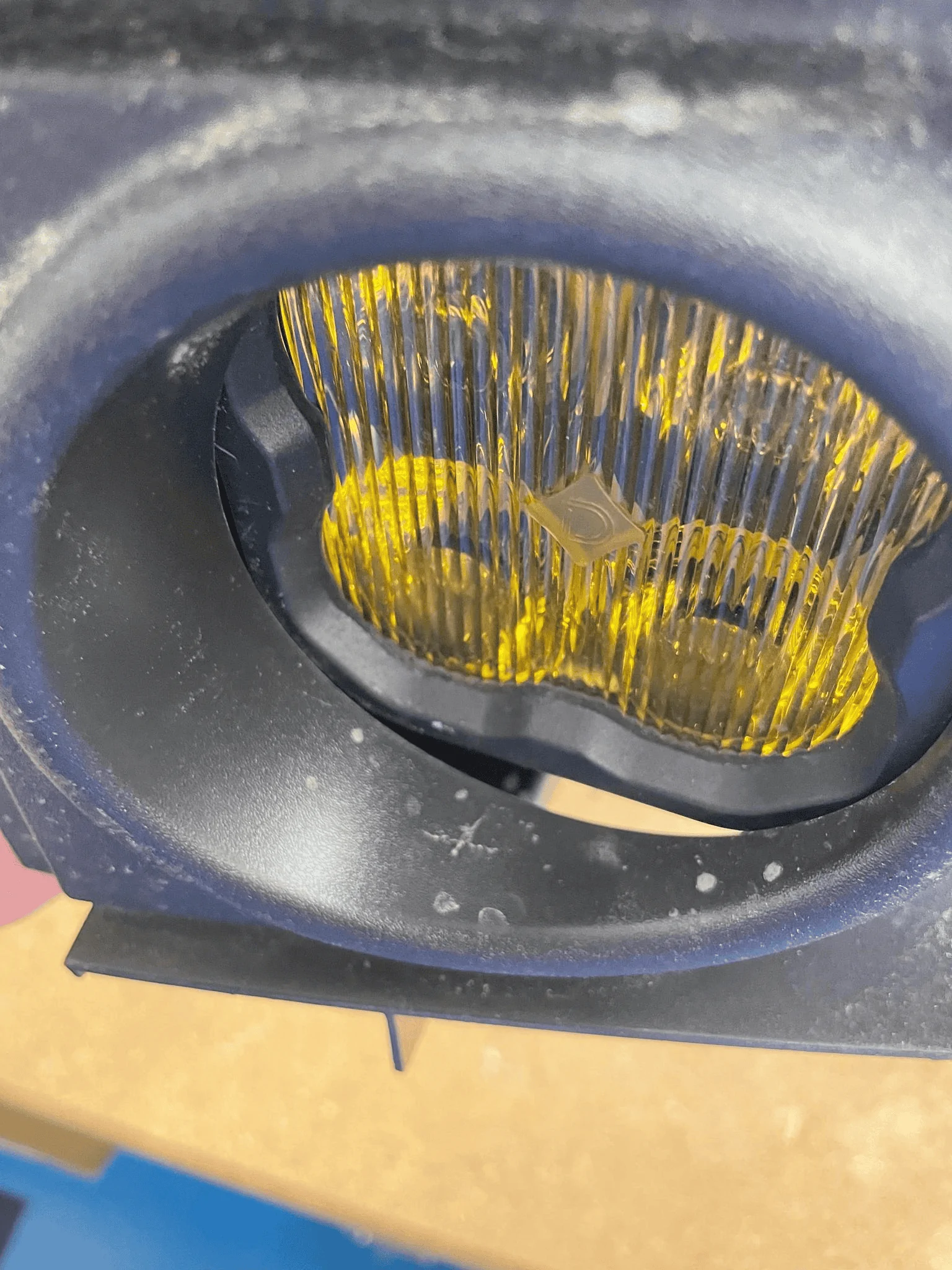

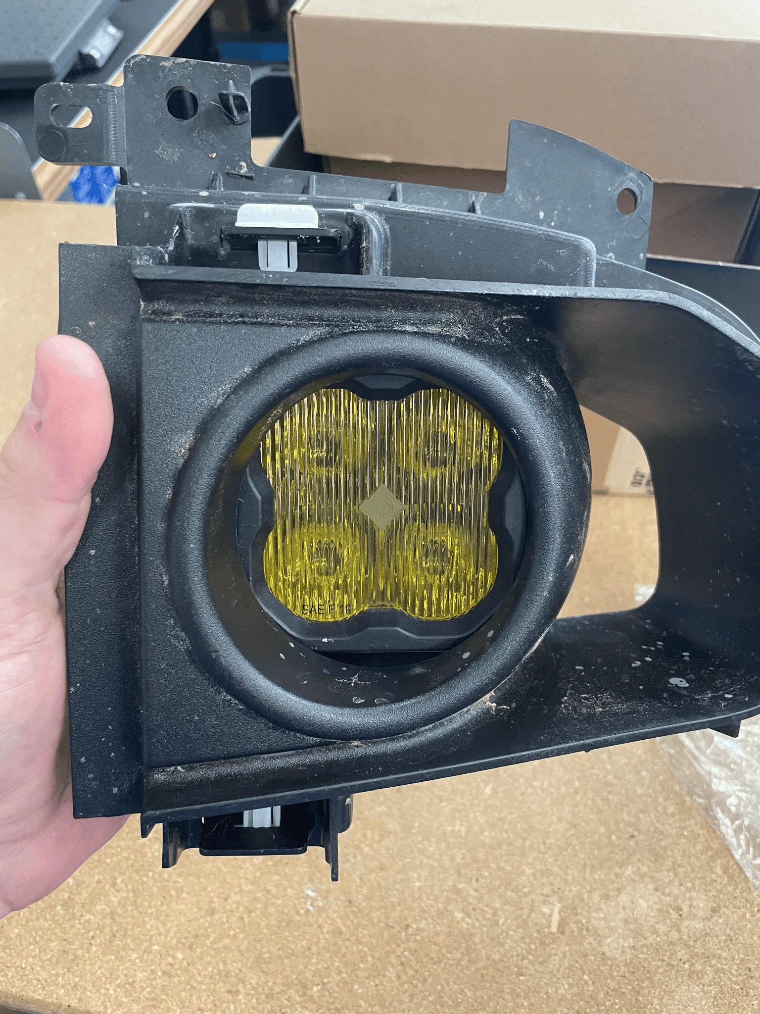

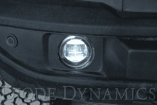

Long story short... the new Elite Series Fogs ARE compatible with the Capable Bumper. The SS3 Fog Kits ARE NOT compatible (well they WILL fit but you cannot adjust the pattern up/down, since the bezel rests against the plastic)
ELITE SERIES
Ford Bronco Capable Bumper Light Bar 1664381286926-png
Ford Bronco Capable Bumper Light Bar 1664381294475-png
(The plastic is still on the lens FYI)

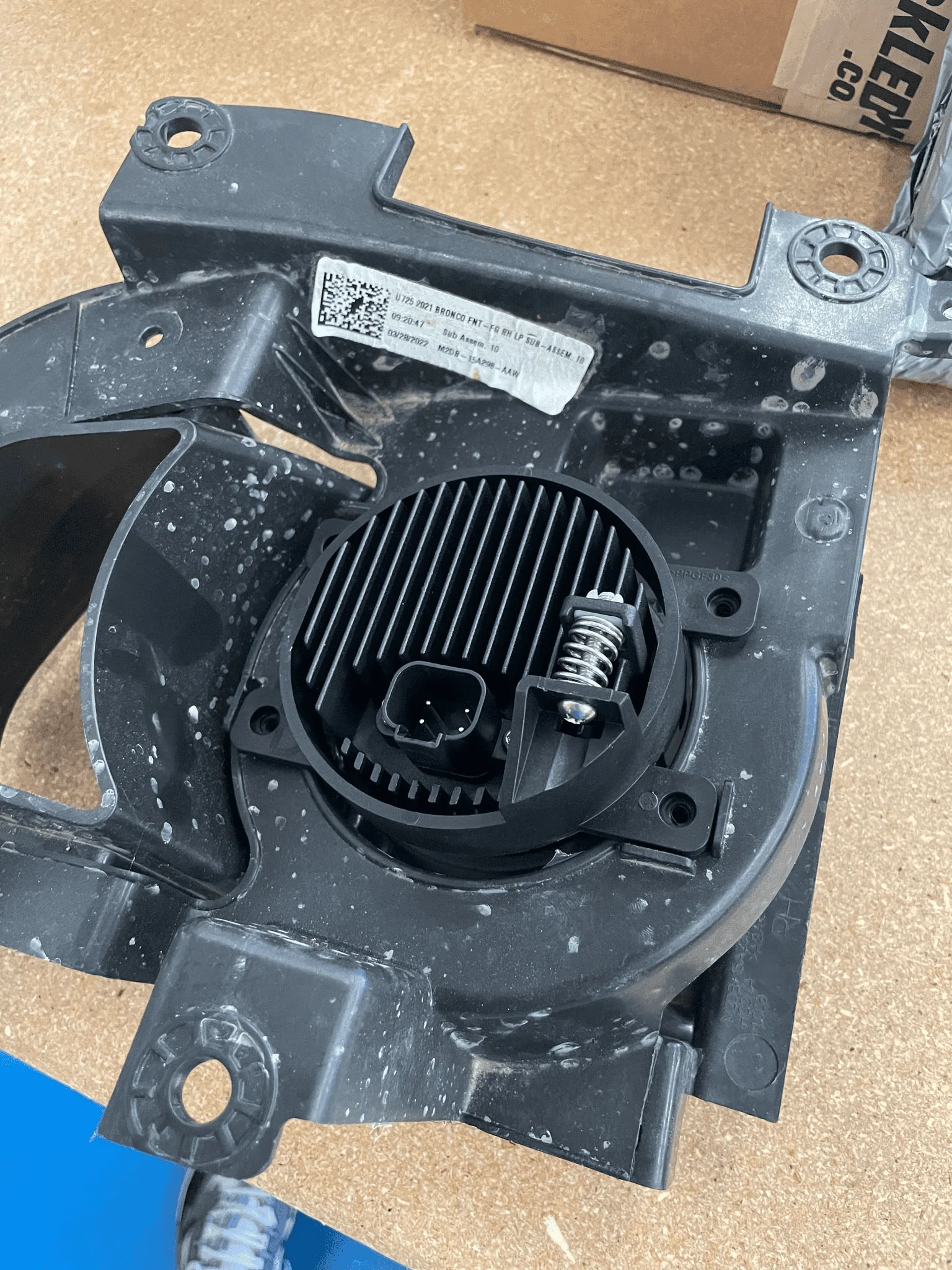

SS3 KIT
https://www.4x4truckleds.com/diode-...ght-kit-for-2021-ford-bronco-standard-bumper/
Ford Bronco Capable Bumper Light Bar 1664381346389-png
Ford Bronco Capable Bumper Light Bar 1664381354326-png
Ford Bronco Capable Bumper Light Bar 1664381361992-png
So hopefully that answers some questions regarding fitment.
ELITE SERIES FOG KIT = FITS
SS3 FOG KIT = SORT OF FITS
