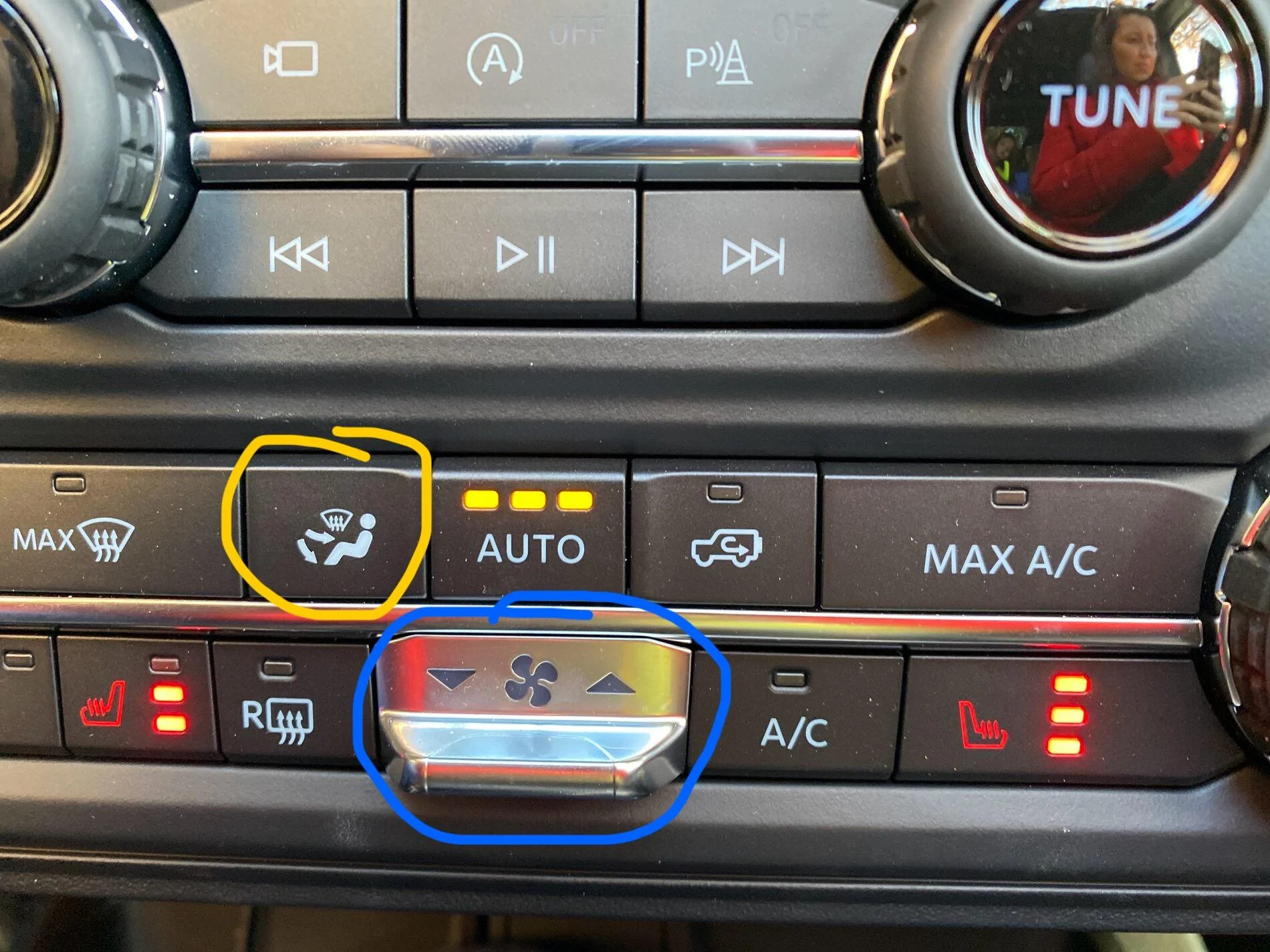

They mean if you click the button circled in yellow you get an onscreen prompt to choose the vents, then you use the lever circled in blue to adjust fan speed. All of which you probably already knew.
Adding a bit of extra context here. The Auto version uses a variable recovery speed based on the three LED's on the Auto Button. Push the button to change how fast or slow you want the cabin to meet the set point. One light is supposedly a slow fan and outputs to meet the desired temps. Mine seems just to Blow, but according to the manual, that's how it's supposed to work. I'm getting used to the crappy blend and assume it's going cold or hot trying to meet the set point.

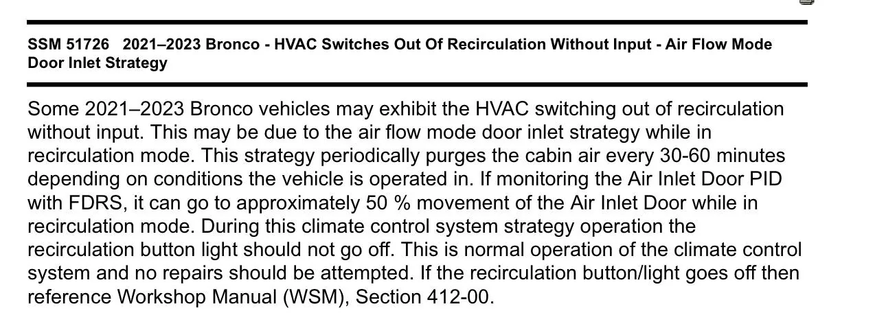

I've now had my OBX for roughly a year and a half and this vehicle has one of the oddest HVAC systems I've ever encountered. I'm very curious if it operates differently based on outside temp.
I keep my temp at about 70F almost year round. During the summer months, 70F blows cold air with A/C turned on. Once the outside temp dips below about 60F, the HVAC blows hot air at 70F internal even with the A/C turned on. During summer, recirculate stays on at all times. During winter, even with A/C turned on, recirculate turns off at about 60 seconds and needs to be turned back on if desired.
I've noticed other quirks as well. What in the world is going on with this crazy HVAC system?
I have an early 2022 OBX as well and one of my biggest complaints is the fact that the recirc button turns off after a minute or two once activated if the AC is not on. For me it stays active if the AC is on. The only work around to having the recirc stay on without running the AC is to have air directed to the windshield, the dash and the floor at the same time. But its actually running the AC without the AC button lit. I know that sounds nuts but the air that comes out is icy cold even tho the AC button is not lit. Its a weird quirk that makes me feel better that I'm not using the AC while having reticulated air (even tho the AC is running) lol. I'm in Cali and drive alot of freeways-when its not hot out l like the air blowing without freeway air coming in so the fact that the recirc only works with the AC running bugs me alot. I feel like Ford could easily fix that with an update but they'd probably break something else in the process...Anyways, thats my story and I'm stickin' to it...

On my last long road trip, I noticed some really annoying behavior - I would just be cruising along with the climate control set, and the fan would spin up to the max speed blowing cold air - despite the setting be 2, 3, etc. The AC was already on but not set very low, only 70 or so. It would do this for a while and then slow back down to the previous fan speed.
I could interrupt it by turning the climate control on and off, or turning the fan all the way up and back down using the switch.
Doesn't usually happen on my commute but on longer trips it happens a lot.
That’s the recirculation door opening. It makes it seem like the fan is speeding up, but in reality it’s just the fresh air being forced in blowing harder than with the door closed. It is pretty annoying.
