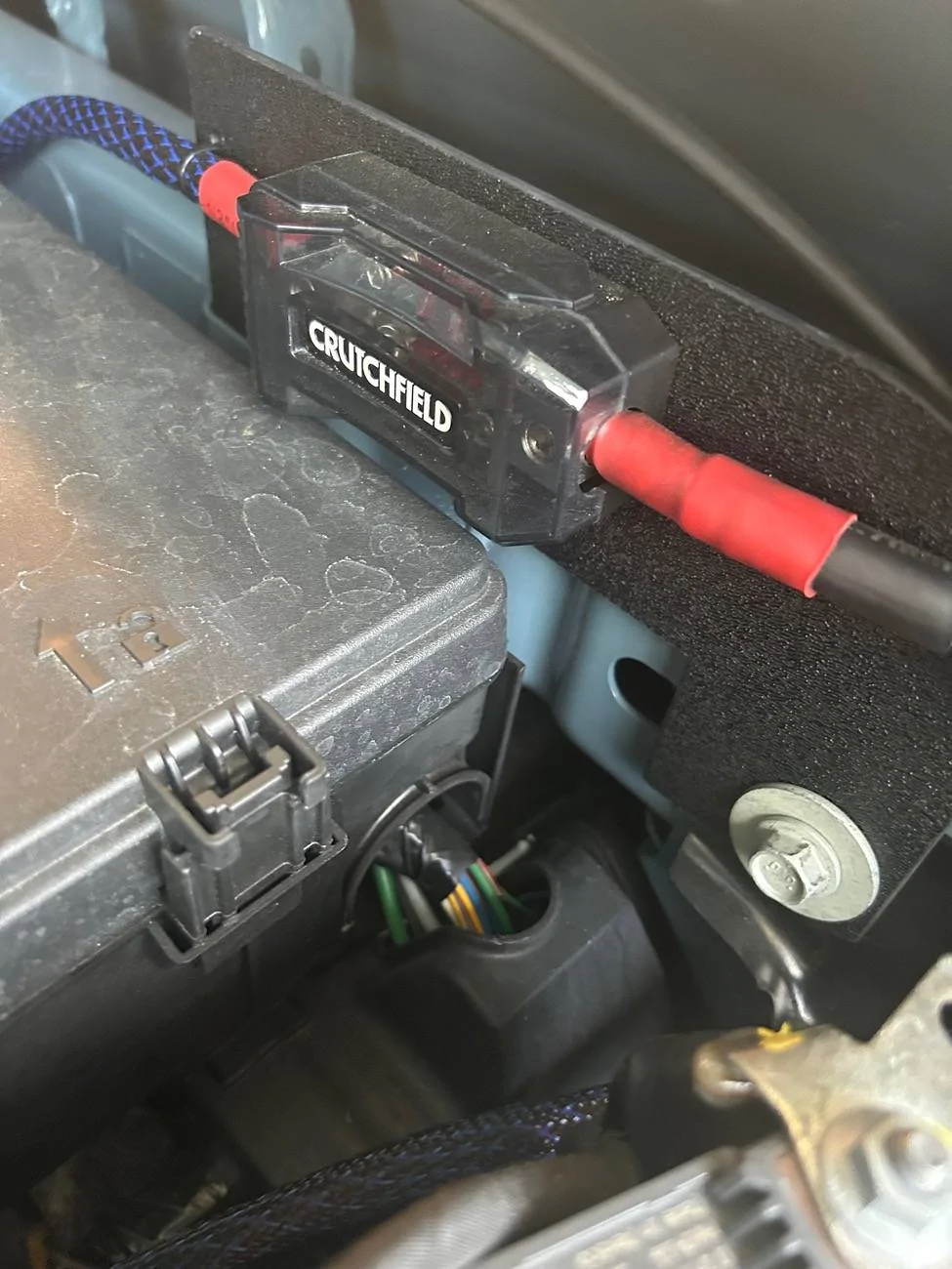

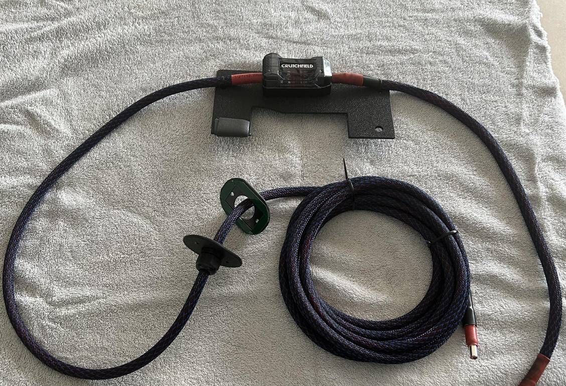

If you can wait until to night I can snap a shot of what I did and where it mounts. No holes needed. This is the fuse holder mount. It uses factory locations I will snap a shot of tonight.
Ford Bronco Can I shoot a couple screws here? IMG_7670
That is a nice bracket. Did you make it or find it somewhere?

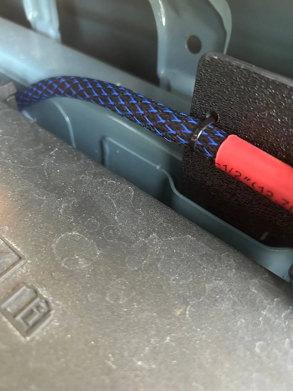

I did just that for a resettable breaker for my charge wire from the RV to the battery. You'll need a right angle drill as the space is a little tight. Put a piece of masking tape down where you want the hole, and tape some newspaper below it to catch any shavings. I'm paranoid and touched up the finished hole with some paint before putting in the holding metal self tapping bolt.
Ford Bronco Can I shoot a couple screws here? Bronco Pic
