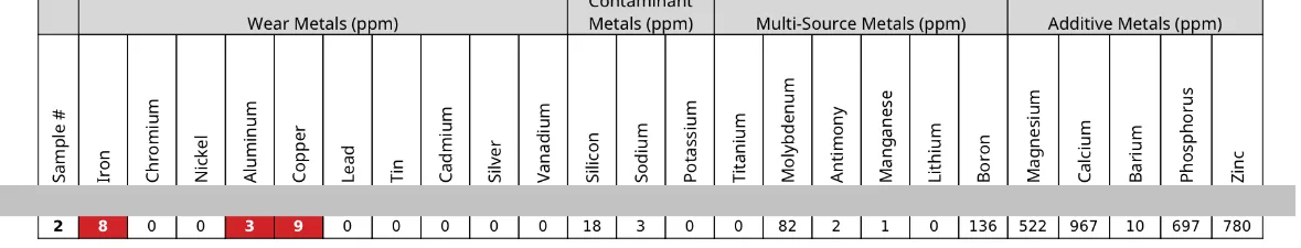

My first report from Horizon states that my dilution is 7.7!!! That was only after 2000 miles too (using what I assume to be Motorcraft). Not ok. Ford fleet vehicle that was driven 8500 miles in a month w/o an oil change that I’m aware of.
Metals are bonkers too. Not sure what to think of this…I guess I can’t really worry until the next service since now I know what’s in there.
Ford Bronco Bypass micron filter install? IMG_3236
Changed to Motul 5w30 and will run another report after another 5000. Part of me wonders if I should pull it at 2500.
I have an extremely short commute. I had a feeling that was causing issues in my 2021. We’ll see if the new MPC motor is any different.
Might have to change grades.
