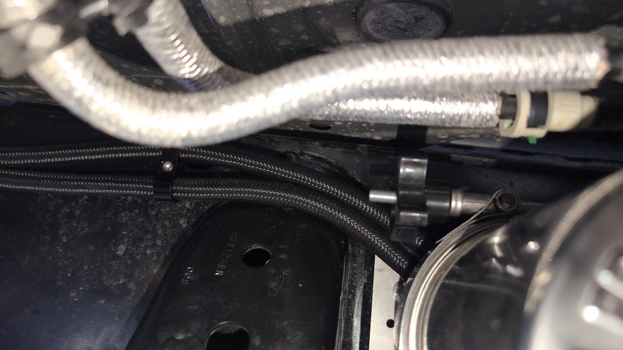

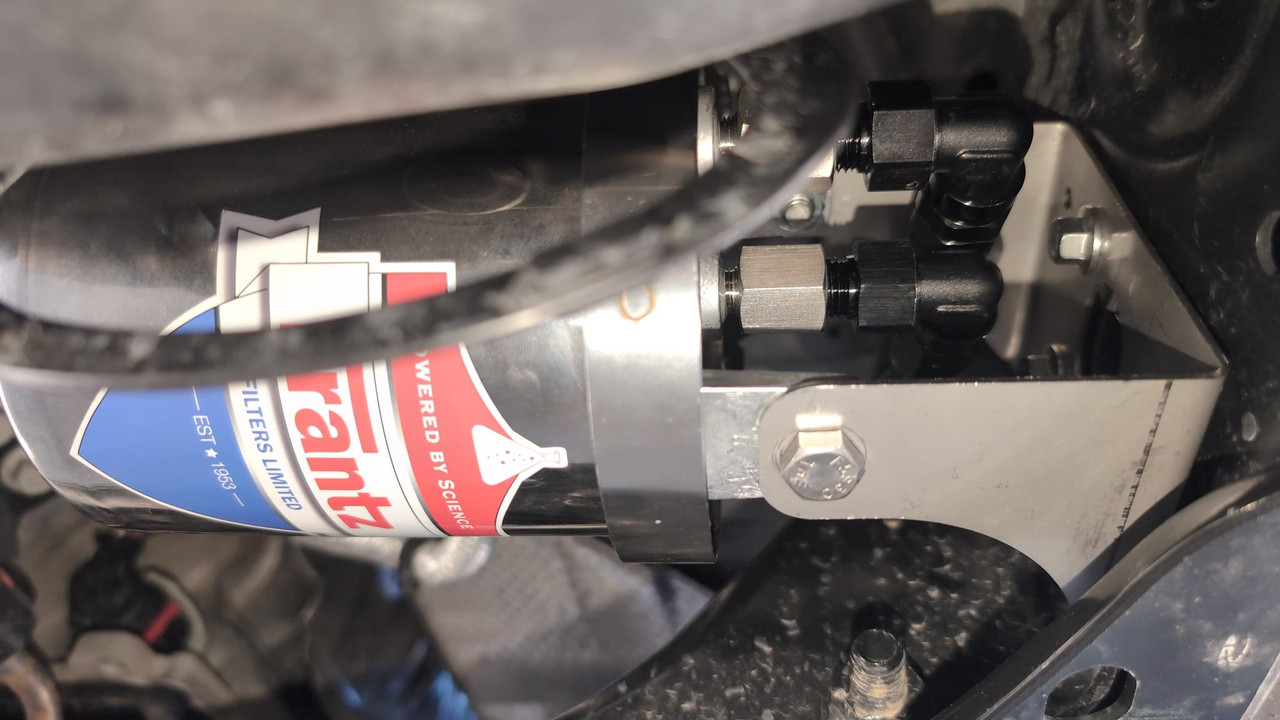

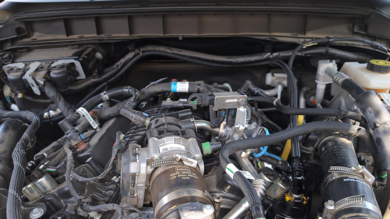

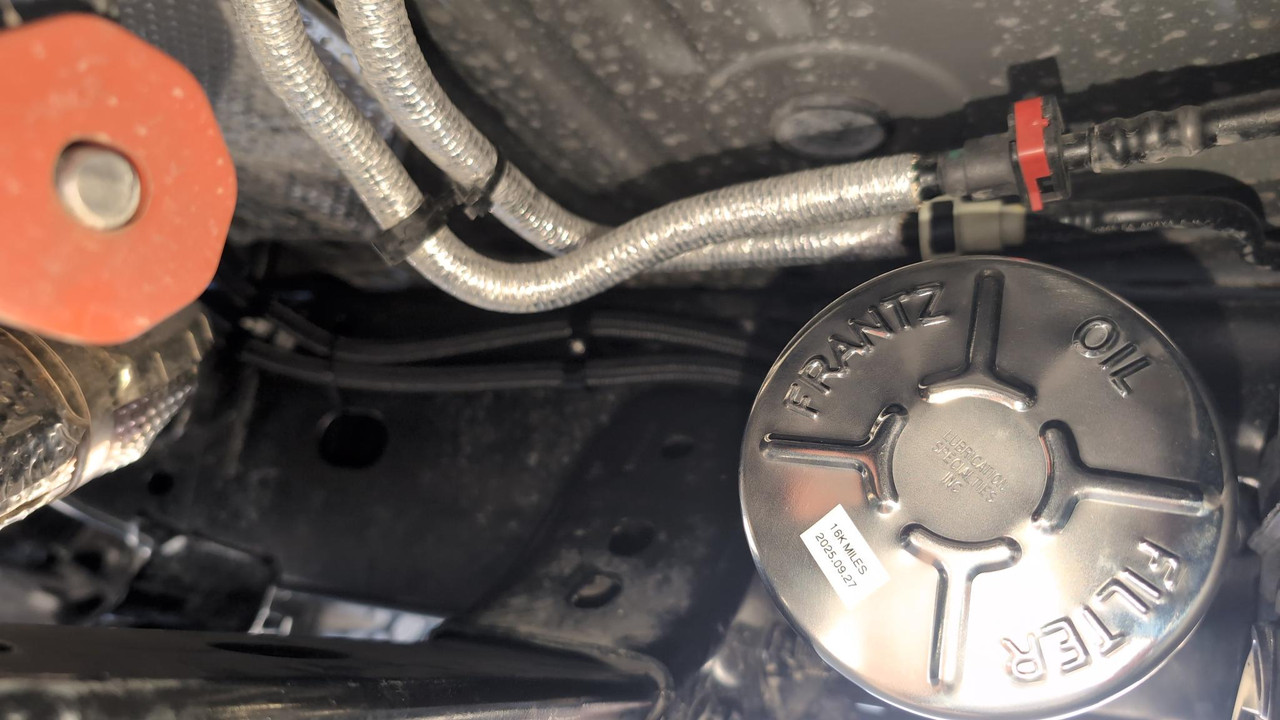

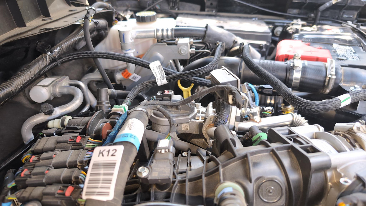

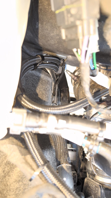

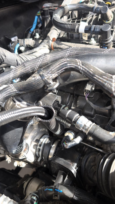

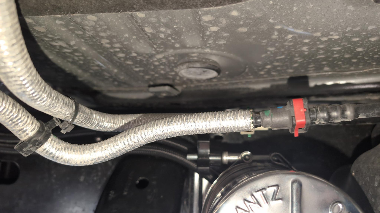

I installed the Frantz filter on my 2024 2.7L.
Frantz Pros
- Low cost filters
- Two types of filters
- Toolless filter change
Frantz Cons
- Only filters down to 2 micron
- They don't sell a direct fit kit for the Bronco
Insane Diesel Pros
- Filters down to 1 micron
- Billet well built part

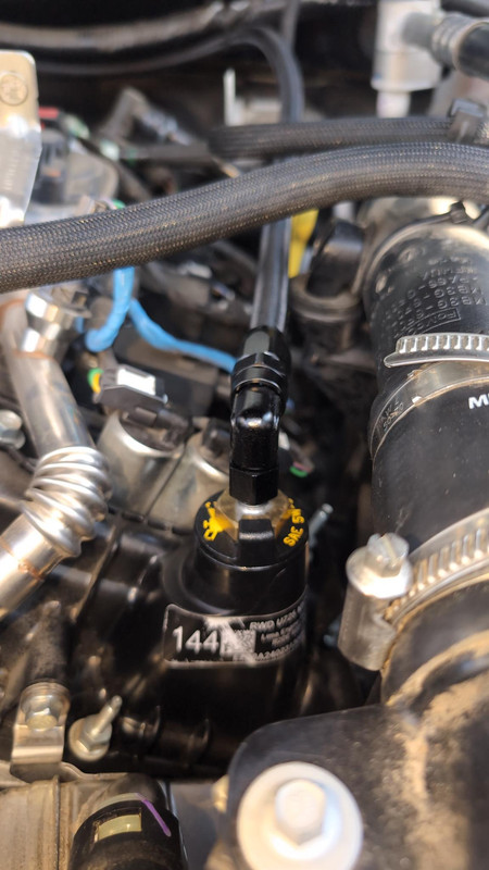

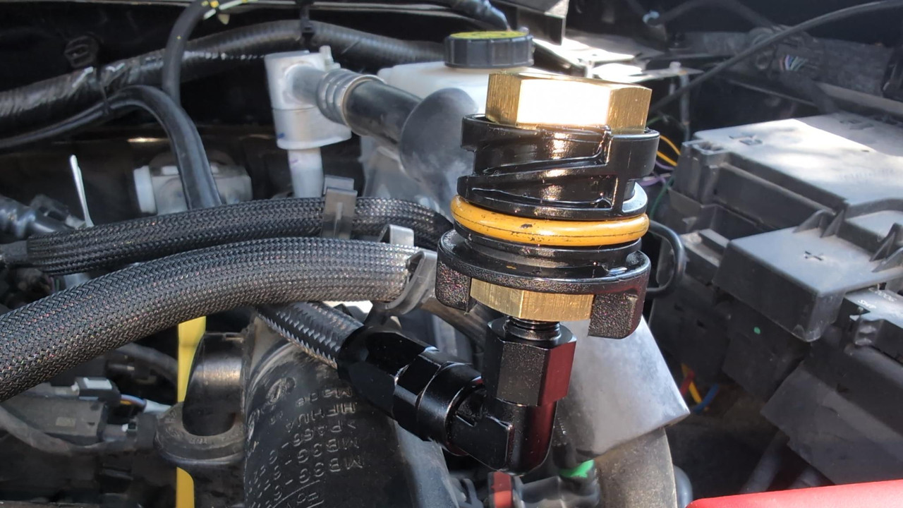

- They are the only place that sells a oil filler cap return to fit the Bronco that I found.
Insane Diesel Cons
- Replacement filter cost
- Requires a tool and torque wrench to change the filter
Bypass Filter Pros
- Unobstructed supplemental filtration surface area that does not impact the main oiling system.
- Filters wear particulates down to 1-2 micron. Stock filtration is only 18-20 micron.
- Extends oil life especially with turbos and diesels darkening the oil.
- Removes water and antifreeze.
- Extends the engine life by reducing wear particles.
- Increases the oil capacity by one extra quart.
Bypass Filter Cons
- Installation cost
- Extra filter to change
Comments
  • Surface area on stock filter is only ~5.5" x ~25" which is approximately 1 sq. ft.
  • Ford gives you basic filtration to accomplish warranty goals.
  • Particles under 1 micron are considered to be non-wear particles.
  • I have the Insane Diesel bypass on my Powerstroke.
  • Even if you change the oil every 2-3k miles with stock filtration you can't remove micron or larger wear particles.

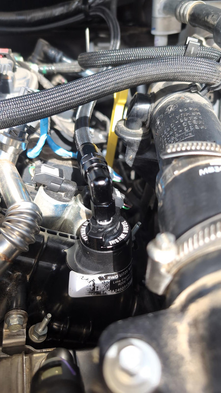

  • I drilled the factory plastic cap and installed the bulkhead fitting from the Frantz kit as a temporary solution until the direct fit Insane Diesel cap arrives. The plastic cap works but has some vapor residue since the bulkhead fitting is not completely sealed.
  • You can optionally do a full Insane Diesel kit instead of the Frantz.
  • The fittings specified in the BOM allow you to also interchange the Insane Diesel just by swapping the bracket and filter housing.

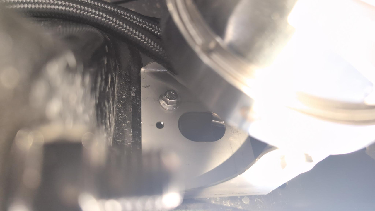

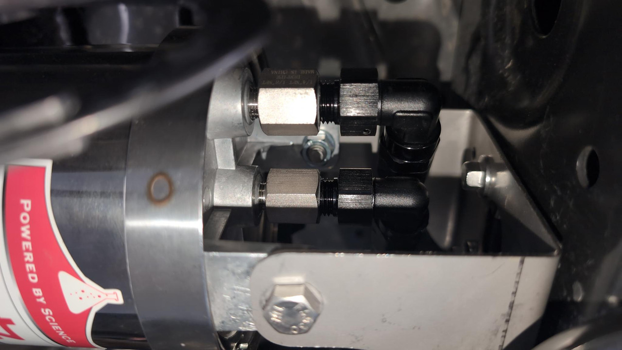

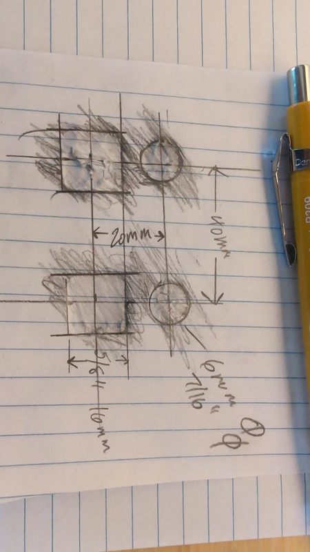

  • You need to drill two holes in the factory Frantz bracket matching the holes in front of the fuel tank.
  • You need to slightly file down the side of the u-nuts to fit in the square slots on the frame.

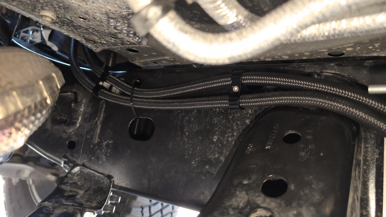

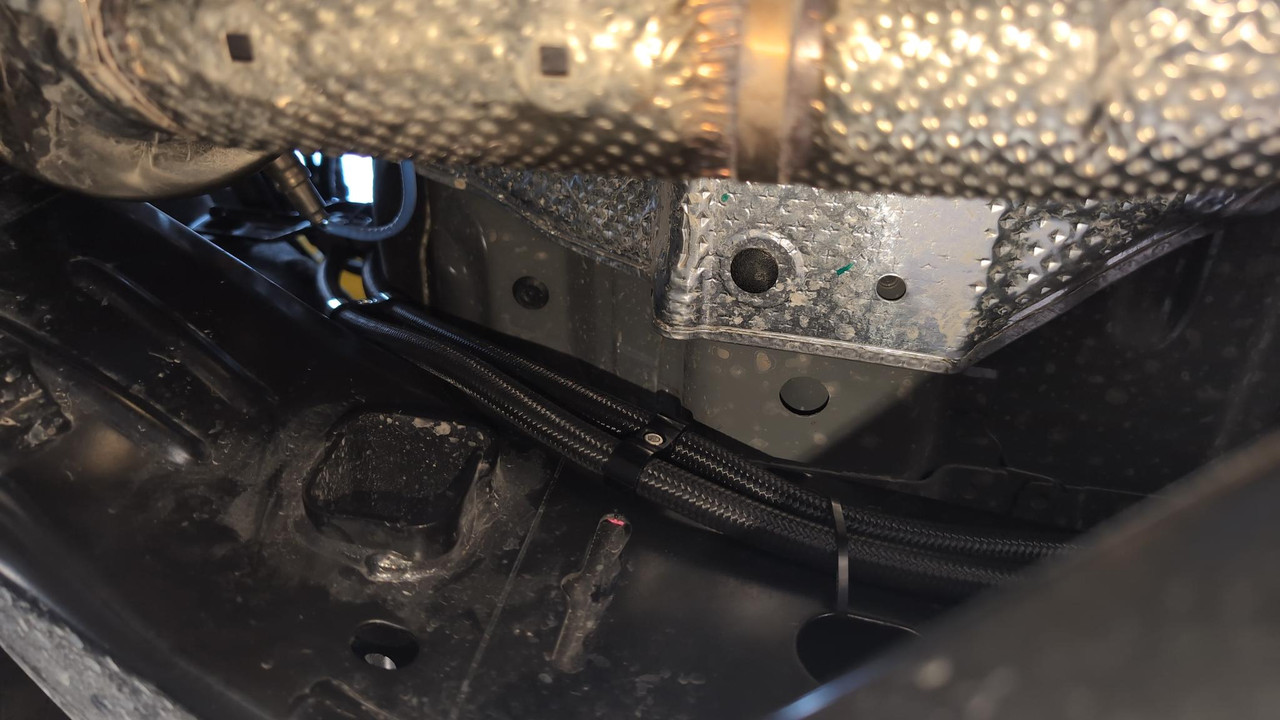

  • Putting a piece of foam on the metal fender bracket where the hose is tied to is advised.

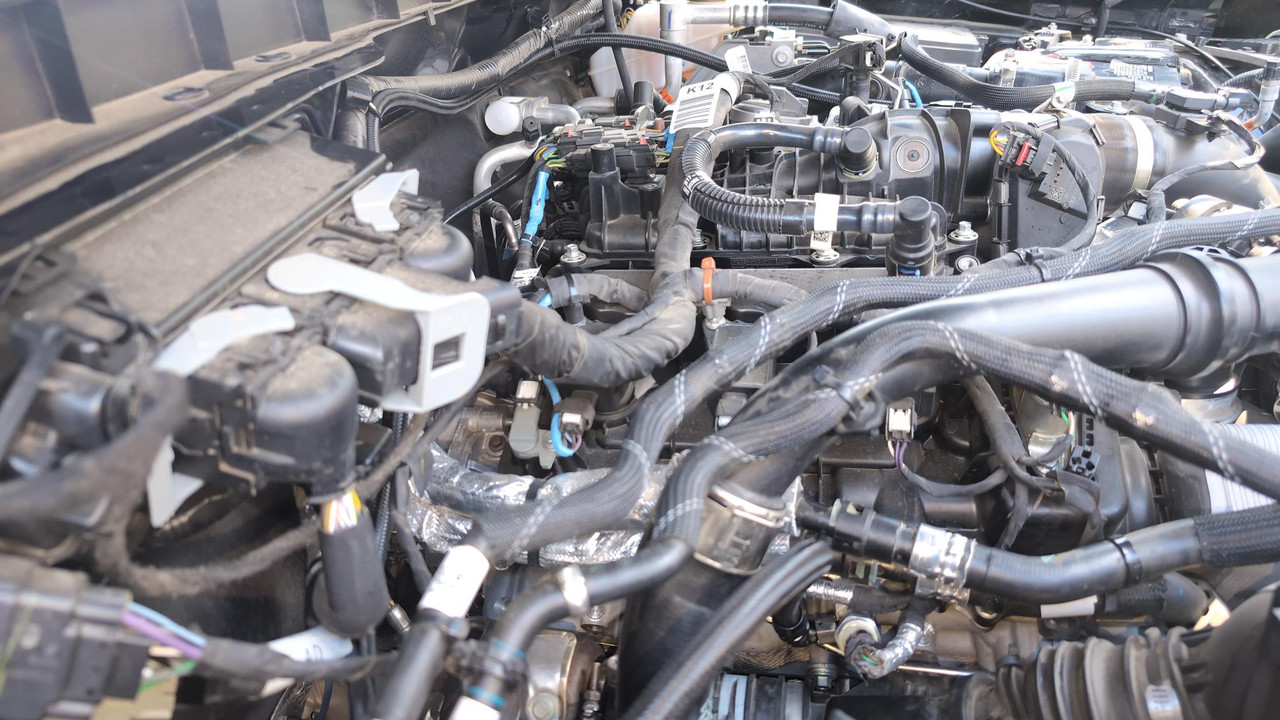

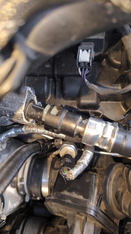

  • Reuse the o-ring from the oil pressure sending unit on the tee. The sending unit can connect to the tee with no o-ring or washer and seals with flat surfaces.
  • Most of the fittings, hoses, and hose wrap in the universal Frantz kit won't be used if you go the route of using the 6AN hose and fittings.

Here's the Q&A on the oil filler cap from Insane Diesel.
Q:
Does the following cap fit the 2.7 ecoboost? The cap I have is a Ford (F2GZ-6766-A) or EC-791.
Insane Diesel Cap fllc35fo
Q:
A: Yes, our Ecoboost cap will fit your 2.7 Ecoboost.
After looking at the compatibility list for the Boomba Racing Inc. FORD OIL CAP V2, I noticed it fit the 3.5L as well. I checked Insane Diesel and noticed their cap only said 3.5L so that's how I pieced everything together. My original path was going to be drilling and tapping the Boomba cap and then I found the Insane Diesel cap which is an off the shelf direct fit.
Boomba Billet Cap
There's a guy called Derek on youtube that had a 900k mile Powerstroke that he put on the Insane Diesel bypass filter at 100k miles. Insane Diesel also sells Lorenzo's oil (sort of like Amsoil boutique oil) that was started by John Lorenzo with his tribologist background.
The support and customer service from Insane Diesel is excellent in my experience. They stayed on the phone with me for an hour talking through various installation options and what the filter actually did.
Frantz is sort of old school salesy interactions and a very dated store front in my opinion. I exchanged messages with Mike (main sales person) at Frantz and it was a less than modern interaction.
Ultimate Setup
The ultimate setup would be if somebody made an aftermarket oil pan with aux ports (e.g. I have an spemotorsport pan on my Powerstroke). This would allow you to plumb in the return line directly to the oil pan eliminating the need to run lines on top of the engine and the oil filler cap purchase.
SPE Powerstroke Pan
I looked at drilling the plastic factory oil pan and using the bulkhead fitting in the Frantz kit for my return line. After looking at it further, you'd have to drain the front diff, pull the axle, and pull the electronic steering unit to remove the oil pan. That was too much trouble to take a chance on the factory plastic pan. If SPE or someone else would make an aluminum pan - especially if it held an extra quart - I'd do that upgrade and eliminate the oil filler cap return hose and cap. That combination would give you a total of 8 quarts of oil with the bypass filter.
The oil sending unit tee seemed to be the lowest cost, easiest, and most logical place to get the input/supply line plumbed. I looked at that Baxter spin-on converter above and it looks to have an aux port that you could tap in to instead of using the sending unit. That part is crazy expensive and the dry start issue is probably the reason why you'd want to buy it. That would drive the cost up to ~$1k though.

Glad to know I have an oil return cap source. I was thinking about making my own too but needing a leak proof swivel concerned me. I appreciate you verifying that.
I have used a return to the pan on two engines, but when I saw the plastic pan on my Bronco, I felt very uncomfortable putting a fitting in it. I am pretty sure there is an after market aluminum pan for the 2.7L EcoBoost, but the install is more than I want to take on. I can live with the return to the oil fill cap just fine. I just hope having oil flow in there all the time when the engine is running does not create a problem.
I intend to use the oil sending unit tee for this install as I have in the past. It is a lot more accessible on the Bronco than it was on my two Rangers. Never had a problem with the tees with almost 200K miles on my 89 and 307K miles on my 2002 Ranger.
