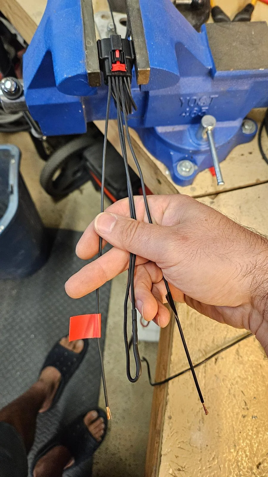

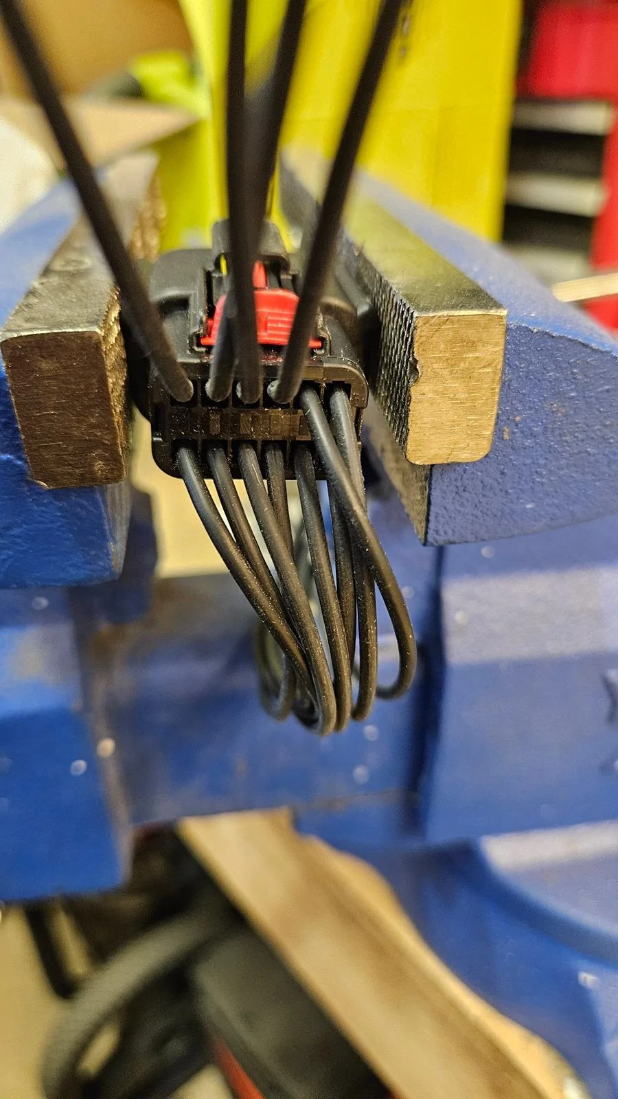

I just rewired mine to match the in series 6Volt suggestion. Wire 1 should go to your aux switch, wires 2&3 get tied together, wire 4 to ground. Worked perfectly for me.
Right, wire #1 to the switch.
Yeah that's another nice thing about this install, it works with any of the numbered upfitter / AUX switches. Current draw is around 2.6A and they are all rated for at least 10A.
I've used mine several times on the trail now and it's working great!

I found the info in this site invaluable for doing this mod on my 2024 Wildtrack and wanted to share some things that I learned. I am new to this forum, but have been wheeling and mod'ing jeeps for 15+ years now.
  1. The new part number is MB3Z-5482-X. It has good availability and can be found online for ~$1300 shipped.
    • The raptor part number is NB3Z-5482-B. No idea what the difference is.
  2. Highly recommend the wiring harness pigtail: https://www.ebay.com/itm/254762922777
  3. The 4 wheel parts transmission skid plate 61271W works wonderfully with (and without) the new sta-bar disconnect. It fits great with about 3/8" clearance to the new sta-bar, and gives a nice smooth under-belly surface with no blocky thing hanging down to get hung up on rocks like some skids I've seen. My Wildtrack has the 2.7L and this fits with the extra diagonal supports that the larger engine has (hence the triangular shape). Plus it's cheap compared to all the boutique shop options. https://www.4wheelparts.com/p/4-wheel-parts-transmission-skid-plate-61271w/_/R-4WPBR-61271W
  4. The electronics on the sta-bar consist of 2 identical hydraulic solenoids, and two pressure sensors. No safety keeper pins or anything else. To hook up we need to wire the 2 solenoids to a switch and that's it - we just ignore the pressure sensors since those would need to go through a computer to be useful.
  5. When routing the wiring, attach the plug on top of the crossmember facing the front of the vehicle and bring the wires toward the front then up just behind the A-arm mounts on the left side. This avoids the super-hot catalytic converter (though I did still use some fire sleeve, just to overkill it a little https://www.amazon.com/gp/product/B0C45M7Q5J/?th=1).

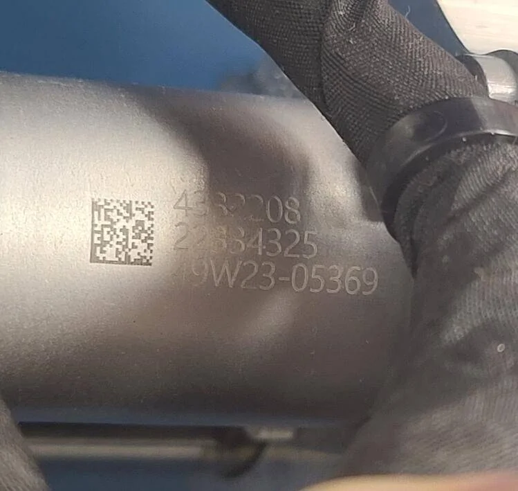

I did try to find some specs on these solenoids, but struck out. Here are the numbers printed on the side:
4332208
17w23-00045
22334325
Now one thing that most solenoid mfg's typically do is put the designed power in Watts somewhere on the unit. I think that's what the "17w" is.
Now the good part - at ~6.6 volts the unit draws ~ 2.6 amps, which is ~17 watts. So if we wire the two up in series they each see half the voltage from the battery, so 6-7 Volts, which is perfect to keep it in this 17 Watt range.

So to wire it up in series like this, what you want to do is connect the - from one solenoid to the + from the other, then the remaining two wires go to the battery. Looking at the wiring pigtail from the side with all the wires coming out and the red tab on top - starting at the upper left wire 1 goes to battery +, wires 2-3 get connected together, and wire 4 goes to battery -. I tried to get a couple of pics showing which wires I mean. The red electrical tape flag on the left goes to +, the black flag on the right to -.
Another nice thing is that any of the upfitter switches can handle the 2.6 amps of this setup, while only switch 1 can handle 11-12 amps if you use the full 12 volts.
I really hope this helps the next guy or gal interested in doing the mod. Once I did my testing and decided how to wire it up it was an easy mod, took a Saturday afternoon.
4332208
17w23-00045
22334325
FYI The line 17w23-00045 is the date of manufacture and serial number. 17w23 represents the 17th week of 2023. 00045 is the serial number. The solenoids on the disconnect I just received are labeled 49W23-05369 and 49W23-05375. both manufactured in the 49th week of 2023.

Not sure if that invalidates your other conclusions about their Voltage however. The thermal testing does seem valid - if they are getting that hot at 12V, then Ford must be using PWM at a low duty cycle.
