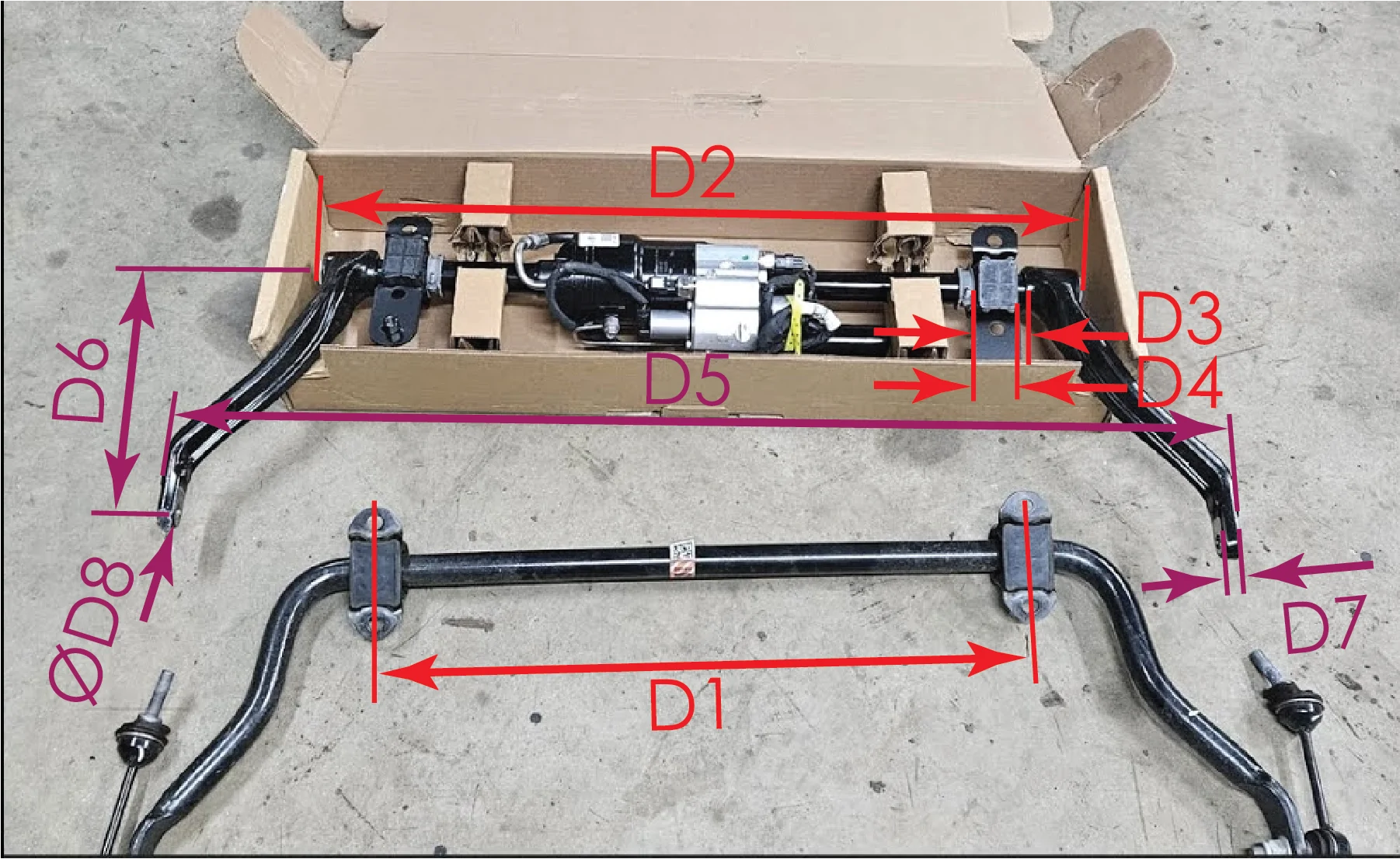

Greetings Bronco community! I am seeking details about the electronic disconnect sway bar. My intent is to fit it to a different vehicle. I would like to thank @North7 and all thread participants for amassing a great deal of information on this topic already.
Specifically, I'm seeking the below dimensions, with D1-D4 being most critical to my decision -- if those are within the range of plausibility, I'll buy one and see if I can make it work. If D5-D8 work out in my favor, it might even be easy. I doubt that's the case, as I can't find any evidence of anyone yet fitting these to my vehicle -- a highly popular mid-size pickup truck. But there's always hope!
Ford Bronco BWI Bronco Stabilizer Bar Disconnect Technical Information bronco sb illus
I humbly beg anyone reading this to attempt measuring any of these dimensions on their Bronco -- just bring a tape measure next time you're under your truck and snap some pictures. Even if you're just eyeballing it... I will buy you a beer or a coffee for each dimension -- your choice.
D1 is the distance between mounting bolts on either side of the frame -- preferably measured on the frame of the truck.
D2 is the overall axial length of the unstrained torsional tube assembly, including the end bolts.
D3 is the distance between the inner shaft collar and outer arm sleeve, and D4 is the width of the mounting bushing...
...so with D3 and D4 I can estimate the axial elongation and contraction of D2 in the unlocked configuration. You could also just push the bushing to either side on a dismounted sway bar, and measure the gap between it and the opposing stop, but I couldn't illustrate that clearly in the image. Anyway, I need this info to figure out if the tubular assembly will fit my frame and clear my tires over their range of steering and suspension travel. I am neither a vehicle specialist nor a complete novice, but I can machine and weld things, poorly but very enthusiastically. I also have friends who do such things professionally, and am willing to burn some favors.
D5-D8 would be useful to determine if the arms might even be useable on my vehicle. I doubt that's the case, but if the torsion tube assembly itself will fit, I can fabricate (err.. commission the fabrication of) arms suited to my vehicle. The sway bar will be installed upside down on my vehicle -- leading the axles.
I am further curious if the arms are made of spring steel -- in other words, if they bend along their length as part of the 'locked' sway bar configuration. The animations suggest not, and they appear to be cast or forged chunks of grade-A beef, which gives me hope that I could lop them off near their base and weld on new arms to link up with my suspension.

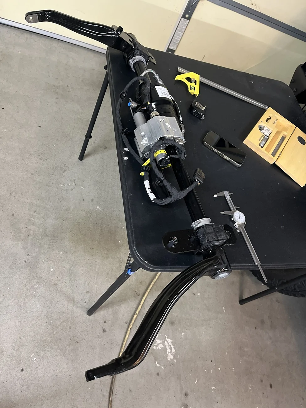

D1~=27” (out of box, not installed, so not positive, yet) This weekend!!!
D2~=34.25”
D3 Inside of arm to inside of flanged clamp~=2.3”
D4 bushing width ~=1.75”
D4 width of mounting flange ~=2.1”
D5~=43.75”
D6~=12.5”
D7~=0.67”
DIA8~=0.55”

Thanks Keith! You are a scholar and a gentleman -- and I owe you some beer and/or coffee. I know you posted this several months ago but I just saw it (doh) and am eagerly heading home to measure my truck!
