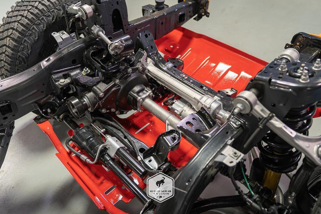

Ford Bronco BWI Bronco Stabilizer Bar Disconnect Technical Information ima
looks very well protected by the forward bash plate. Might be a bit of a challenge to do manual disconnects if the bash plate is installed.

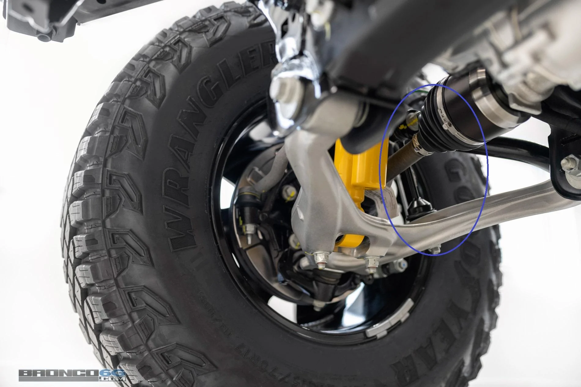

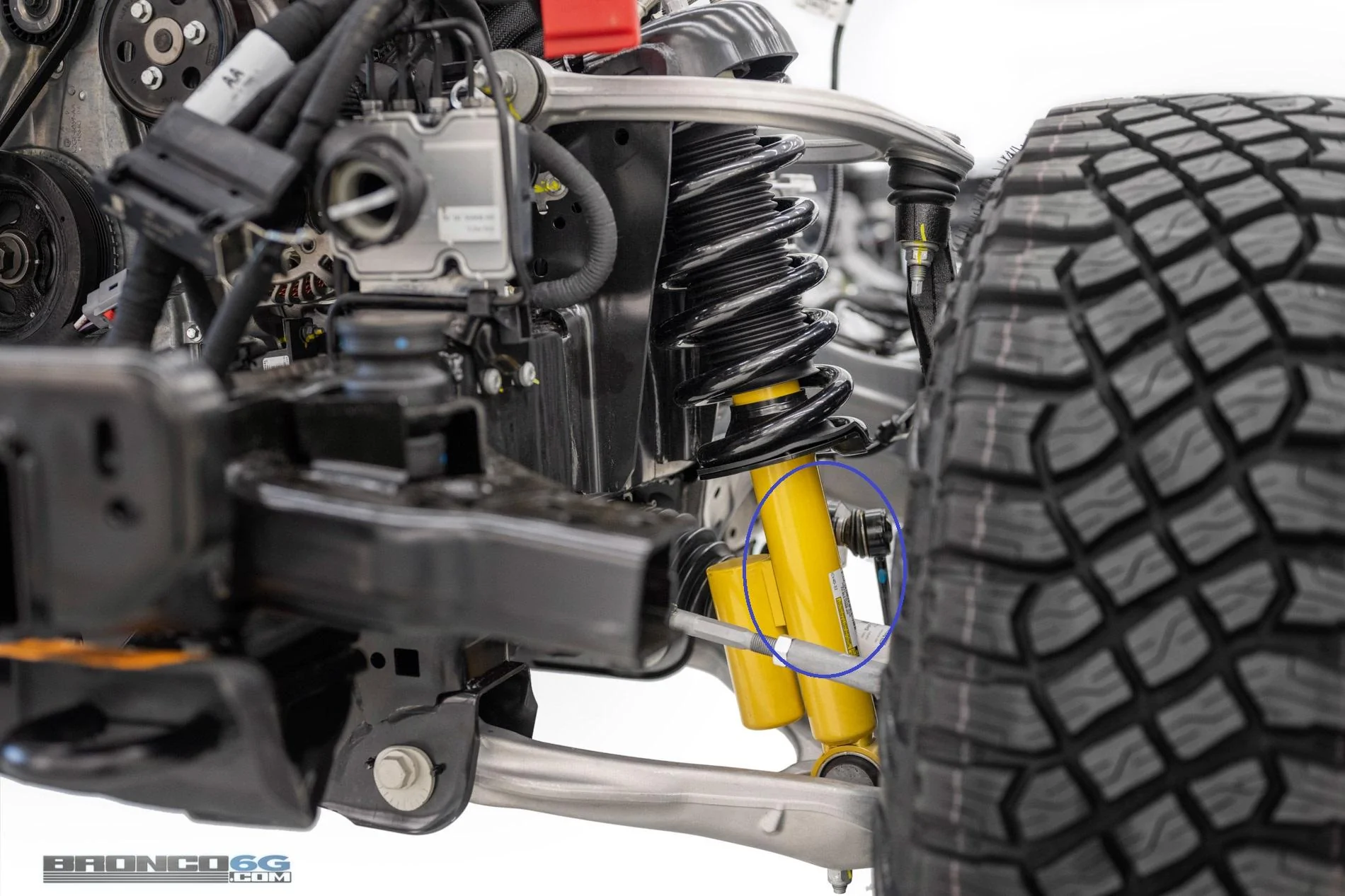

Manual disconnects would be where the circled items are and they are outside the frame. Should just need to turn the tires to get enough room to pull a pin or turn a nut.
