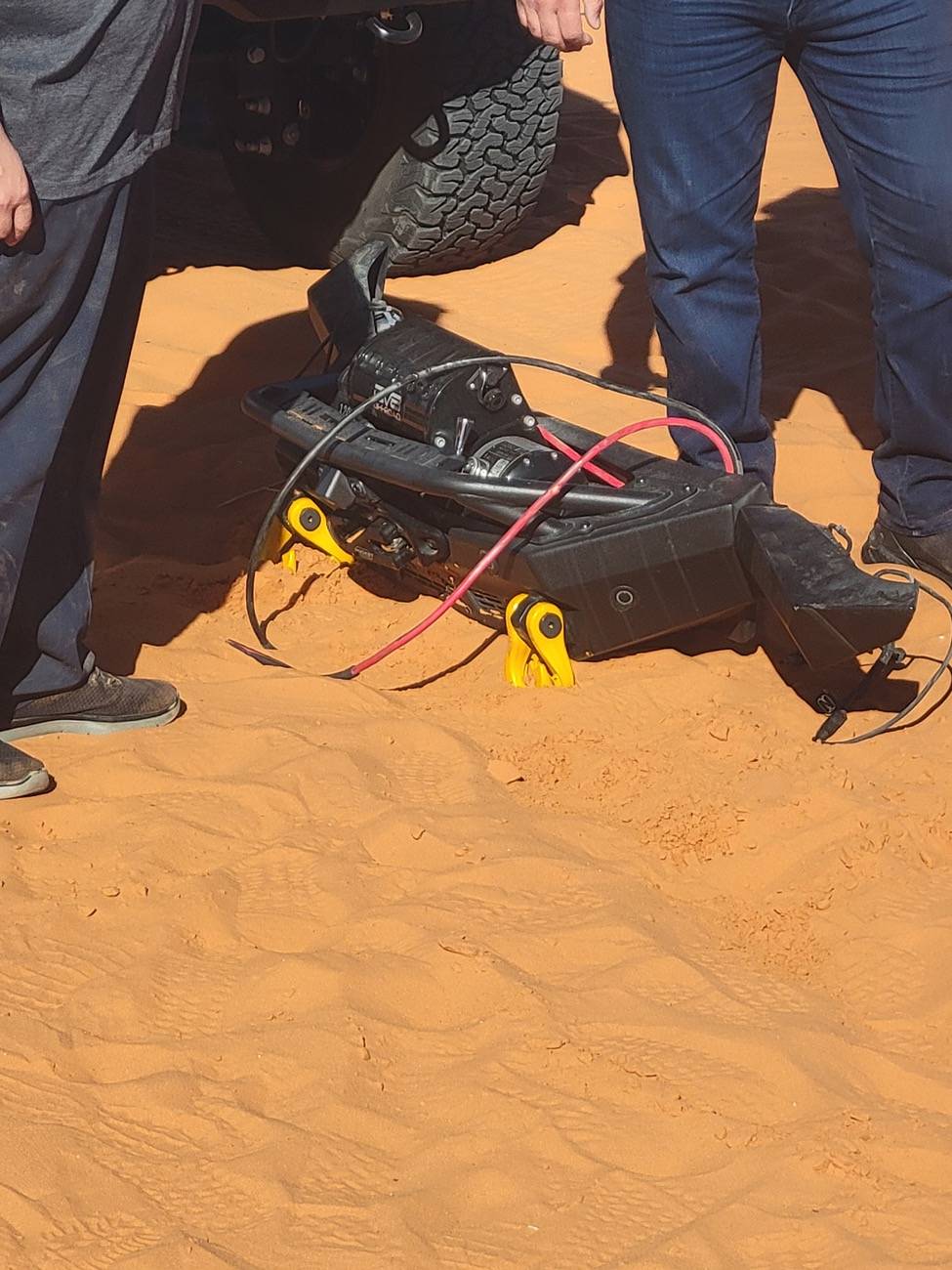

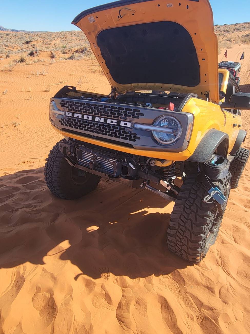

Alrighty. I know the owner. In fact I invited him to run that trail. That day I also disconnected his driveline after the D60 had issues, and reset his computer to give him front wheel drive for as long as possible to get him to the sand that day. Here’s what happened: A flat strap was hooked up to both recovery points on the bumper. A flat strap was decided on as there were still many climbs on the rocks to get out, and a potential energy rope can sometimes cause issues pulling the tow vehicle back in steep rock crawling situations. They successfully pulled him all the way out of the rocky bits without issue to the dunes, and by then the tow vehicle became hot and needed a break. At this point random raptor dude that noone knew offered to help. They were going to swap to the potential energy rope for the sand but for whatever reason decided to just run how they had it. Raptor bro slowed down before starting the climb, putting slack in the strap, then gunned it for momentum, pulling the bumper cleanly off the non-braced OEM mounts and damaging one side of the bumper with the way the mounts broke off.
I make fun of @dv8 a lot for their preposterous branding choices, but they were actually pretty badass and are sending the owner a replacement bumper for free.
Thanks for the info! I was hoping someone was in the know. Glad he gets a free replacement. Sounds like it was a very hard hit.
You said a flat strap was hooked to both recovery points, how long was the strap?

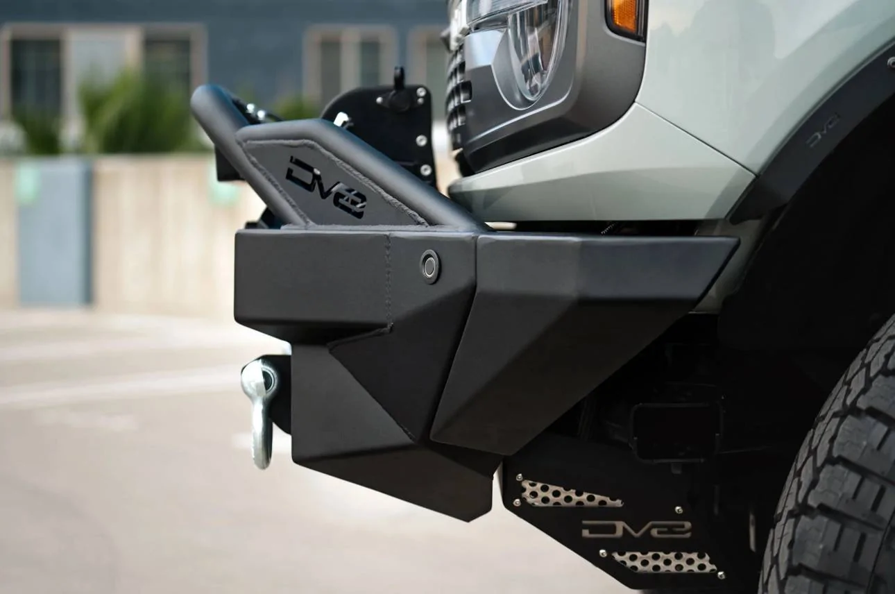

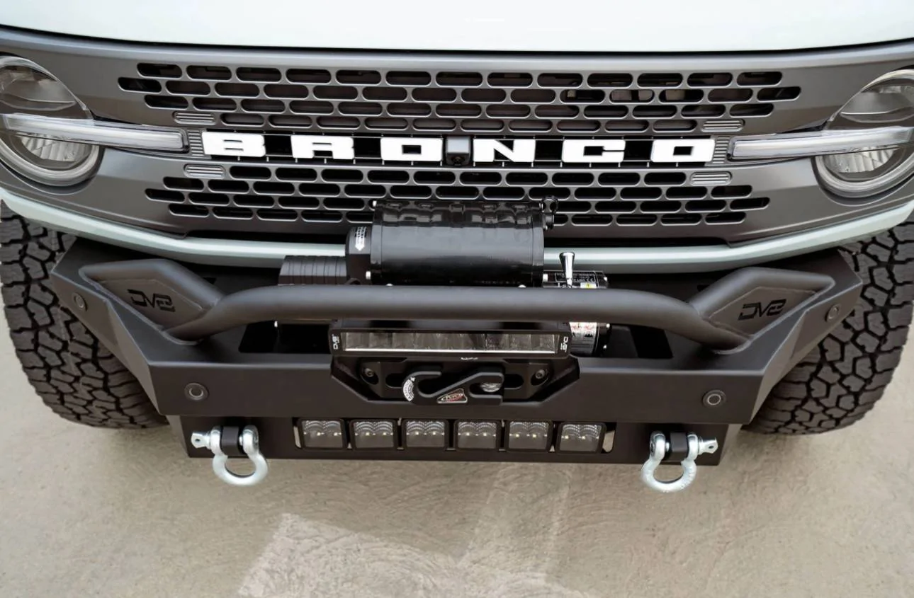

Not to knock DV8…
Any thoughts on the location of the recovery points on that bumper? I suspect they’d create additional leverage being located ahead of the winch and that much further away from the frame horns.
I didn’t look at the specs myself but based on how far it was from the tow vehicle I’d venture a guess at 30’

Not to knock DV8…
Yes - I mentioned this in an earlier post in this thread:
From the video evidence, the flat nuts definitely pulled out of the bumper on the passenger side - this could have started due to bending of the frame horns before they failed, or it could have just been very high twisting forces on the bumper. With that bumper, the recovery points are offset and in front of the frame horn connection, so any recovery force is going to create a twisting force on the bumper and frame horns. By comparison, the stock bumper has the recovery points directly attached to the frame horns, so they will withstand higher loads (even without reinforcement).

Starting in the video below at 15:50, apparently a broken Bronco was being towed in by a Raptor, and at some point the Raptor gave it a hard yank,
Edit: A witness said they used a flat strap to connect to both recovery points, so I was wrong about that part.
The real heroes of the story here.
tow strap + hard yank = broken parts, and a high chance that someone dies.
Need to use a bridle to tow straight? sure, makes sense, get a damn kinetic rope that's 15' long then

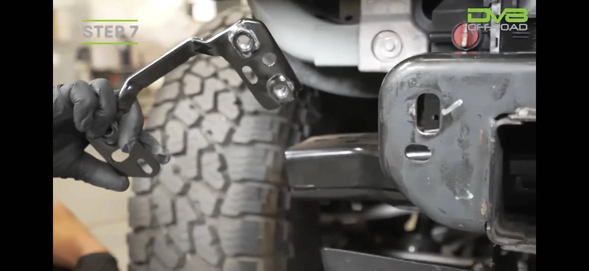

DV8 knows about the frame horns and has since 2023 when they bent theirs. They do not mention anything about them in their installation instructions and when I looked up that bumper they are not mentioned on the sale page.
That being said, recoveries are not as easy as just watching a few youtube videos. It takes some trial and error plus good feedback to be safe out there. I watch a few recoveries that got lucky, not enough knowledge and too many "experts" chiming in. I witnessed two recoveries on open hooks that easily could have detached and ended with a rolled Bronco.
