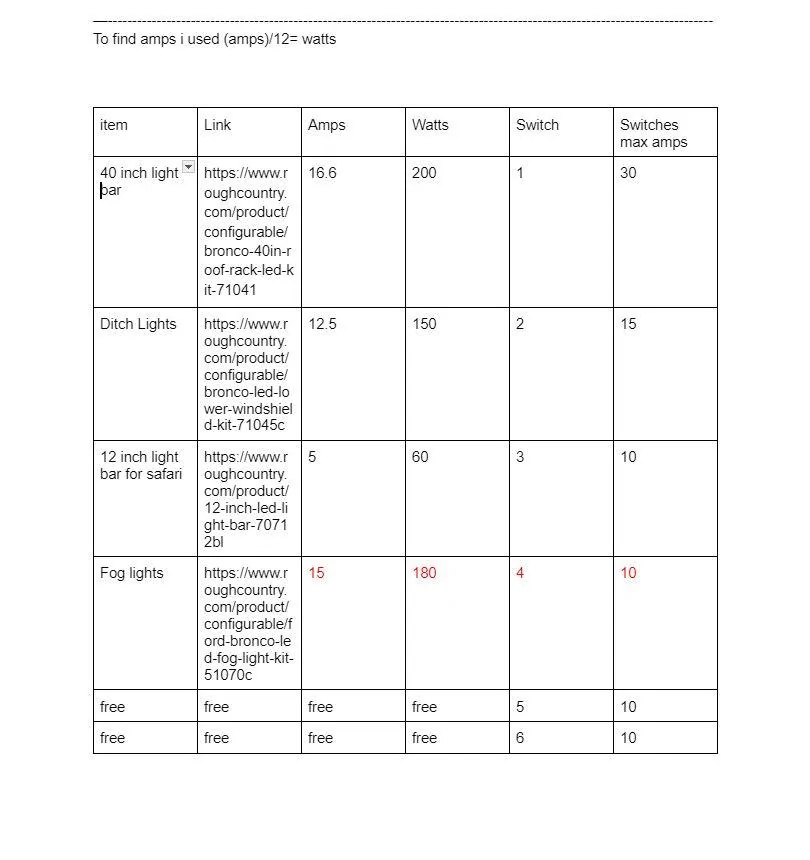

This is where im at, i would rather not HAVE to give anything up but i cant figure out how to rearange this so that i can have everything i want. I dont want a compressor or a winch the only MASSIVE amps ill draw are on the 40 inch bar. any advise?

You can use a relay to get under the max amperage...12v power from the battery to the relay then to the fogs...aux switch to trigger the relay.
EDIT: Install in-line fuse on the 12v supply before the relay.

Others have mentioned this, but you will not be using your switches power for things like a winch or compressor. If you decide to use a switch on those accessories, you will need to add a relay to the system and only use the switch to trigger the relay, the relay will provide the power from the battery to the accessory. Generally, you will not have a dash switch to power the winch. Some lights can use the factory switch, many will need the higher output of the 15 or 30 amp circuits. In my case I have 3 lights (ditch, fog and winch light bar) one GMRS radio. The highest two are lights and they use the 30 and 15amp circuits. The other use the 10amp. If I add a compressor in the rear (potential plan) I will need a relay to get the 30+ amps to the compressor. The switch will only trigger the relay and the relay will be wired to the battery (with a proper gauge wire to handle the amperage load and distance of the wire from battery to device). Hopefully that helps a bit.

I'm piggy backing on this post a bit. I thought I'd read somewhere here that the AUX switch wiring was considered a bit undersized or minimally sized accord to a few posters. Don't the AUX switches attach to relays that you then attach wired accessories ? If that's the case is the factory AUX wiring size really an issue ?

I do believe that the aux wiring gauge thickness is just making it by for the amperages listed. I'm not aware of any aux relays, just fuses.

Coming from the electrical world,
The switches have different amp limits. But they all have the same gage connection wiring (#16). For switches 3-6, yeah, that will work given the amp limit. For #1 and #2, with an amp limit of 30 and 20, that's a bit smaller than I'd run for the entire run, but given that it's just a short pigtail coming up from the relay, it probably won't hurt anything at those ampacities -- as long as you use larger gage wiring going out to whatever accessory you are wiring in.
The pre-run wiring - that's a different ballgame, and you are on your own to make sure you don't exceed the ampacity of the wire. They are just some pre-run wires that you can (or not) use if you want to for just about anything.
