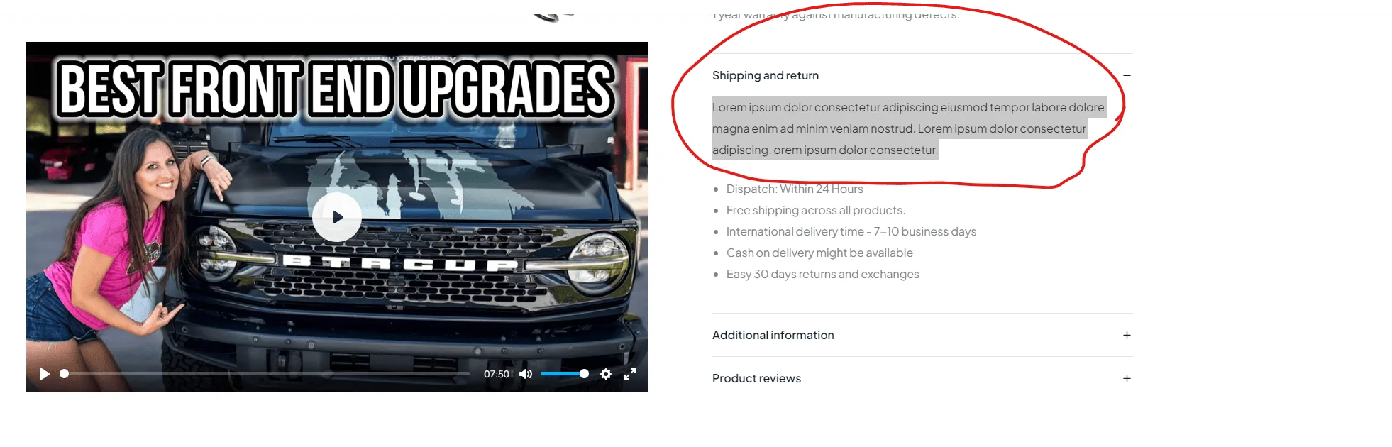

BuckleUp looks like a drop shipper for most of the products....she needs to get with her website designer to delete the "stock" text in the website template.
Rookie mistake....

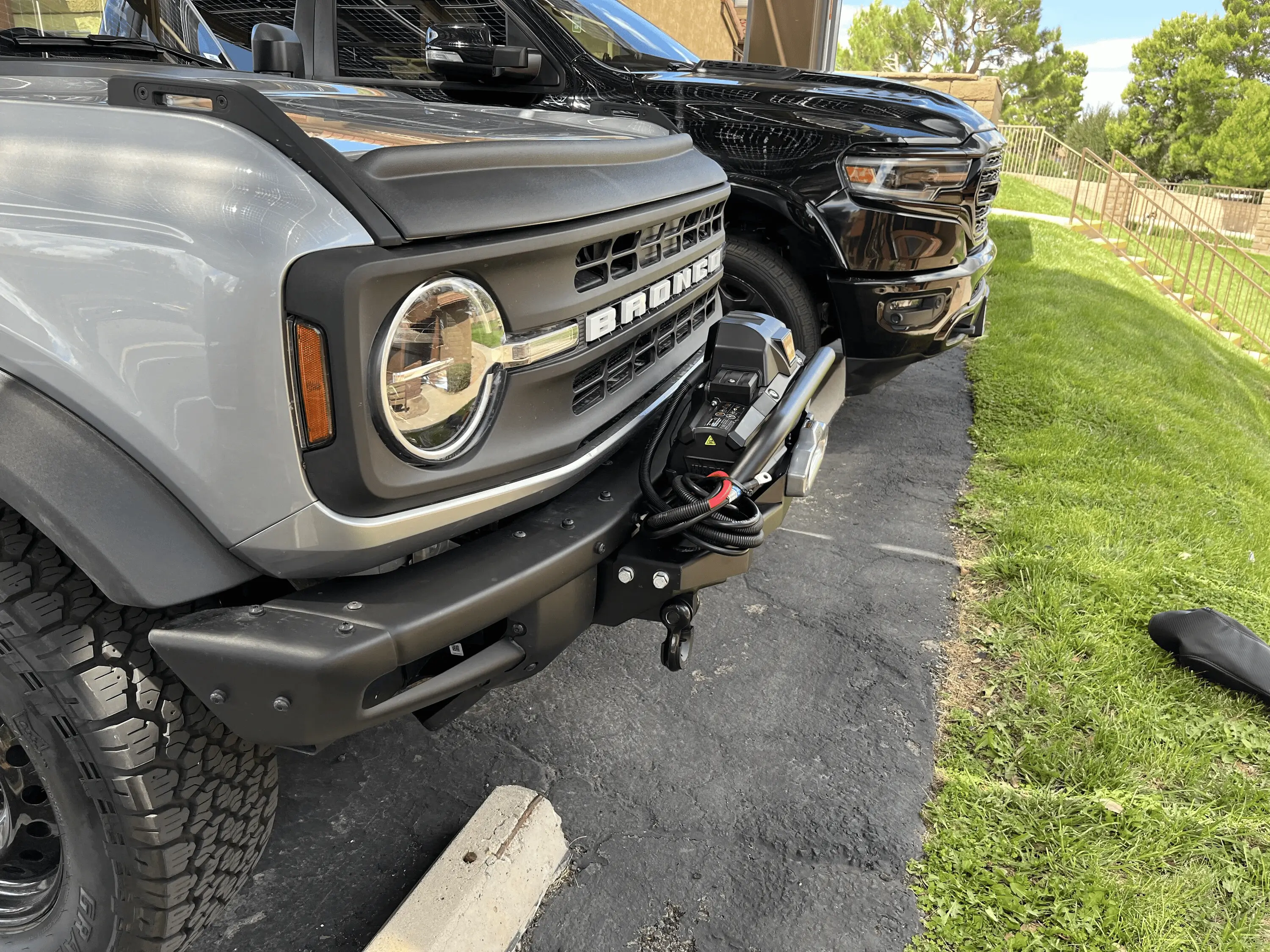

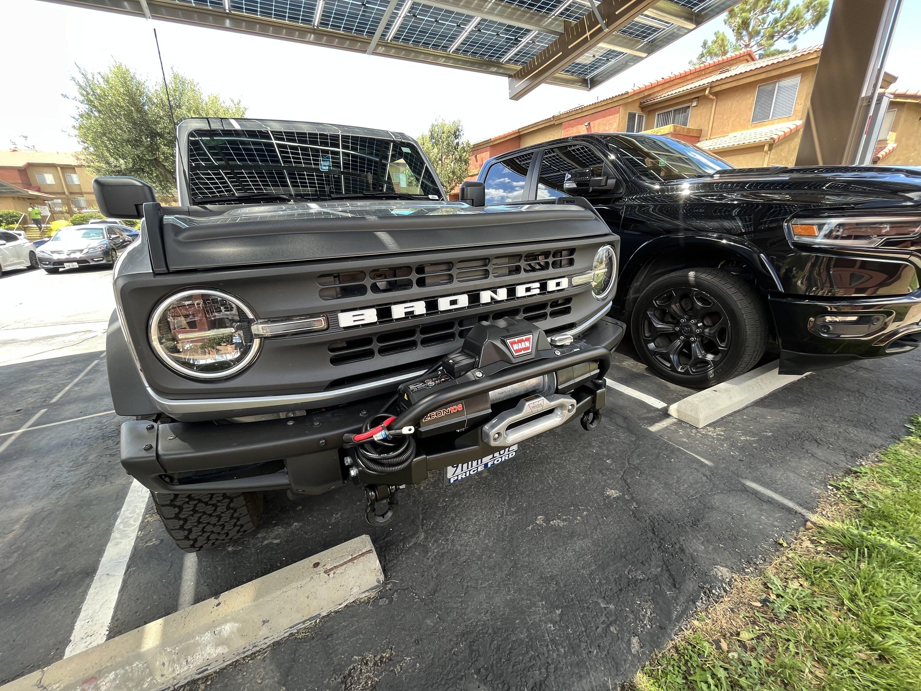

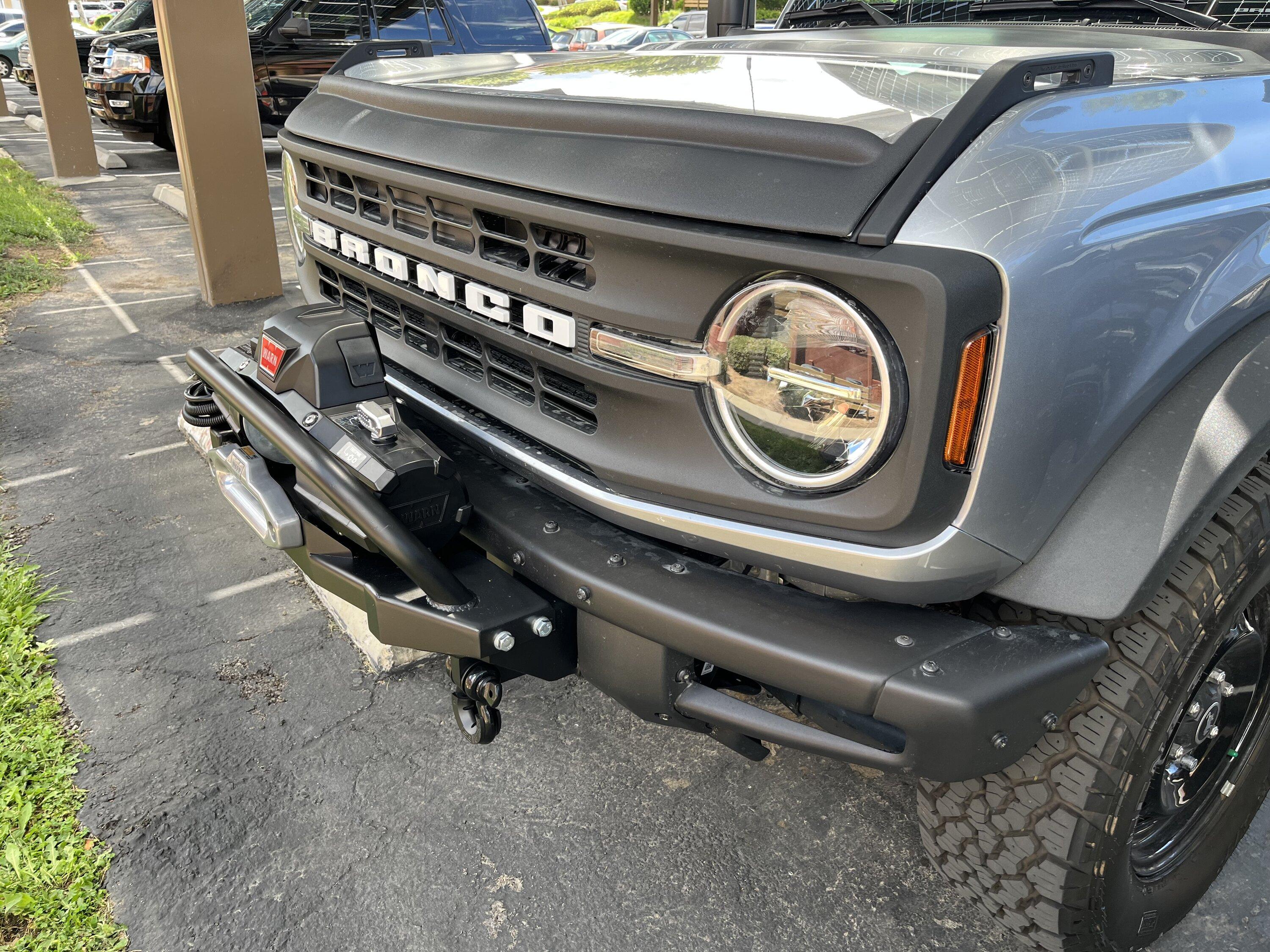

Here's my IAG I-Line Modular Front Bumper Winch Mount setup, including a Warn Zeon 10s winch, which I just purchased and installed today.
I still need to wire it, as well as install the rope.
It was an easy install, w/the only issue being, needing to run a tap in the threaded holes, because of paint and such.

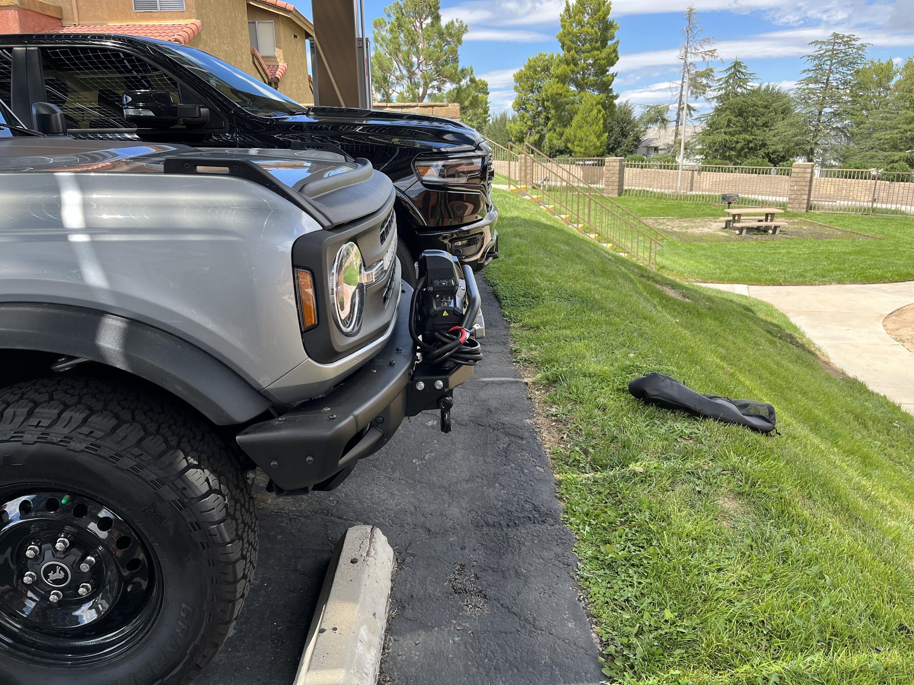

I considered the Warn VR EVO 10-S Winch but was told that it didn't fit my IAG I-Line Modular Front Bumper Winch Mount, while the Warn Zeon 10s did.
Plus, it was on sale, as well as in stock at a local 4WP store.
Just need to wire it up. 😉

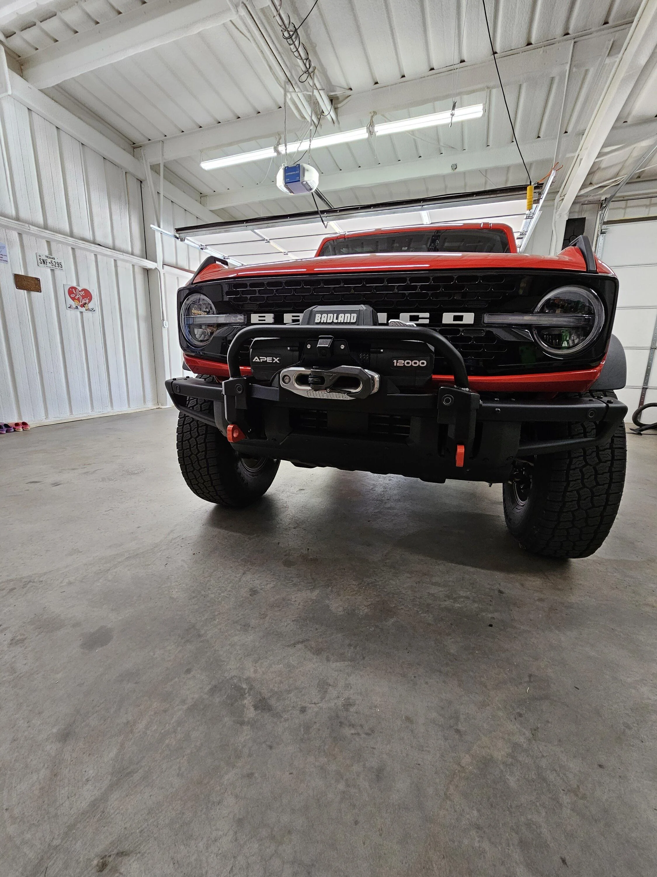

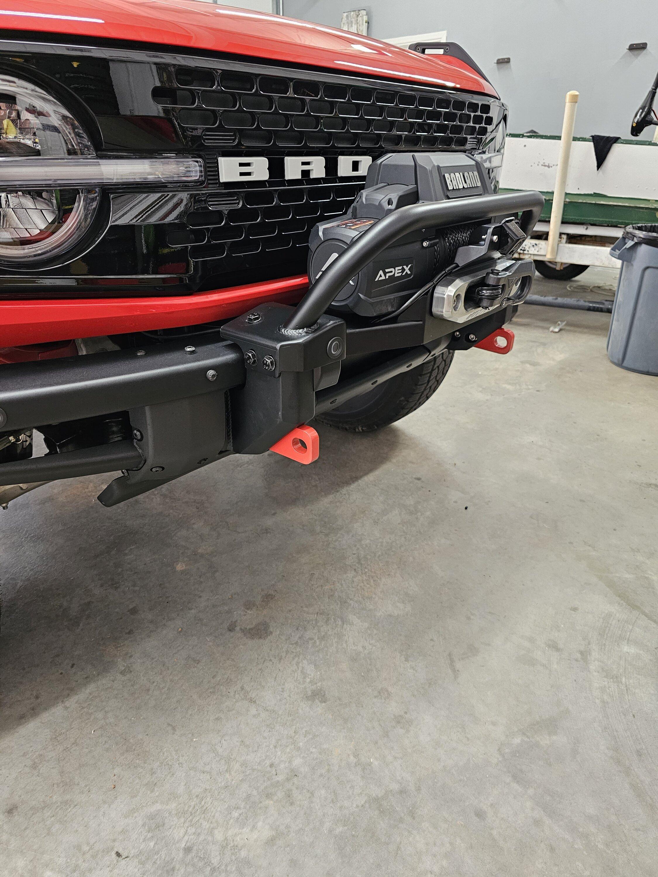

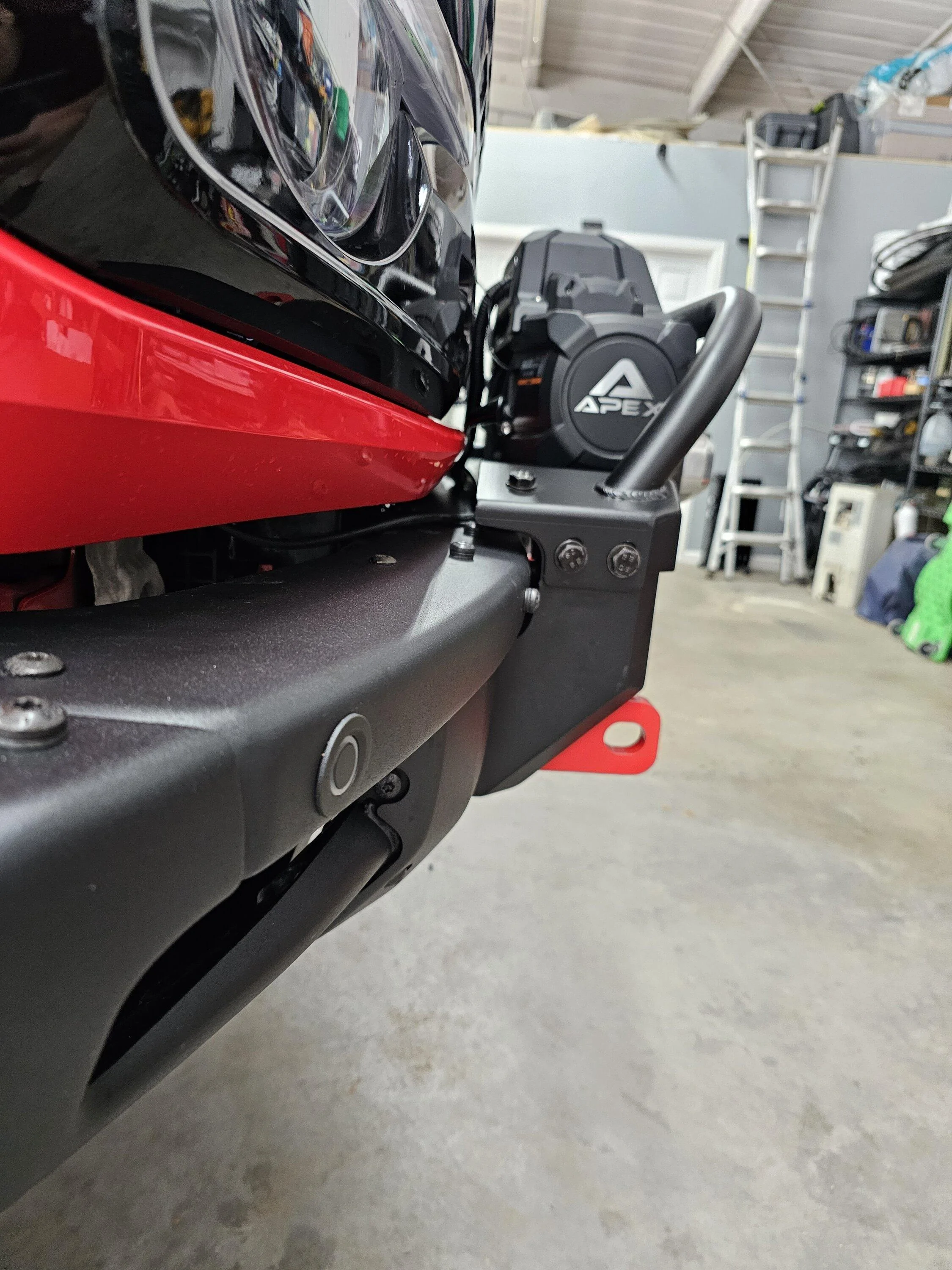

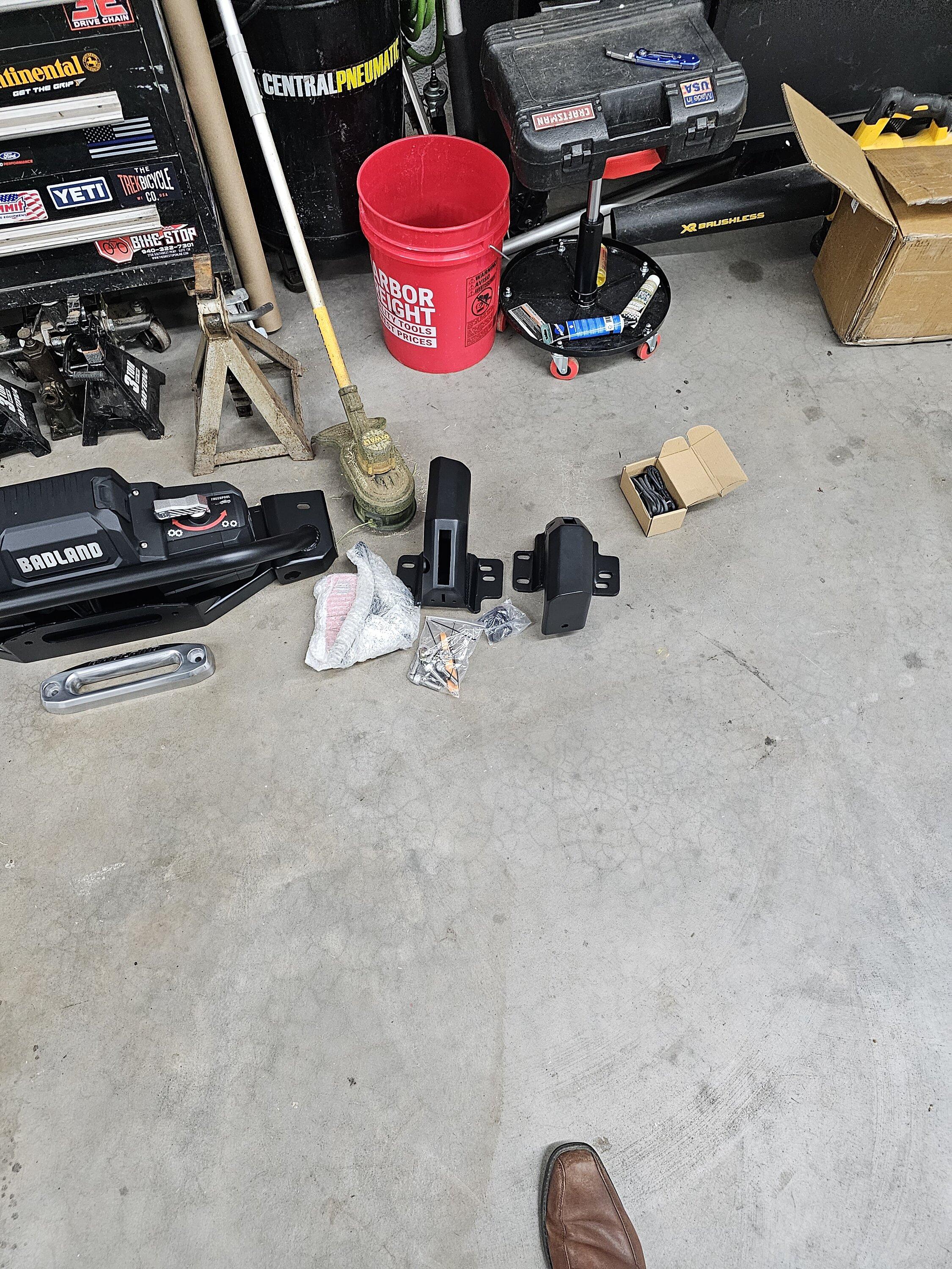

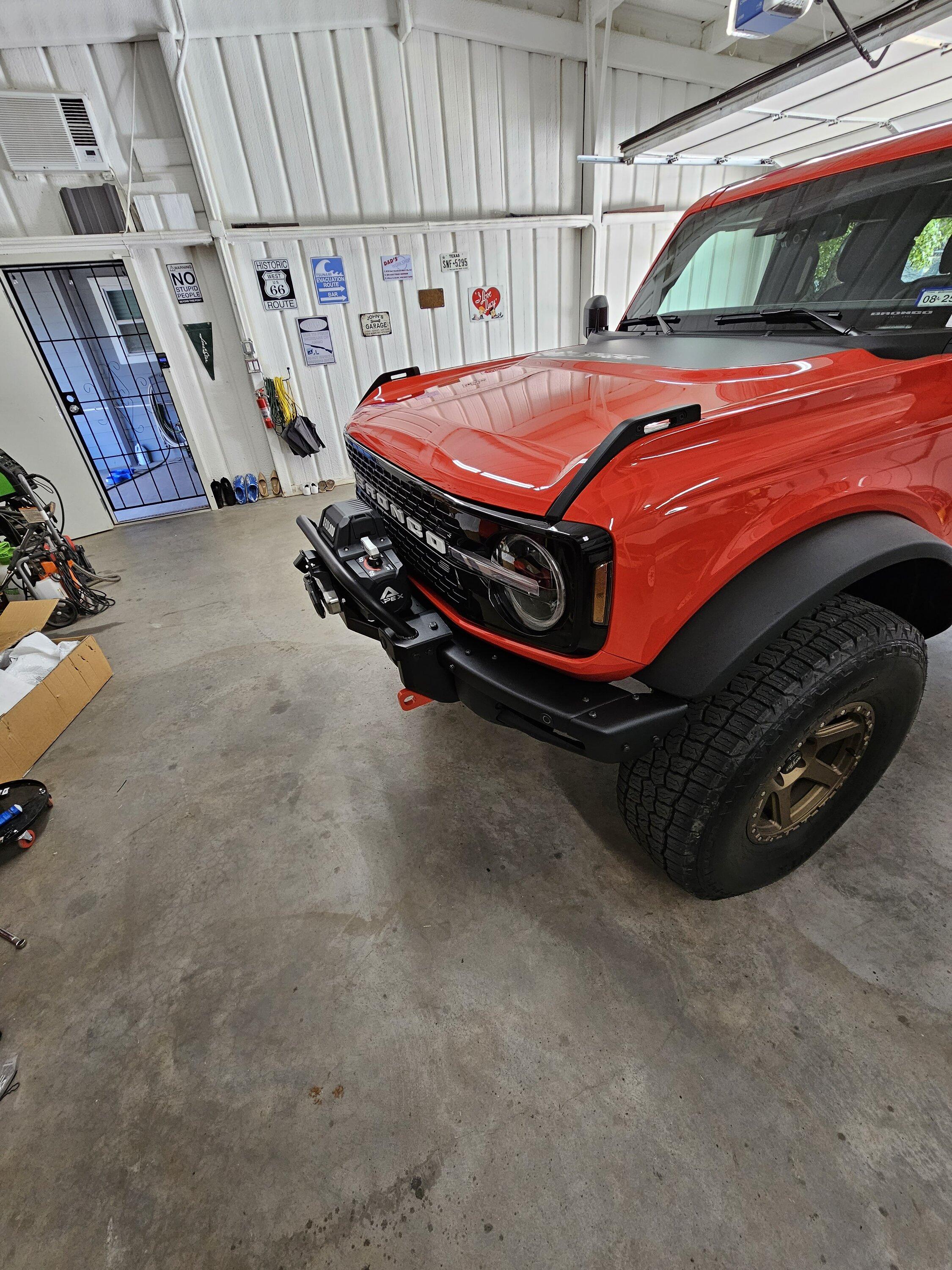

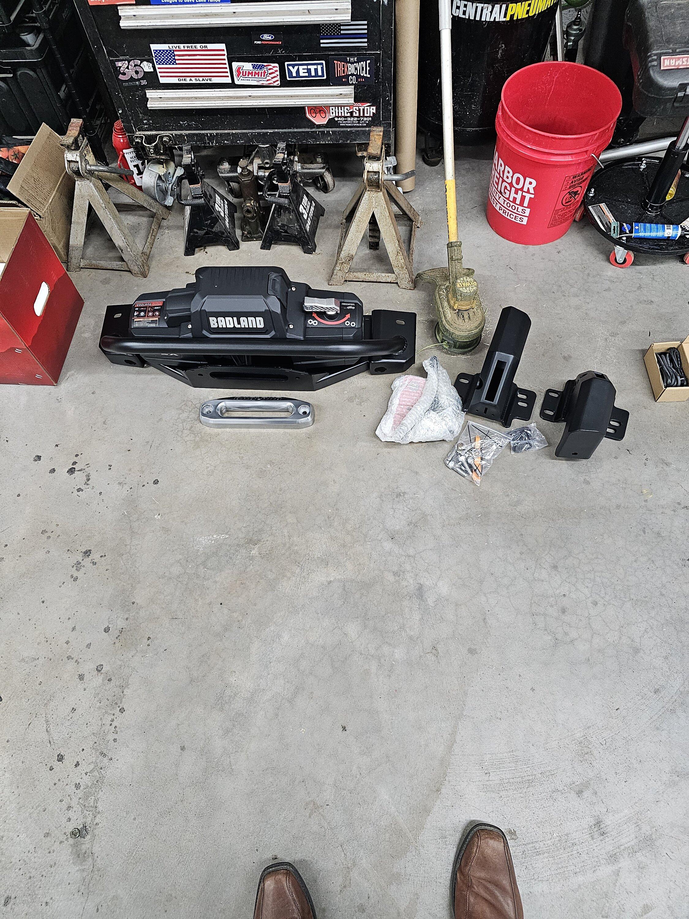

So an honest review so far is that it is very heavily built with good welds, install instructions could use a little work but if you have decent knowledge of wrenching you will be fine.
The finish is painted, but would probably last a couple of years, with the exception of the painted zinc hardware (the 6 bolts on top the rest is stainless). The beautiful part is that is Adaptive cruise, parking sensors and front camera all work with no issues.
I chose to go with 12k Badlands Apex winch, well because it was easy to get and return if needed. Also I figured if Matt's off-road recovery uses them on their recovery wrecker then it is probably good enough for me. I also looked at Smithy Built and Warn Evo (Evos seem to have issues).
One thing to note is this mount goes around the modular bumper but does not bolt to it. It is instead sandwiches the bumper from the front. I didn't do any frame reinforcement but I probably should, because I could see the amount of leverage being great with the 12k winch.
Only issue I had was the Aluminum Fair lead that came with the winch had to be mounted upside down to clear the sharp bend of the camera mounting bracket.

very nice! i looked at some of the other options (including the IAG twhich this is a near clone of. IAG is located just a couple of towns north of me) and all the add-ons options for mounting the camera were more than 50% of the cost of the buttercup!
how much did your front end sag with the additional weight?
