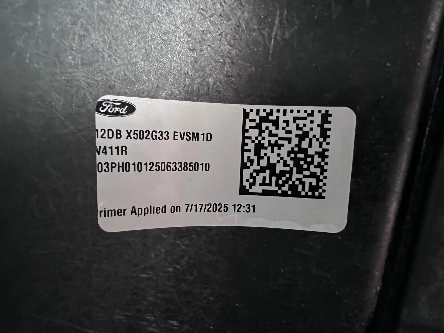

Also, there is no such thing as a factory painted MIC top. There are painted hard tops, and there are MIC (molded-in color) non-painted hard tops.
… MIC molded in color may no longer have color molded in.
I have a new 25 Bl 2dr built 7/20/25 ordered w MIC top, there’s a ford sticker that states primer was applied on 7/17/25. Guess it was finished painted after that.
It looks like it was molded like the ā€˜black’ painted top, just doesn’t have the port hole.
I have a new 25 Bl built 7/20/25 ordered w MIC top, there’s a ford sticker that states primer was applied on 7/17/25. Guess it was finished painted after that.
The primer the sticker is referring to is something applied to the inside, not the outside. They all have that sticker.
As @Ducati1098 mentioned, that primer is the interior. Still doesn't change that the exterior color is the thermoplastic molded in color. Early MIC tops have an unfinished interior except for the optional headliner.
