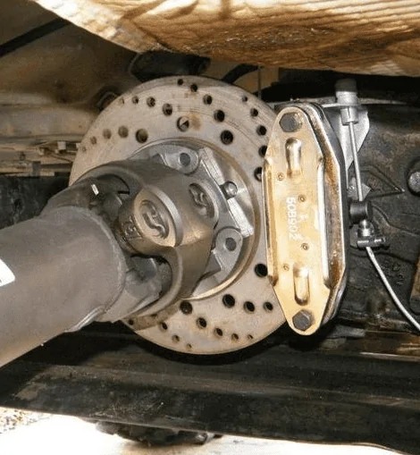

I've had trucks roll backwards while off road and it is scary and no fun. Once it stalled and the surface was so soft that clutch out it was sliding...surprisingly the parking brake locking everything up got it stopped (full set of lockers and a driveline parking brake).

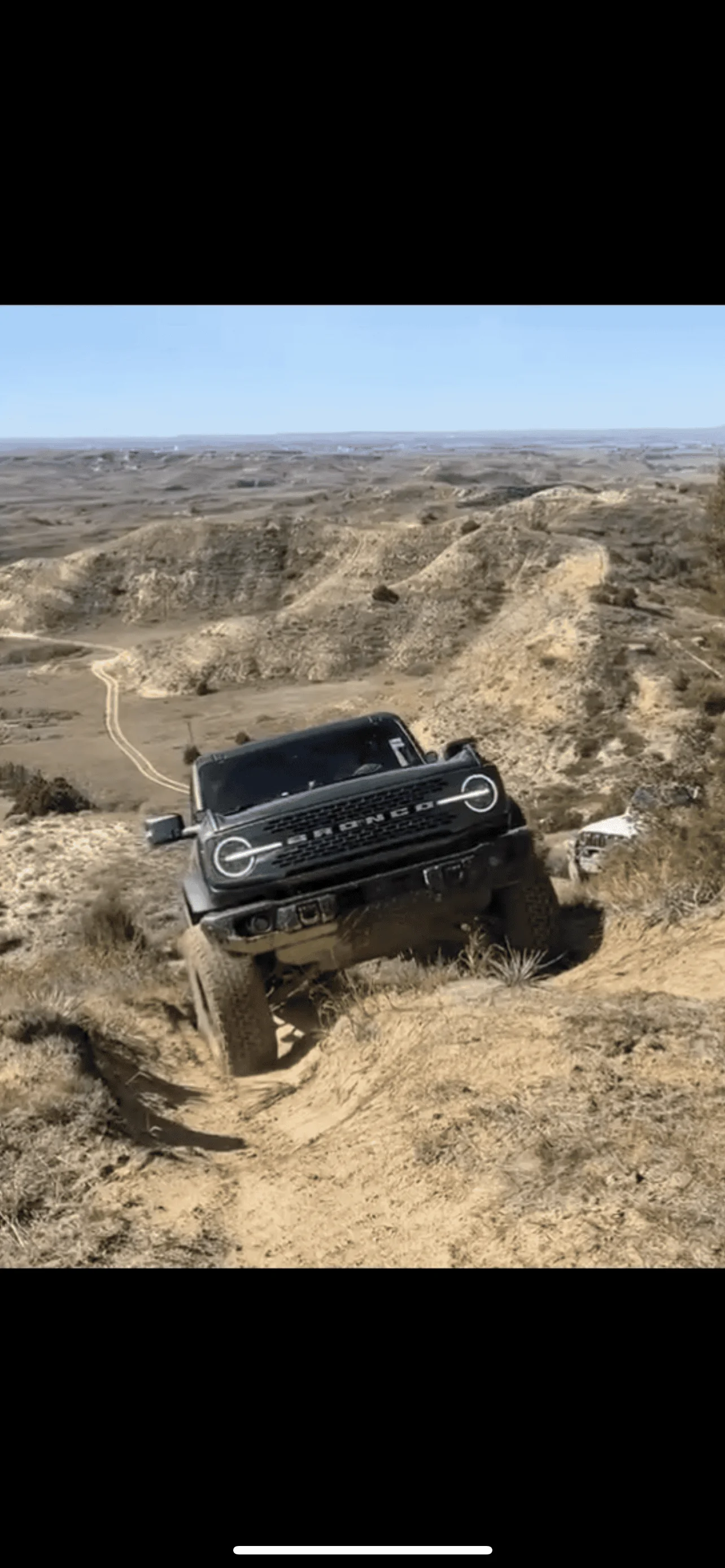

Man that's scary! I've been on some steep inclines with steep drop offs! That is a very scary thought! I do have a 4dr Auto though so maybe that will be the difference. The picture below is a 32 degree incline with a major drop-off 40 yards behind me. That would problem kill us. Scary thought to think that could happen! Please update!

So I am no expert off roader, however, I would hardly say I'm green. This happened today and I am at a loss, possibly financially, but more importantly I don't know what actually went wrong. I have wheeled plenty of times in this Bronco since Aug 2022, I have been up this hill...successfully twice before...with plenty of witnesses🤣. I have been up many other hills, in fact this wasn't even the steepest today, as I had done a 39 degree hill earlier, this one was likely upper 20's, lower 30's. I have stalled the Bronco before, it's always restarted before and I've never lost brakes no matter at what angle and what grade. So I really have no idea what caused this. It stalled out around a 1:00 in and I lost power to everything. I did like everyone else yelling brakes, LOL! Tailgate is shot, bumper is shot, driver mirror also shot. It appears that the quarter panels and hardtop were unharmed.
Concerning repair, yes this is posted, either Ford or my insurance will cover it or they won't. If Ford won't I will try my insurance, if this is excluded from coverage, shame on me for not having this coverage, I will not commit insurance fraud in case anyone calls me stupid for posting this. My real aim is to figure out what went wrong. Total damage best I can figure is roughly $3000-4000. Oddly the real rip off is the side mirror based on my quick research.
