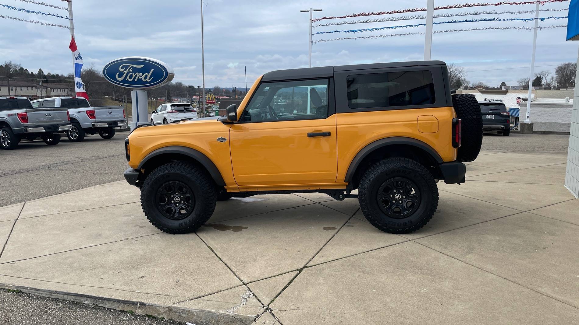

Can you take a picture on level ground from the side? Here is mine at the dealership just before I pick it up. It’s a 22 WT.
Ford Bronco Bronco Wildtrak Stance (Front End) IMG_6236

Yes, I will try and get one today. My driveway is sloped so need to go to a flat surface. PS yours looks good.

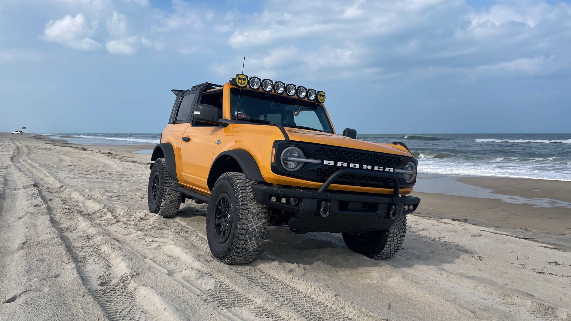

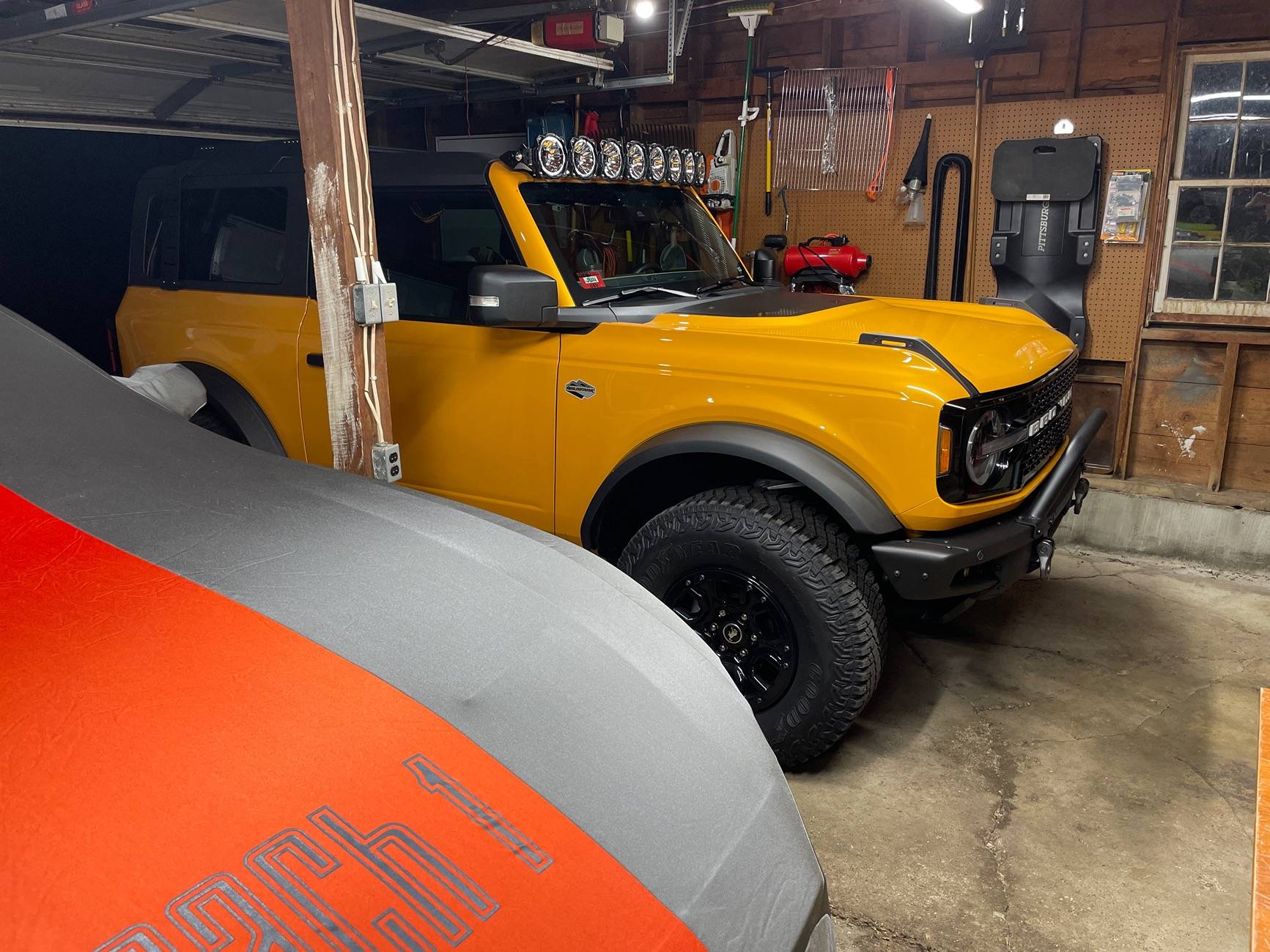

I actually lifted my front in a bit with a level kit after purchase.

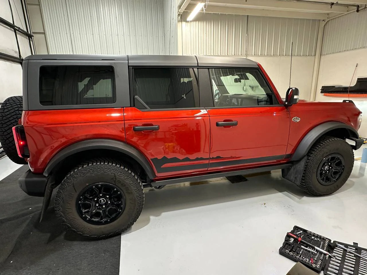

Someone correct me if I'm mistaken but, it could be an illusion due fender flare heights:
The front fender flare is 1" taller than the rear fender flare when compared to the longitudinal axis of the bronco. You can verify this by measuring from the top of the fender flares to the body contour line that runs lengthwise across the doors and above the door handles. So, for example, if you measured from the ground to the top of the rear fender flare and got 39", and measured from the ground to the top of the front fender flare at got 40", your bronco's body would actually be level. It probably looks better to they eye to have a 1" rake so that the tops of the fender flares are even though (39" for both measurements in this case).
Anyway, my 4 door wildtrak w/ HOSS 3.0 like had about a 2" rake (front fender flares 1" closer to the ground than the rear) from the factory which ballooned to about 3" of rake when I started putting accessories on the front end (winch, lights).
For you I would put a few thousand miles on the truck and see how the springs break in before doing anything. You could consider a triple fog light kit that would add 30-40 lbs to the front bumper which would probably lower the front 1/4" or so after all the mounting plates, wires, etc. Maybe some steel bashplates if it doesn't have them. Throw some hard shackles on the recovery points. Maybe a winch mount and winch if you really want to go crazy. Based on my expereince that'll sag the front end by a solid .5-1".
Stock:
Ford Bronco Bronco Wildtrak Stance (Front End) brake1

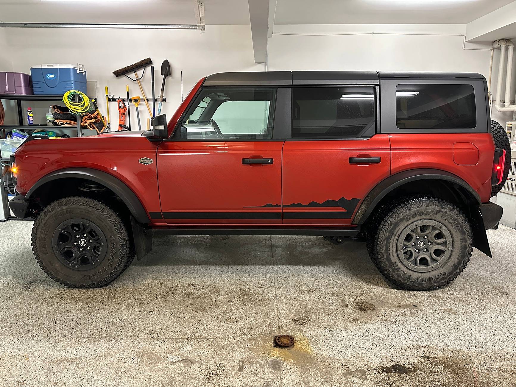

After Winch and lights
Ford Bronco Bronco Wildtrak Stance (Front End) IMG_3859

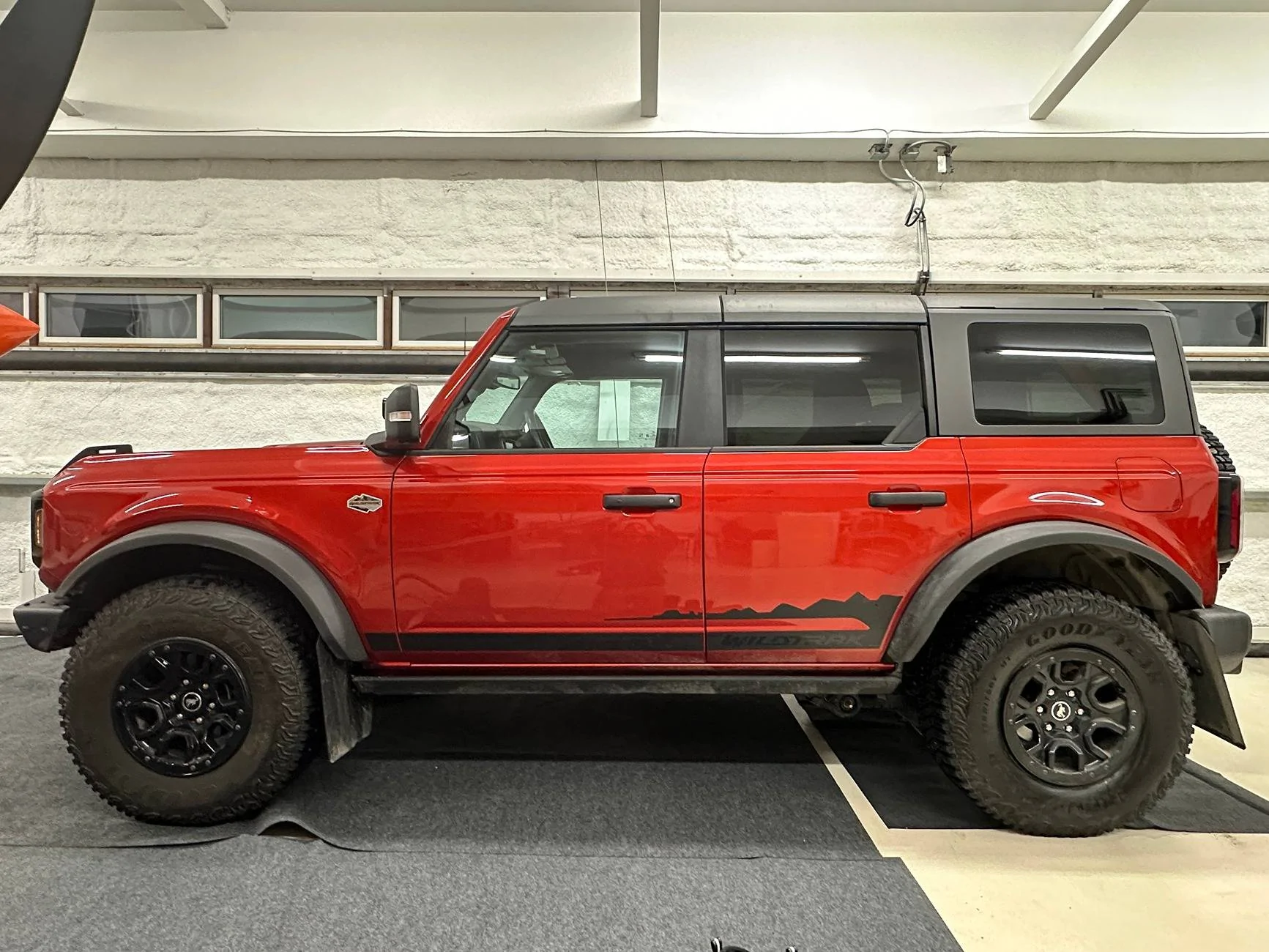

Added front lift springs to correct for front sag:
Ford Bronco Bronco Wildtrak Stance (Front End) IMG_3884
