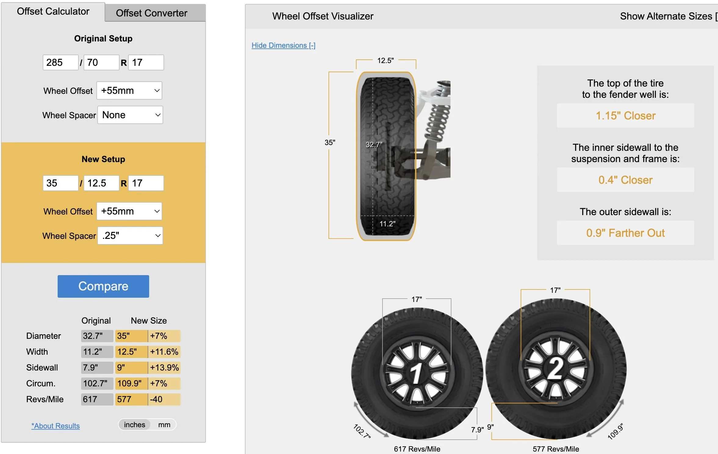

Here’s a screen shot of a comparison between what I have and what I’m thinking of doing.

Not possible within your parameters.
Speaking from experience. A 0.5" wheel spacer is 1) not enough, 2) not smart (we'll get back to that) and 3) probably not even made for this application (refer to #2)
A 35×12.5" tire is too big to fit within your parameters of having zero "poke". It's over 1" wider and adds over 1" to the radius of the stock tire. You WILL rub on the upper control arm with no "spacer".
Back to spacers. There is way too much rotational mass in a 35" tire for a 1/2" spacer to support. What you actually need is called an "adapter". A spacer just sits between the wheel and the hub and is clamped in by your lugnuts on the OEM studs through the wheel. An adapter is bolted to the hub and then the wheel bolts to the adapter. Typical minimum width on an adapter is 1".
Your only real option for little or no poke is going to be a 35×10.5, but you also mentioned not having limited travel, a 35" tire without at least a leveling kit will probably be limited by the fender... You don't want to shove a tire into your fender.
Again, speaking from experience. I have a non-sasquatch Badlands that I put 315/70r17s on, so just about, but not as big as a 35×12.5. I have a 1" level and 1.5" adapters. I ran it without adapters for a couple weeks and already had about 1/2" of "poke" and rubbed on the upper control arms before full steering lock. With the adapters I'm around 2" of poke. A 1" adapter would be sufficient to run the tires but you will still have the poke that you don't want.
Also, it's good to note that the stock sasquatch tires are 315/70r17s and not true 35"s, and the difference in offset from the stock badlands and the sasquatch wheels is around 1". So a minimum of 1" of spacing is a good rule to go by.

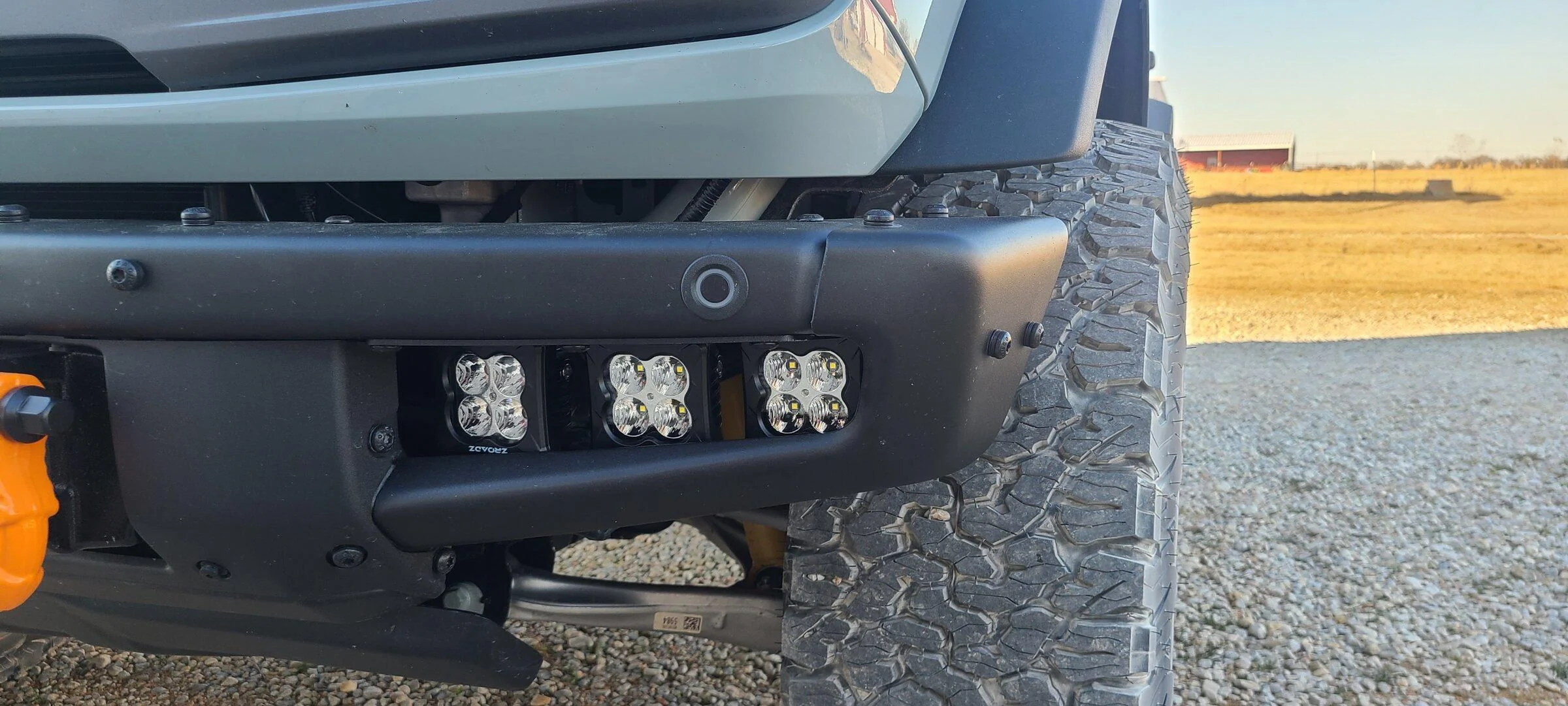

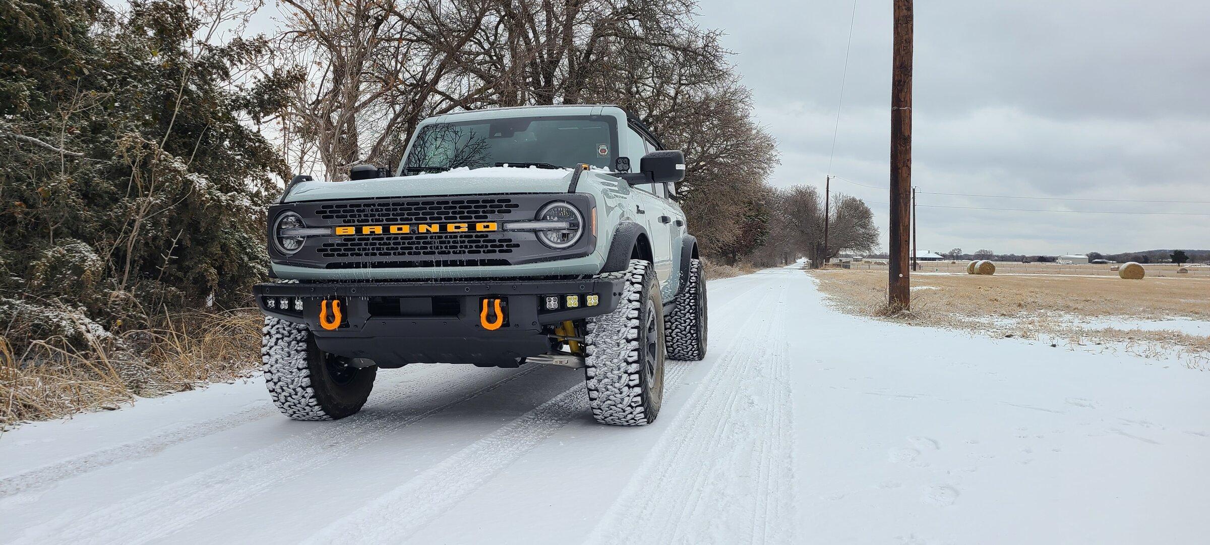

I was looking to limit poke as well. I went with a 35 x 10.5 on the stock BL wheels and have no issues rubbing at full lock/full stuff. Crash bars removed of course.
