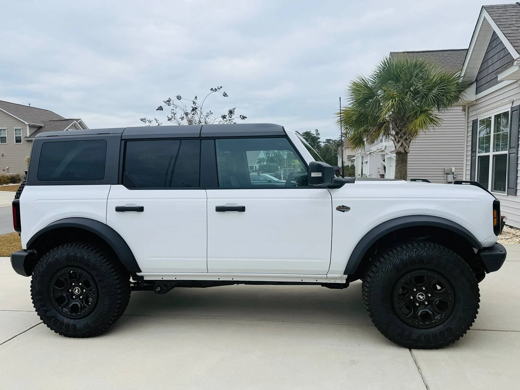

LSW I think you’re right but it appears to be higher in front almost like the front tires bigger. PS this isn’t a level surface.

I’d park it level then use a tape measure from the ground to the top center of all the fender flares. Most people are pretty happy if all the fender flares are equal in height, which is still a slight rake. I think that’s about what you’re at and it looks good to me. You could always consider lifting the rear with perch collars if you want more rake.

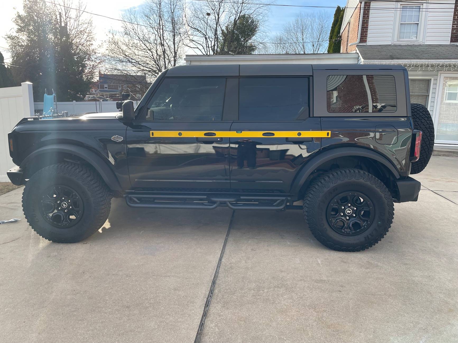

Mine does as well. It was about 1/2 in higher in front than rear.

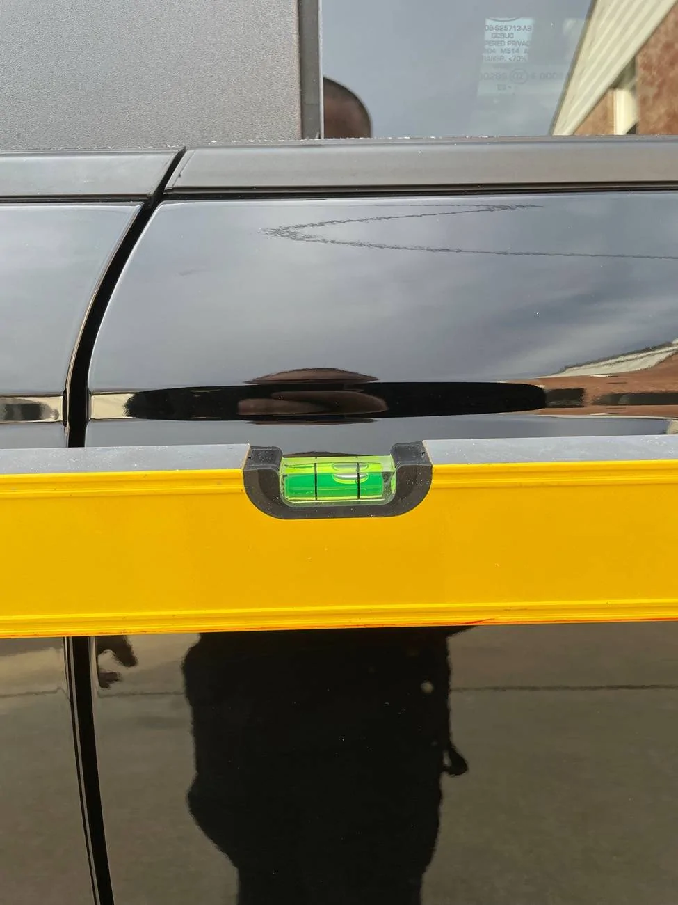

I put a 6ft level on the door handles and the front is lower than the rear in terms of being level, I also measured from the ground to the bottom of the flare. Front 39“ Rear 39 1/2”. These measurements are after a 3/4“ body lift. Mine is a optical illusion as the rear looks lower to me.

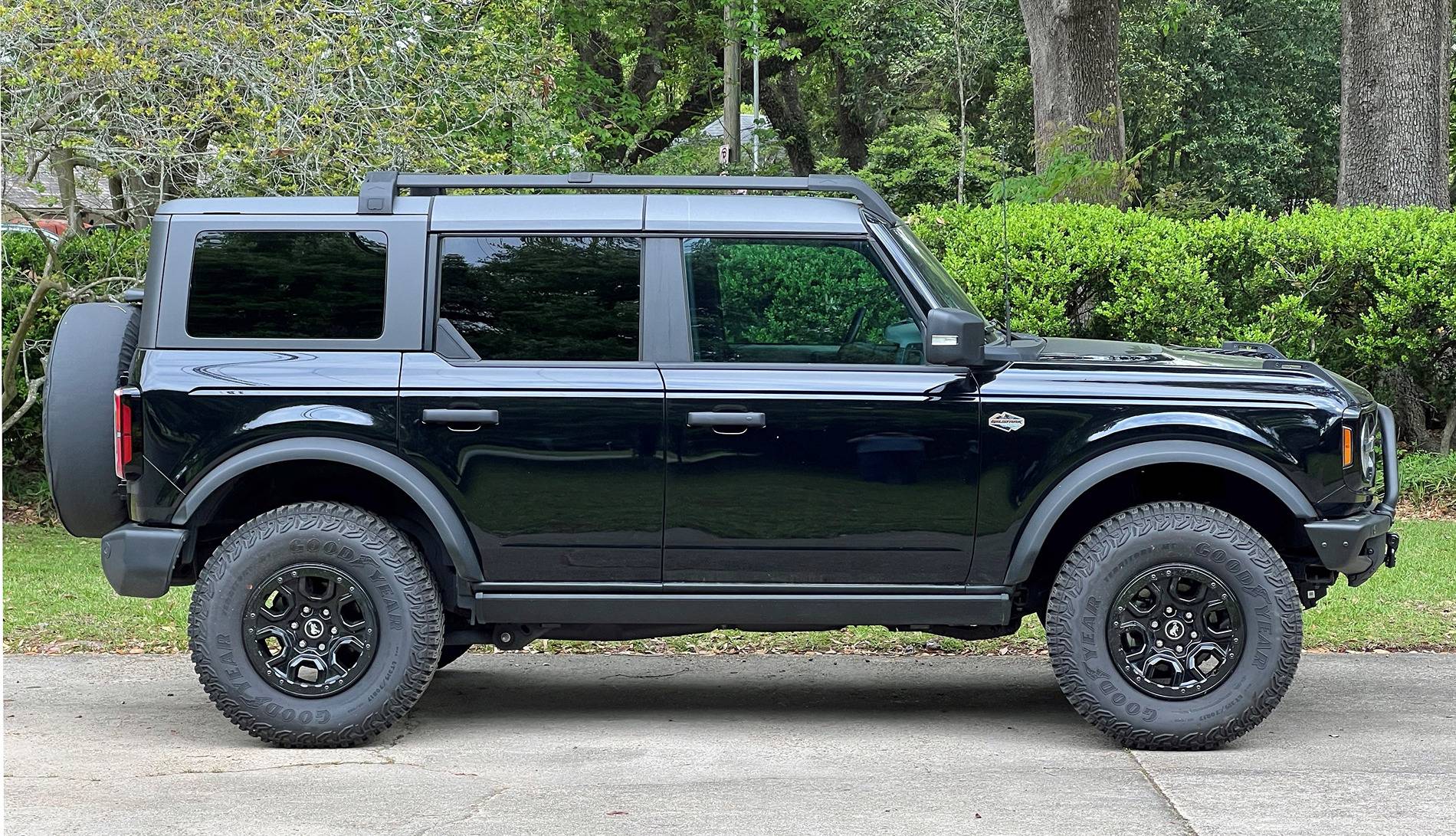

My 2023 Wildtrak sat very high in the rear with the trailer towing package. Here it is with a 1.5" RPG collar and one spacer shim (.2" thick) on top of the strut mount. This combination lifted the front a little over an inch from it's original ride height. Rear is unaltered.
